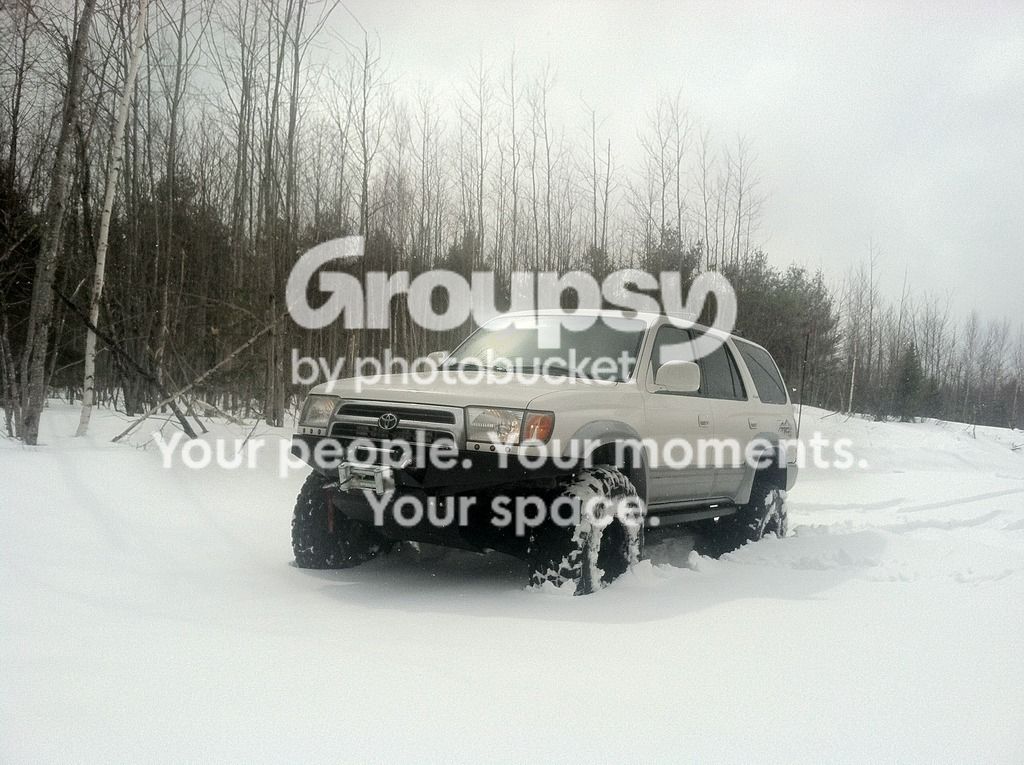

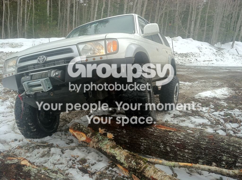

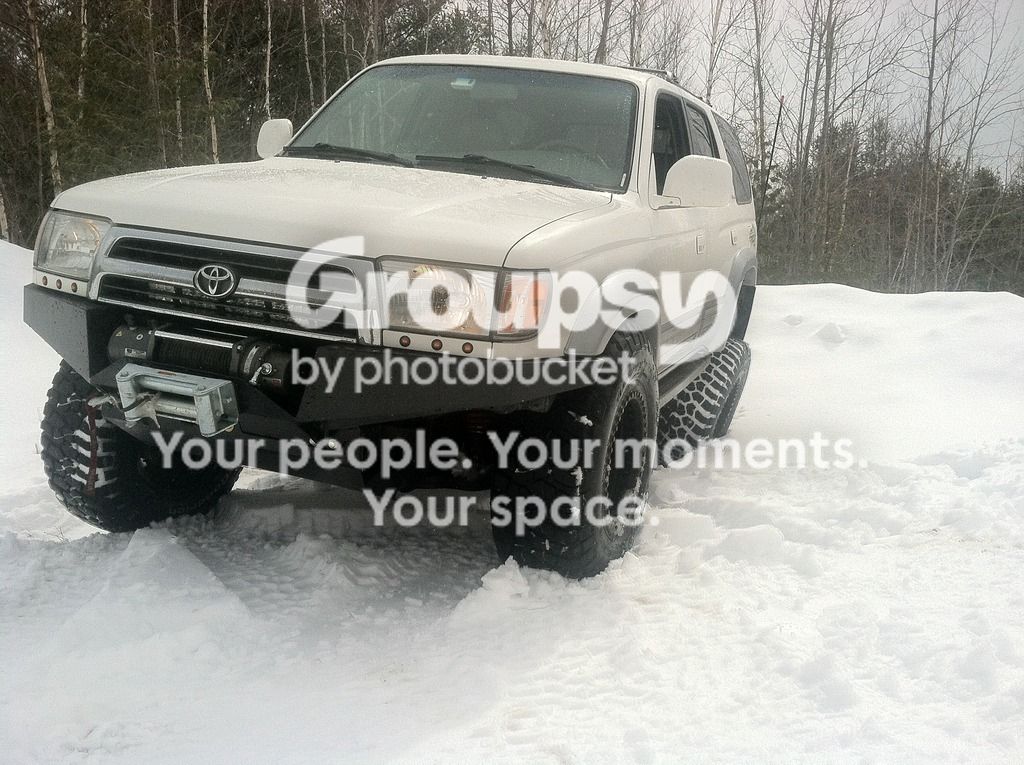

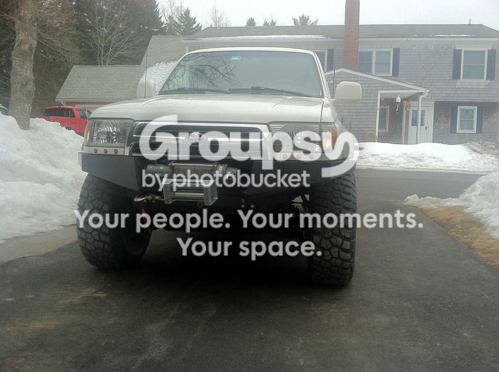

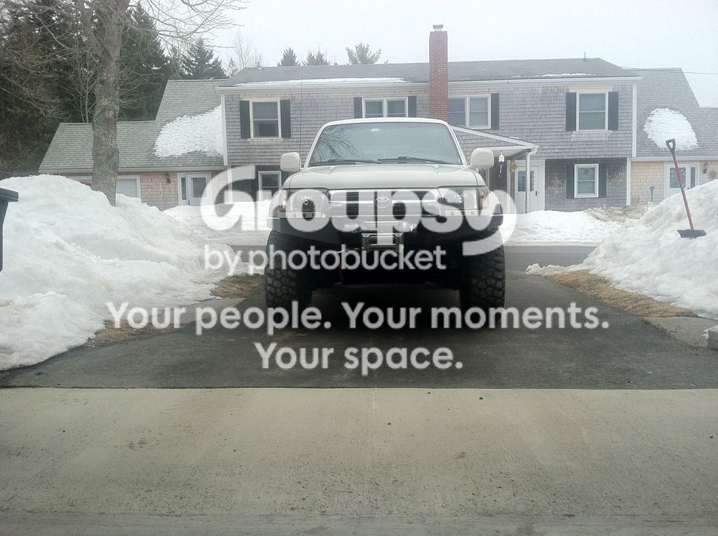

Anyway here's some slightly better cell phone pics of the truck, bumper and winch setup.
D87AFC38-FAB3-4BF0-BE1D-3E3D8590C7A0.jpg~original
5FE55D3F-FBFC-4092-82C6-BAB4E68B8A7A.jpg~original
4601914D-F71F-415A-95D4-391567C78291.jpg~original
37B40C54-BD29-47E5-A698-15AEC5F3DF9D.jpg~original

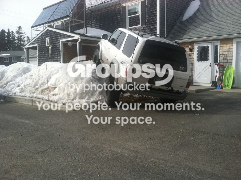

I cranked up the front up an inch but it still looks saggy. Either I've got to crank some more or add weight to the rear.

Also installed a deep cycle marine battery. Should help with the longer winch pulls. Then installed a start solenoid on the hot side of the winch. Planned on wiring it to a switch inside the cab but couldn't lockate my switches. Just rigged it for now.

First off, nice rig. What type of solenoid did you use? When I did mine I used a Motorcraft starter solenoid and found out the hard way when it started blowing fuses that it was not rated for continuous duty and would melt the coil.
That's good to know, I'm not sure if it's rated for continues duty. It's the standard can style like the old warn winches used.

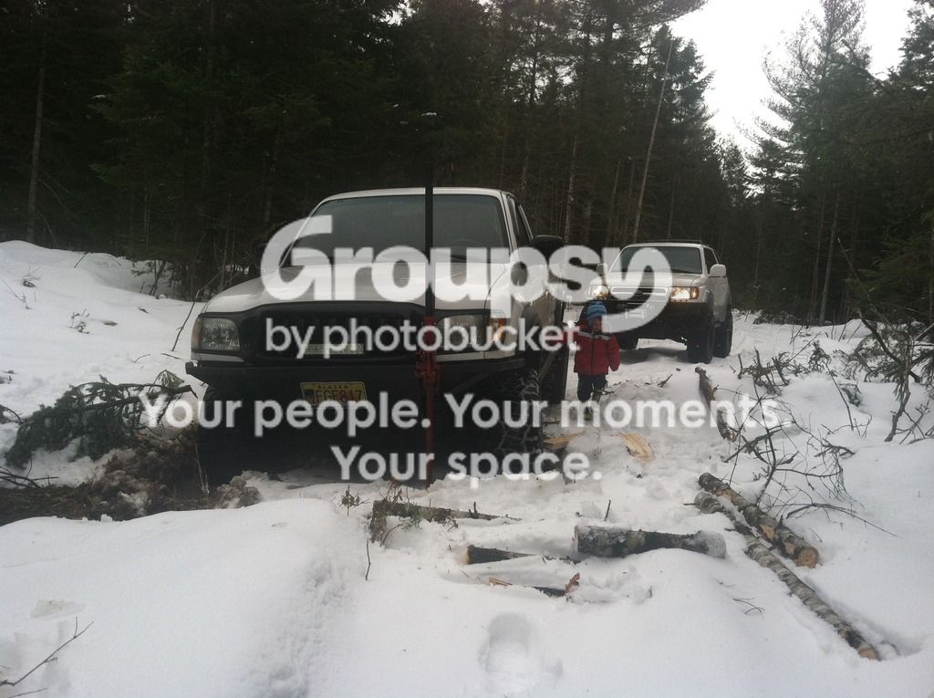

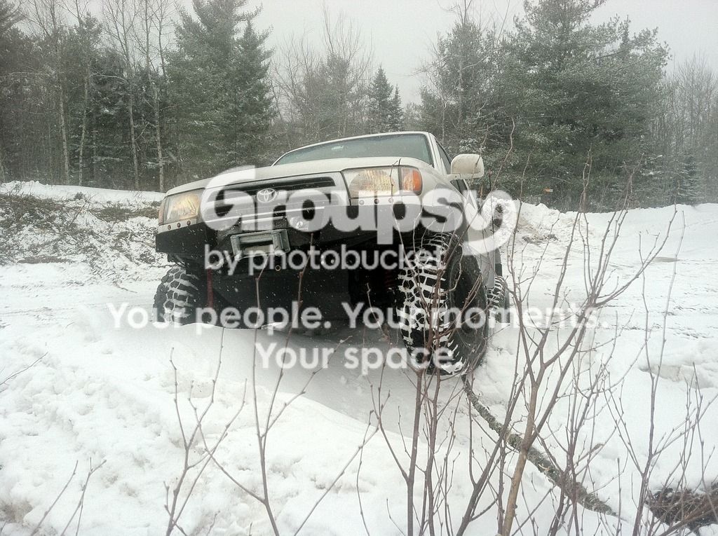

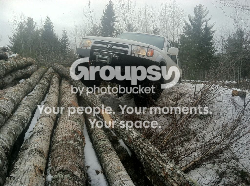

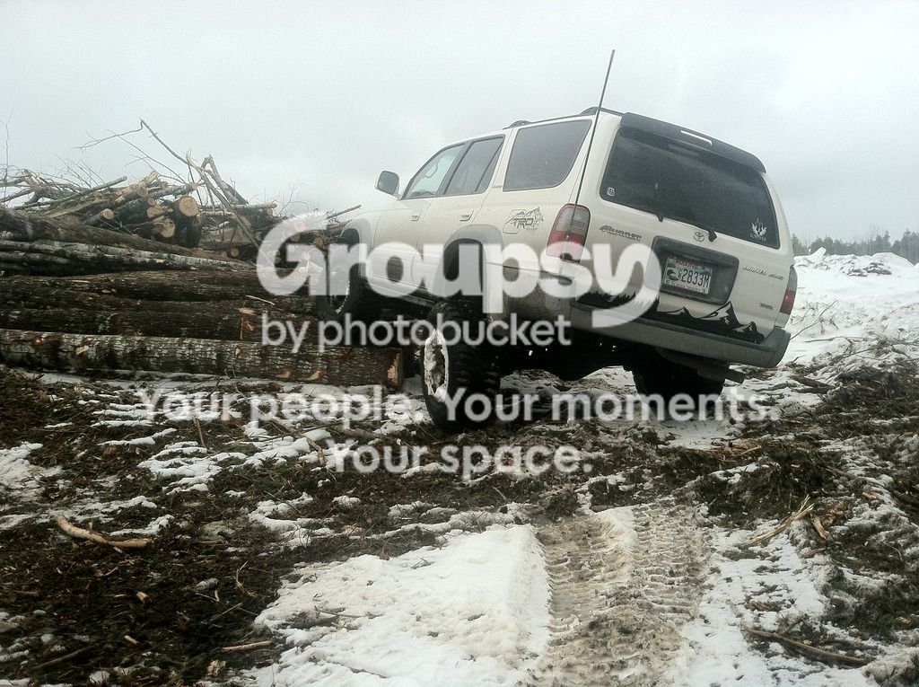

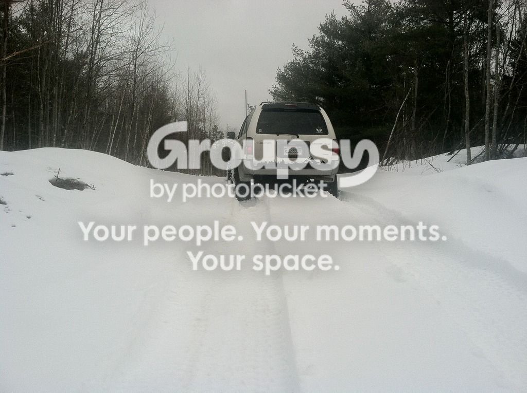

Lots of fun was had today. Snowing and snow wheeling.
24F5F547-6695-44D4-A370-5C39B483EC9C.jpg~original
BCB9CD9B-34C1-4F82-B367-66A101724E30.jpg~original
3B6DBD61-91BB-4100-9060-13B610122E7D.jpg~original

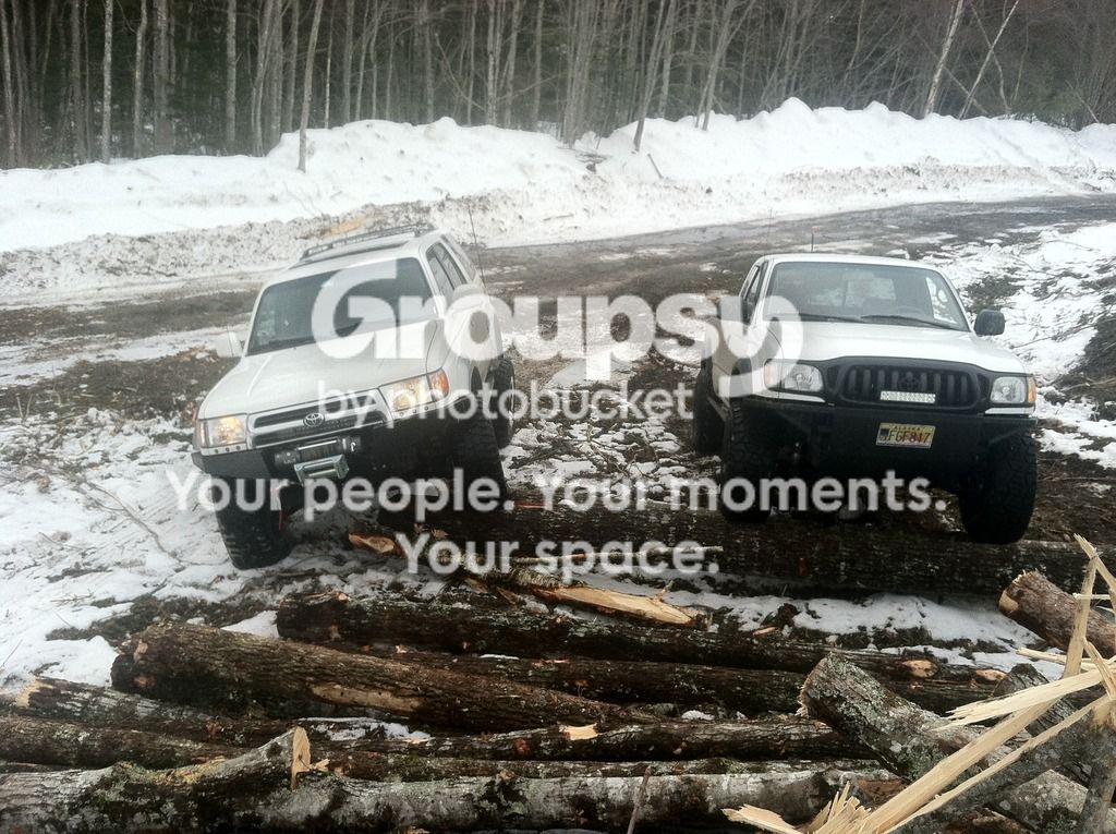

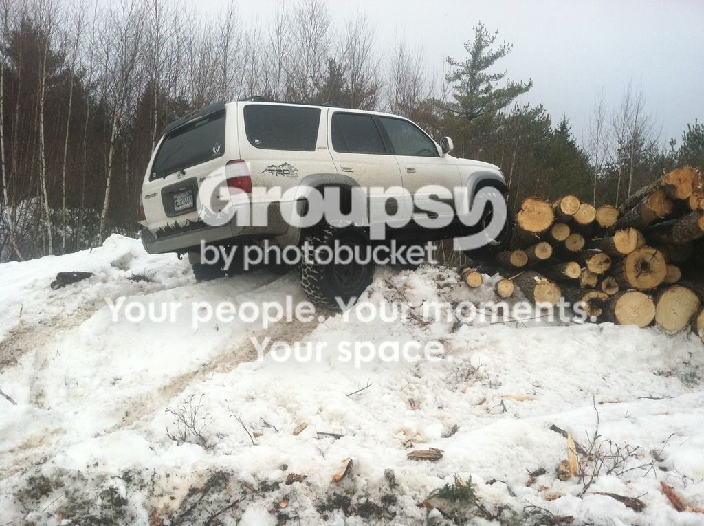

Finally able to really flex the front end.

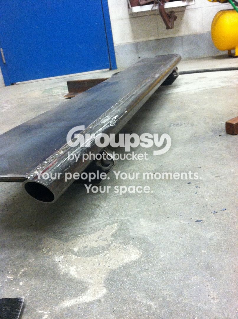

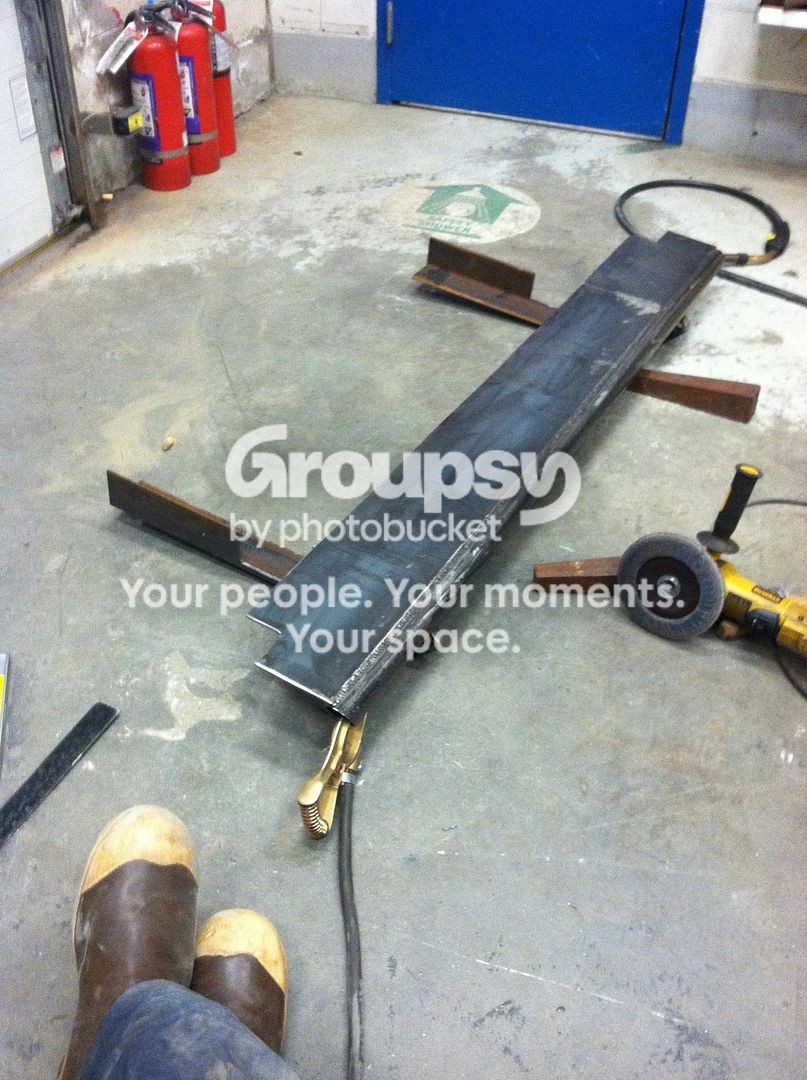

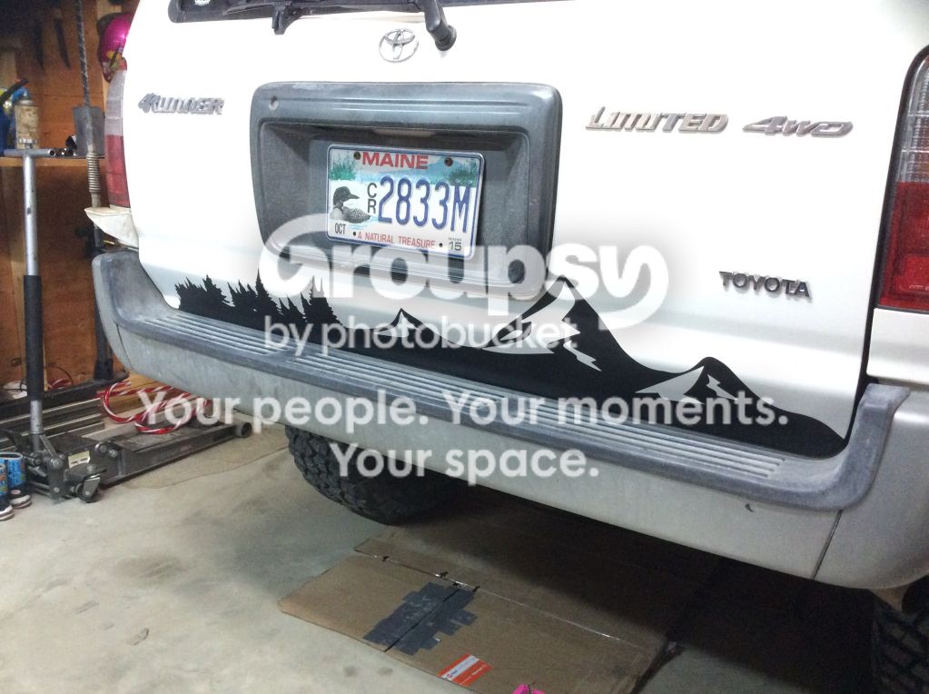

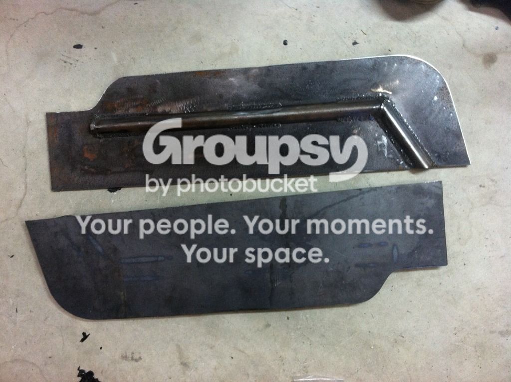

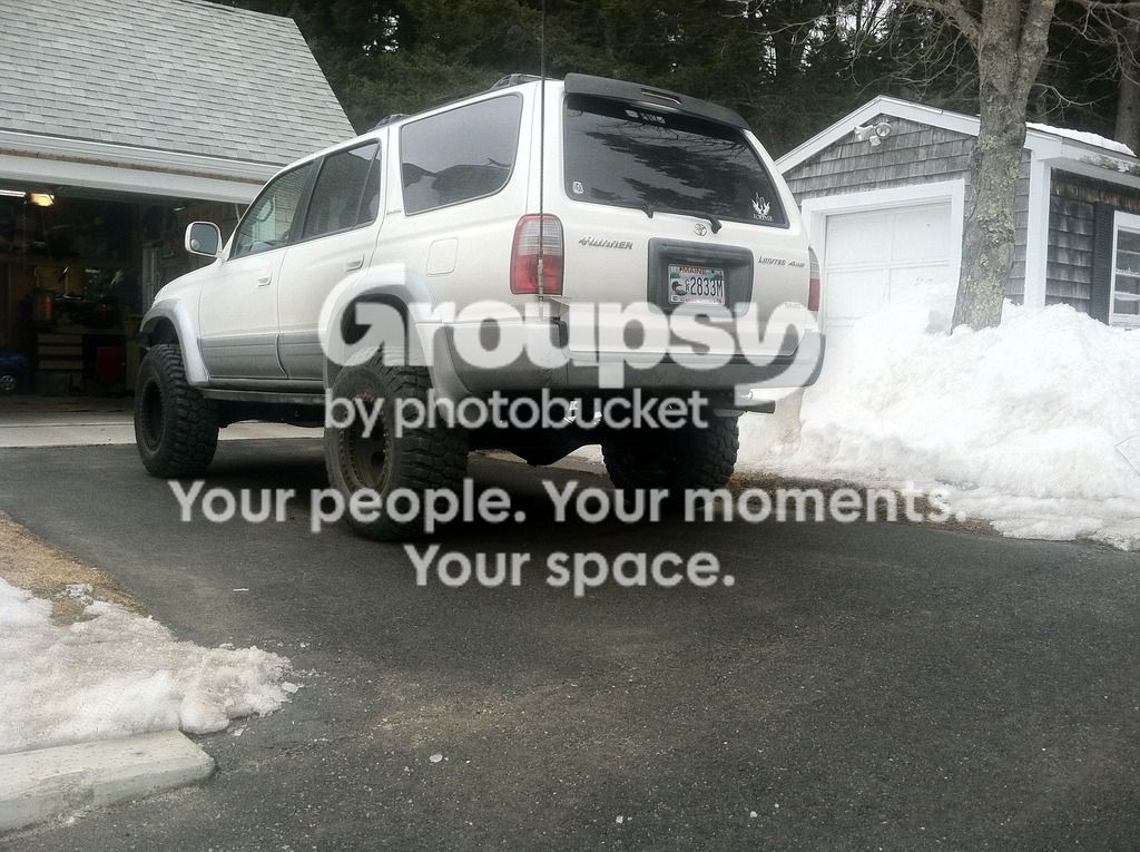

That's a good start on the rear bumper. Just a little advice:
The bumper looks pretty close to the bottom edge of the hatch. You might want to increase the spacing a little. The rear flexes a lot between the frame and body, and the bumper might hit the hatch.
Good to know, I've got 1/2 in between the hatch and bumper. I guess we will find out if that's enough. I still need to add the hitch, bracing for that, plus Swingout and side protection.

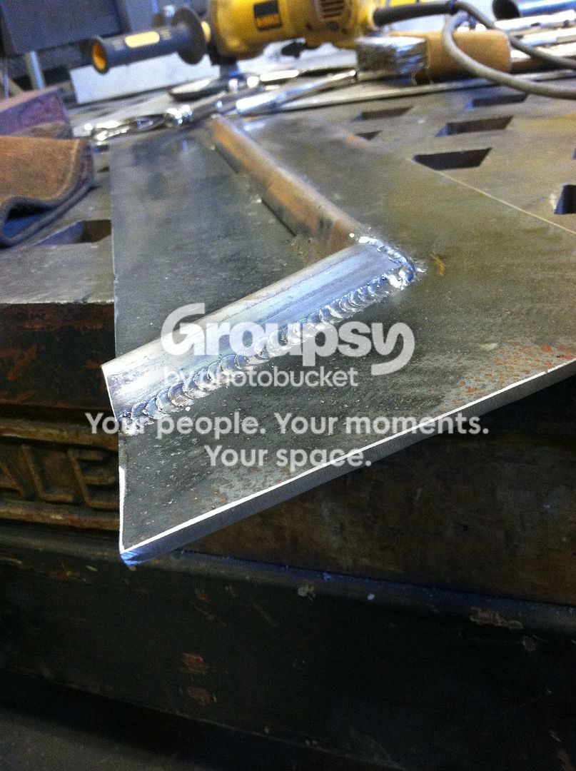

So I picked up some more steel today, just about 120 for 10ft of 2" square and 48x36 piece of hot roll 3/16 plate. And 75 ish for 3/4" expanded mesh 9ga steel 48x60 and 10' of 2" 1/8" strip for the beginings of roof rack build.

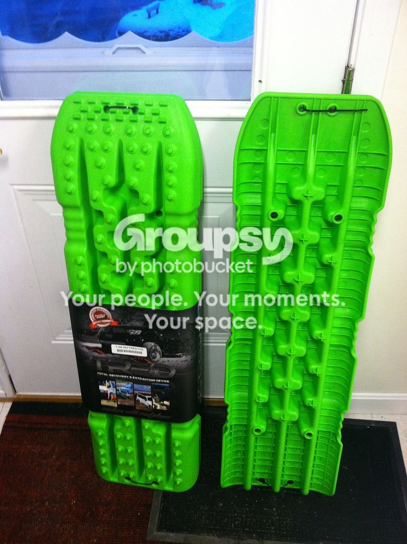

These arrived today
EBay from summit? I gotta buy a set or two before they sell out...
Edit: G damnit looks like I missed out already! I knew I should have pulled the trigger right away!
Summit direct, I watched them for a while. Yellow sold out, blue sold out then only green left so I pulled the trigger. 211 shipped for both sets couldn't say no.
