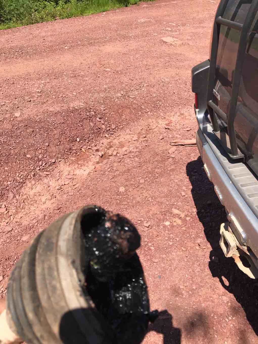

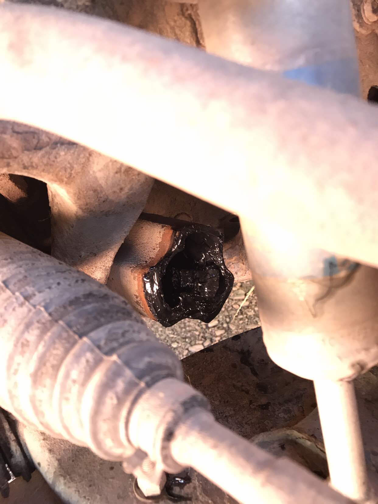

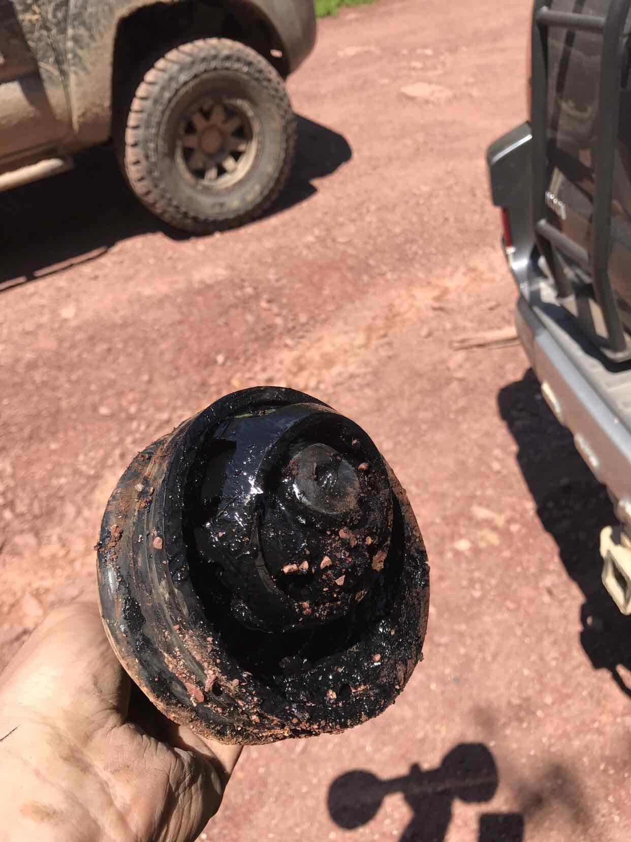

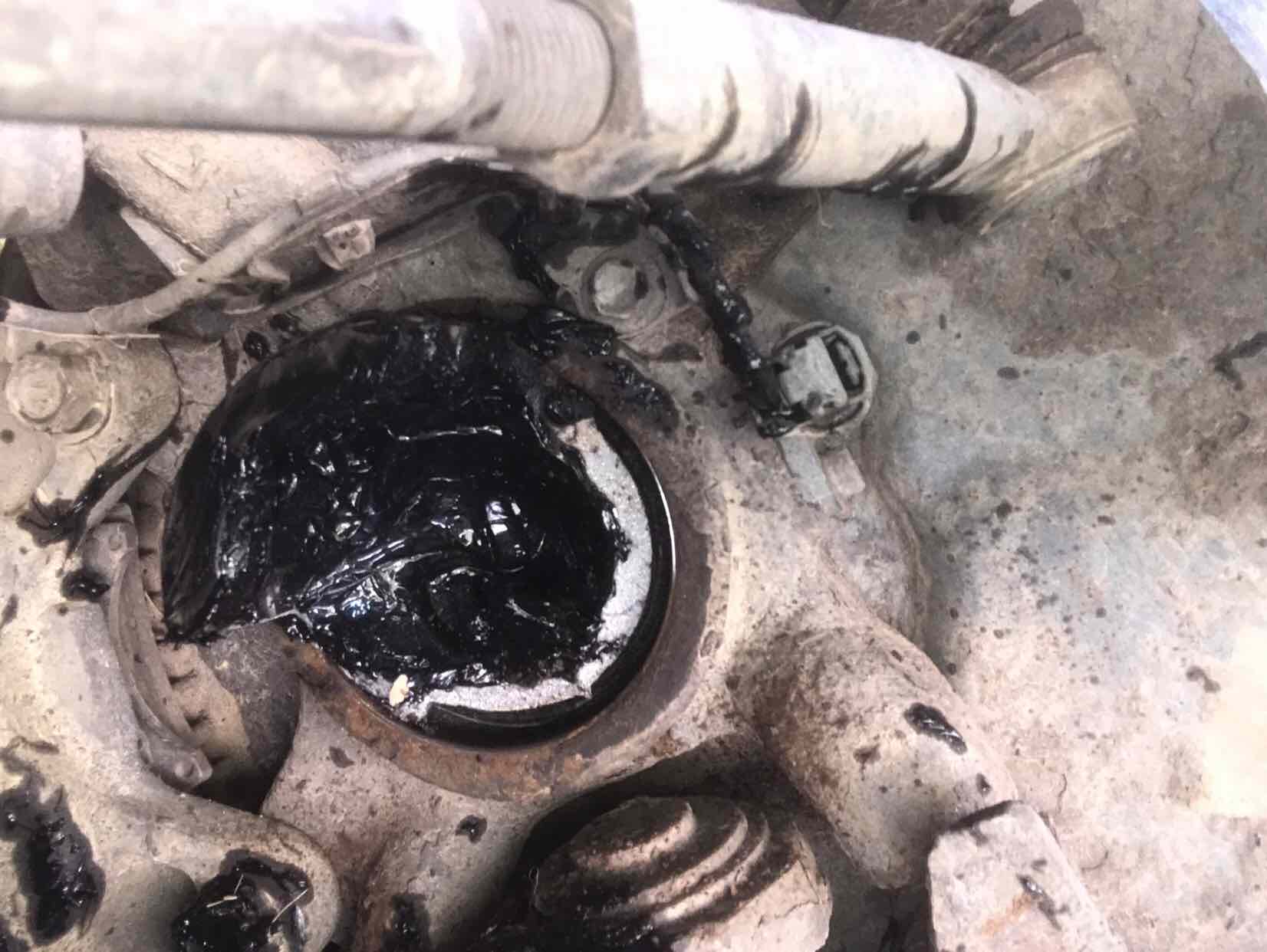

Out wheeling yesterday, the 'cup' of the driver's cv that secured to the hub exploded and I ended up with the middle of the driver's front axle on the trail below my truck. AAA brought me home though [emoji106]
I had 4Lo engaged and the center diff locked. After switching to 4Hi and unlocking the center diff, the truck acted as if I was still in neutral after engaging Drive or Reverse. I re-engaged 4Lo and the center diff and the truck was able to move under its own power. However, about every 1 wheel revolution or so, there was a distinctive clunk.
I'm hoping I just need to throw in a new axle but I don't think I will be that lucky. My mechanic is taking a look at it tomorrow
This is normal operation.
However the periodic clunk/shudder you mentioned sounds suspiciously like a busted ring and/or pinion in the differential.
I wish you luck.

Thanks for the info. I kind of figured it just wasn't happy with only 3 functioning axles in place.
As for the ring and pinion, I've sourced an 'A' quality complete front axle assembly (both axles and complete front diff) for $250 before shipping.
My only question is, should I just swap out a new ring & pinion, if that's what's making the noise or the entire diff. I'm trying to keep the repair costs to a minimum.

If you just bought the gears, you would have to set them up yourself or have someone do it, who might still screw it up. I'd look into ECGS, or buy a similar used full front differential to swap over to from Ebay or a local salvage source.
