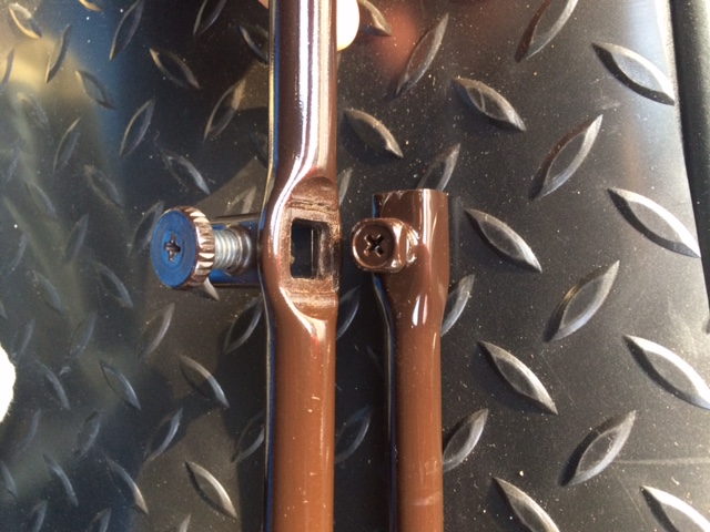

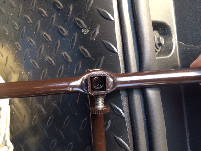

Thank you for posting the PSA and as others have mentioned I too agree with a little practice in the home garage so that one gets familiar with what they have to work with.
It is a good idea to carry some basic tools as well but just in case someone doesn't and is trying to get the crank rod assembled for the first time this can be done without tools. The "L" shaped handle that will become the crank has a square peg that will fit over the screw-bolt on the legs of the stem to tighten and loosen them. Maybe the thumb-style screw might need extra force or a screw-driver but for the most part the tools in the tire changing kit should work well enough on their own without additional tools. At least that was the case with my 2004 SR5 and the newer 2015 I have.
I have included some pictures to aid. Or maybe I got the wrong interpretation of this but hopefully the pictures help.
This! These parts have basically been unchanged on all Toyota's that I have had. This is what I have always done. Necessity is the mother of invention.
