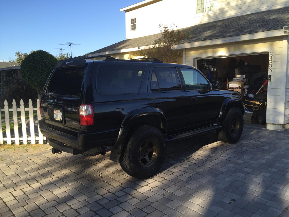

I love my 3rd gen and the body style (the exterior and interior looks like it only has 30k miles lol)
I sold my 5.7 v8 2008 tundra, and down sized to the 3rd gen so I can save for a house. The power on the truck was amazing and it makes the 3rd gen seem so weak lol. I really like the look of the 5th gen but sad it doesn't come in a v8. I've been keeping my eyes out for a 4th gen 4wd v8
See how purty she is :wave:
