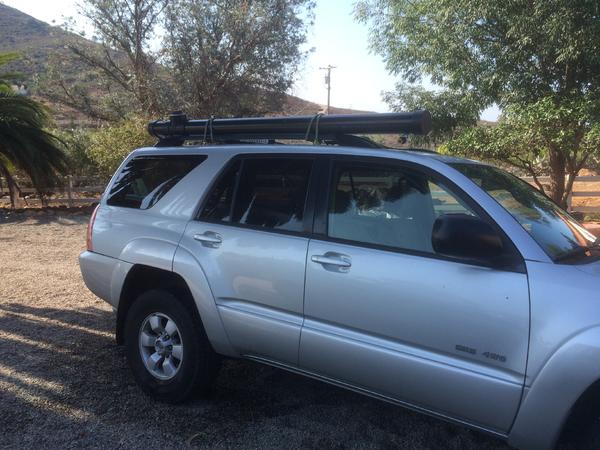

I made my own "Road Shower" from 4" black pvc pipe. It heats up incredibly warm on sunny days. Just gotta suck it up when it's cloudy. Works great after camping, surfing, for dishes or the pooch!
Holds 4 gallons.
Quick-disconnects for the hose.
Valve for pressurizing with small 12v compressor.
<$170 for all parts (including compressor) see the attached zip folder with BOM with links to all parts
You will need some taps for the threaded fittings ("borrowed" from work :) )
For the labor, well worth it instead of paying $300. So many people compliment it!
Once I get home from work, I'll post up some pictures of it. You can sort of see it in some of my pics now.
Some pics of the roof shower. The fill cap on top has been modified for a proper seal using silicon sheeting inside of a white pvc female cap. It holds really secure on the stock rack with just 4 EPDM bungees. Never rattles and no wind noise.
