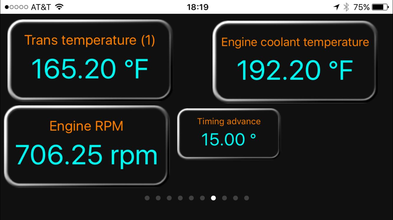

So to expand on this I have an iPhone and I could not find anywhere where how to get the pid to work with the iPhone on the '04. I tried all the already mentioned solutions using 21d9 which revealed no data. Using enginelink, After opening the "add dial" while the engine was running I saw that the icons turned green and started producing data. I didn't have to download anything other than the standard $5 app.
My solution was:
App: enginelink
Engine Link -OBD II vehicle monitoring & diagnosis by K SOLUTION LLC
https://appsto.re/us/kjNqJ.i
Obd2: veepeak wifi/bt for iPhone
Enginelink's native transmission temp pid actually works and looks to be the pan temp.
I just did tested the trans temp sensor mode and the a/t light came on at 96.80 - which is supposed to come on at 97. So kinda verified?
It's using:
pid 01B4
Formula: (a-40)*9/5+32
I have not tested this to see if it will work transferring the info to torque but I'm very happy nonetheless that it's working.
If anyone else has anything to add, feel free.
