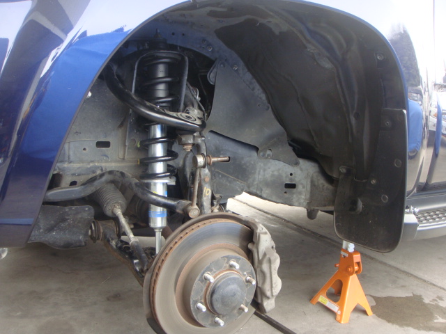

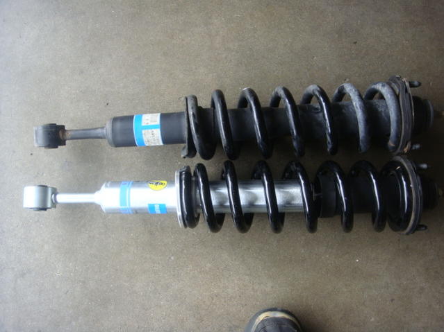

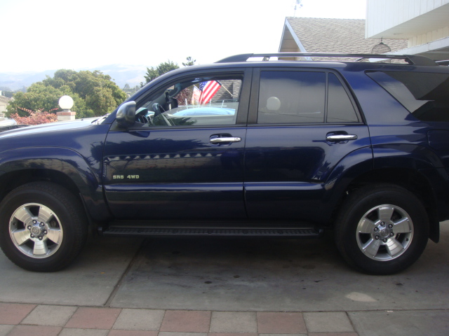

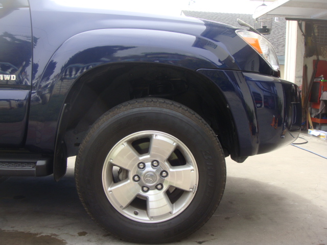

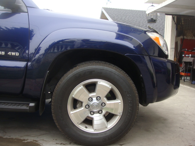

Finally my 1st my ever mod is done. Bilstein 5100 shocks and FJ springs gives 1.75 lift front .85 settings and stocks spring and bilstein rear gives .25 lift to level front and rear.And thanks to all of your suggestion and support guys for making my 1st mod. And i think i need some tire suggestion what brand to consider i like 265/70/17 all terrain + spidertax also, im mostly daily driver so im open for more inputs or some suggestion. Tnx also to my friend fredo Y.

Rig looks good man! I just did the same lift also about 2 months ago and LOVE it! I ended up getting a bit more out of it. Same front setting, right after it was about 2 3/8 up front. It has settled to 2 1/8, I couldn't be happier. It kinda funny the differences from truck to truck with the same equipment installed. I guess I should ask, V6 or V8? Next on the list is tires.
Yap im happy with it , it looks more agressive now the nxt project is the tires w/c im considering A/T Brigdestone revo , BFGoodrich and also some suggestions and i heard that BFG has rubbing issues size 265/70/17 w/c i plan to upgrade. I have a V6 engine to answer ur question so Goodluck on your nxt mod.
