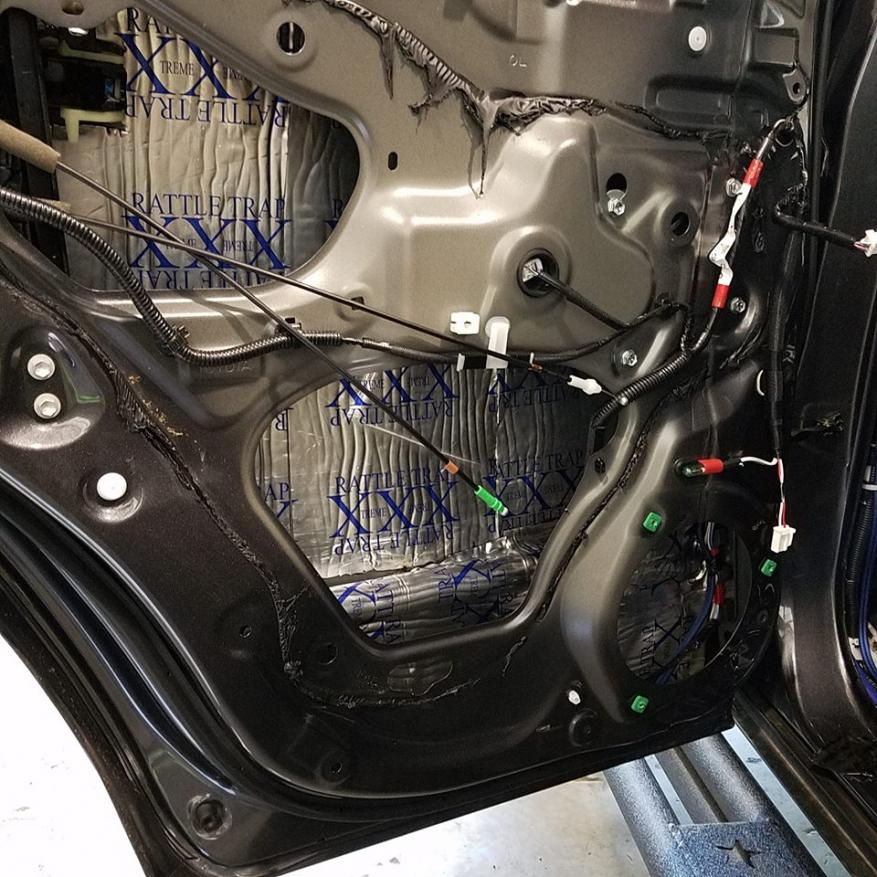

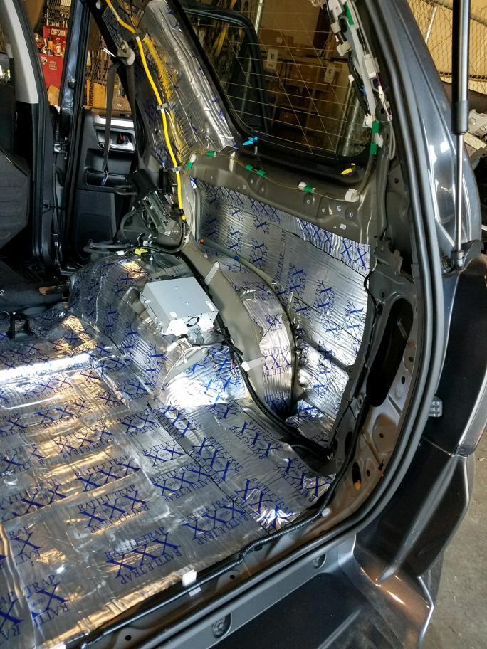

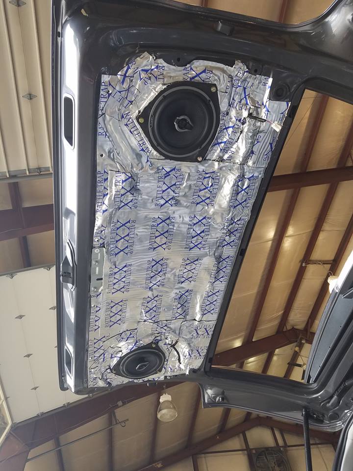

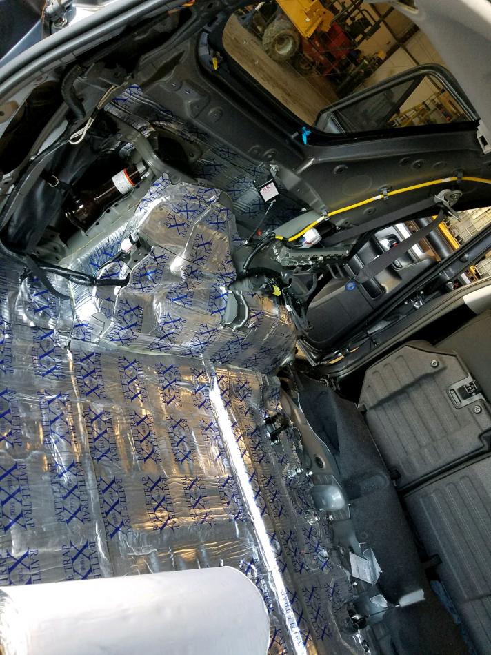

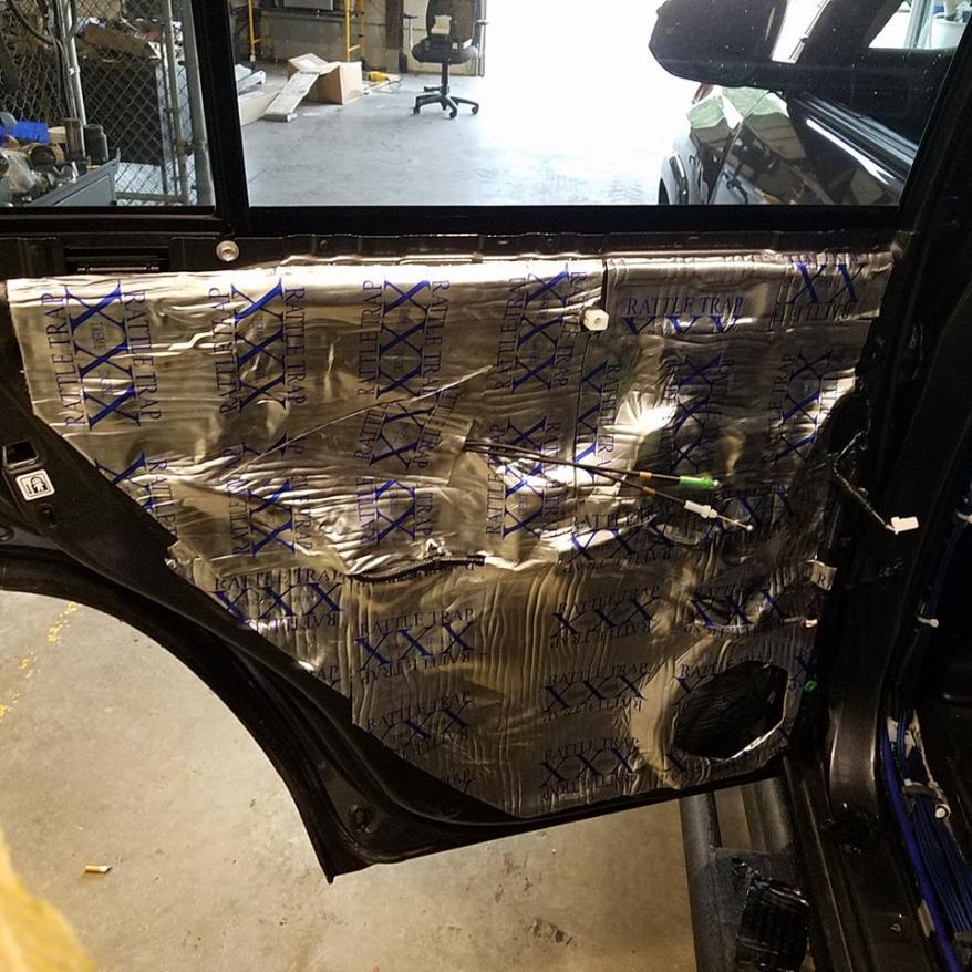

Did more than the doors. Everything other than the roof, rear footwell, and front footwell, are covered inside and out. The rest will be done soon.

Just add a decently large piece of noico on the outer panel. It will give you that satisfactory door close whoomf. :)

Did you have to upgrade your rear hatch gas shocks to hold up the extra weight ? I deadened everything other than the inside door skins, and with the Toyota Focal speakers the stock gas shocks for my rear hatch barely lifts the hatch fully open. I used Stinger Roadkill, maybe there's a weight difference in the material used. I think a case of 36sq ft weighs about 30lbs, I used 3 cases to do the entire truck

I have also added a panel of Noico foam to the middle of the door panel. Also for sound quality - dissipates things a fair bit.
Ah yeah it was really bad lol. I have the inner skin and outer skin covered, there is a lot of added weight.
Haha, thought so. I may look into getting heavier shocks later although I do like how it is now where pulling down the hatch past a certain point will let it close on its own
Mine didn't stay up at all, had to hold it open to matter what. Stronger shocks were not an option lol
