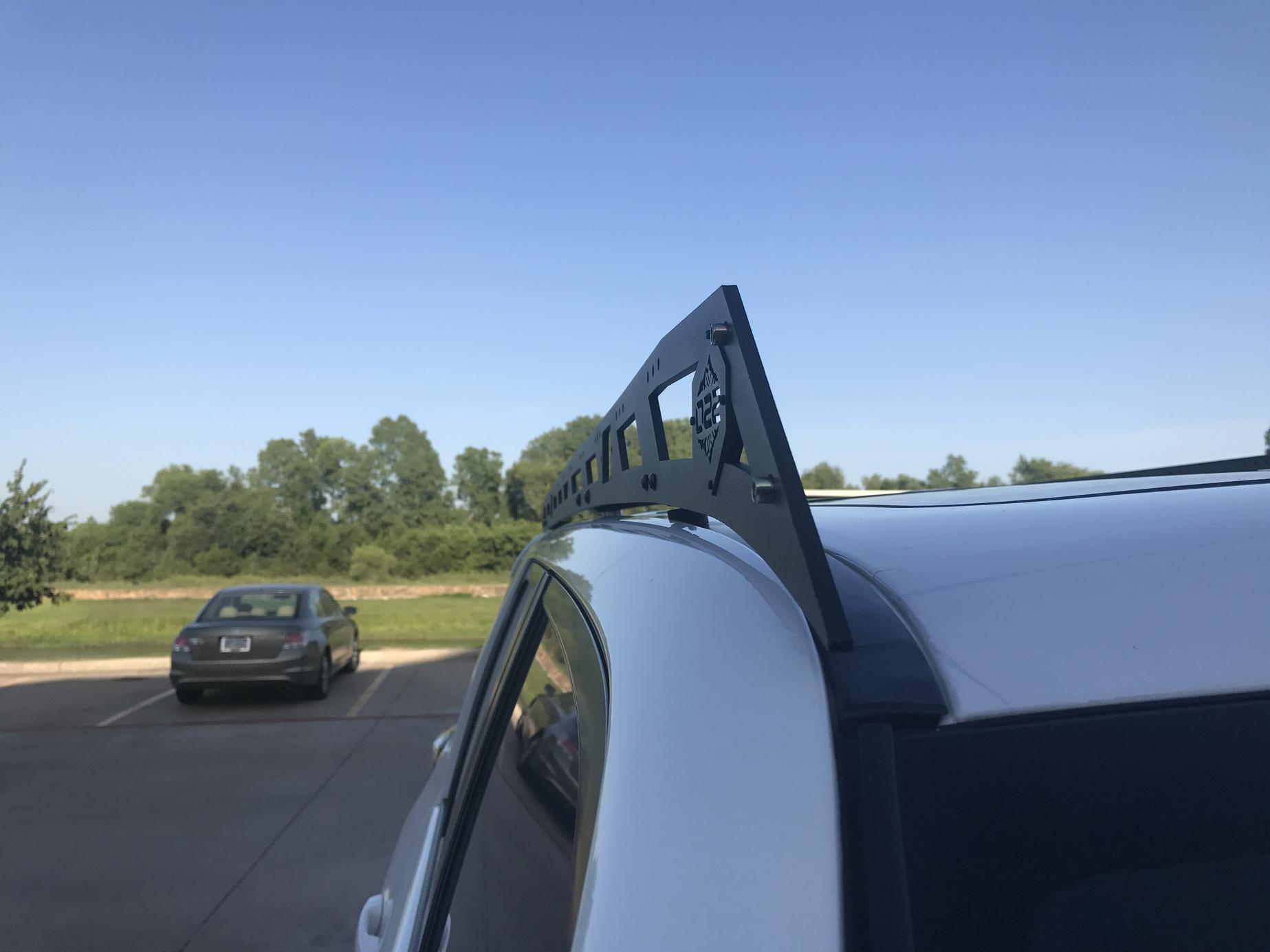

The rails are actually identical. The logo plates were incorrect on both of mine (part of the first 10 made). One was backwards (on the wrong side of the rail) and the other was cut in reverse somehow so it couldn't be used at all. I told SSO and they sent me 2 replacement logo plates and the rivets to install them. It took about 10 minutes with a 1/8" drill bit and a rivet gun. I still have both of the old ones in an envelope somewhere around here. I don't have the shark fin so I have no suggestions on how to work around that other than what you did. I also installed the 2" crossbar on the rear angle because I wanted all 3" across the top.
There's two differences actually. The logo, and more importantly the nut inserts for the wind faring only go one way
