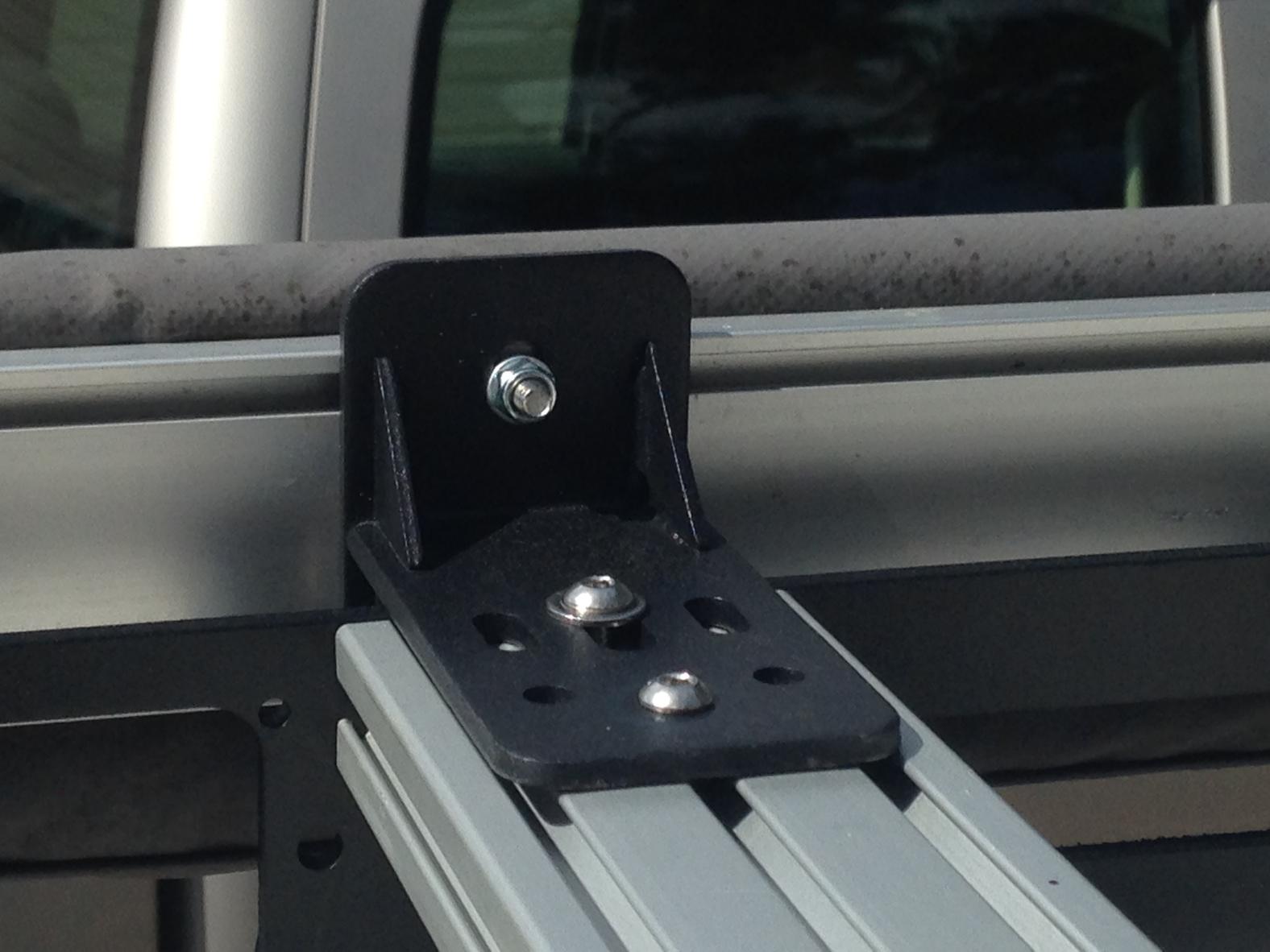

Those of you that have an SSO roof rack, curious what types of mounts you used for an awning
We used ARB universal brackets on ours. ARB part # 813402.

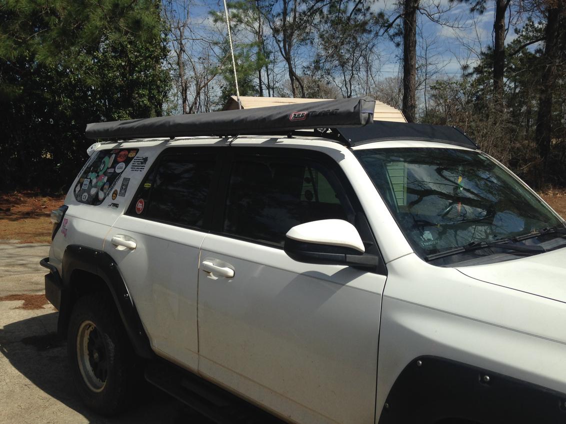

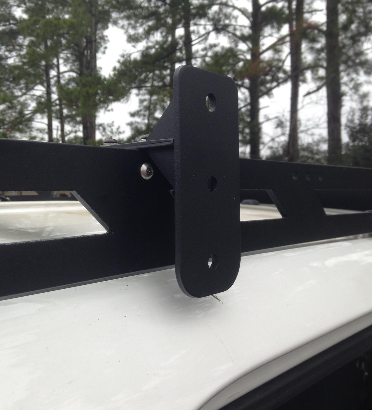

I used Rhino Rack mounts on mine. I think I paid $55 per pair, and since the ARB 2500 recommends 3 mounts I just used 2 pair. I mounted them with the long legs down to get the awning a little lower.
And I recommend you loosely mount whatever you use to the awning first and then mount it to the crossbar. On my setup it was pretty tight getting the bottom bolts started on the lower positions so I had to take it all off and go that route. Once I had everything lined up nice I tightened the upper bolts to the awning with it on the 4R, then removed it to tighten the lower ones. Then I had the wife just hold it in place until I got 1 crossbar screw started at each end. That held it well enough I could finish without her help. And yes, I'm using 80/20 hardware.

Oooh I like that better and how it sits lower. I'll have to snag a couple pair of those to do the same. Good call.

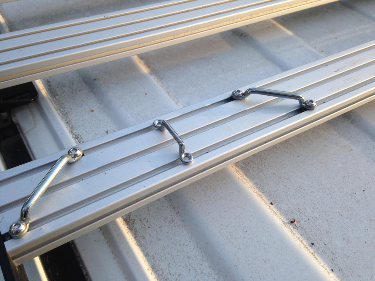

Thems the ones, but no hardware is included. The awning will have its own hardware. And slikens hardware choice is actually less expensive than mine, but I bought a pack each of these because I knew I would be adding tie downs also. You would need to remove the crossbar screws from one end, raise it a little, and slide these into the slot you will use. I actually have several floating in the slots on a few crossbars with the screws just loosely threaded in them, for when I decide to move stuff around.
https://www.amazon.com/dp/B00J39KHHU/?coliid=I2C69X5O0H9M9M&colid=234ZNJLBJ9SR3&psc=0
https://www.amazon.com/dp/B00T6PTCT...olid=234ZNJLBJ9SR3&psc=0&ref_=lv_ov_lig_dp_it
