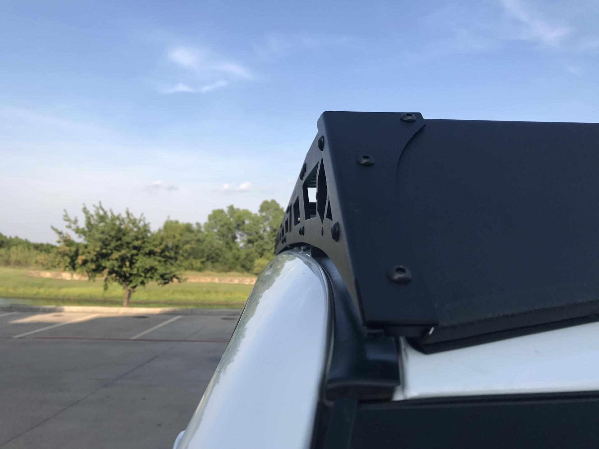

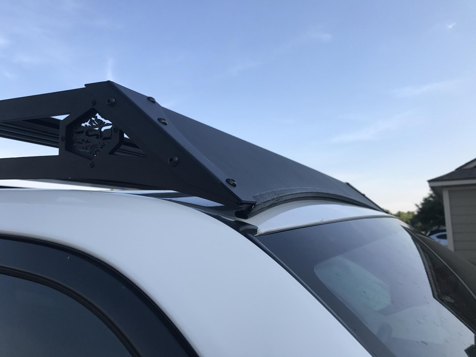

The new wind fairing with 40" led flush mount is almost ready. We're sending the final test unit to powder tomorrow. It can accommodate the 40" Heise, Rigid or Baja Designs light for sure, and probably a few others with its universal fitment ability.

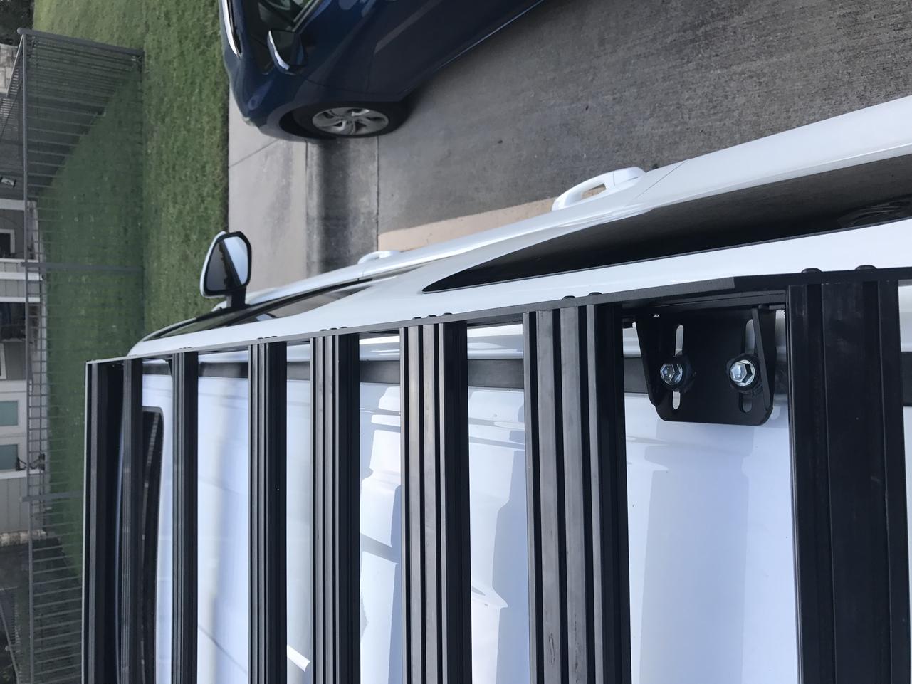

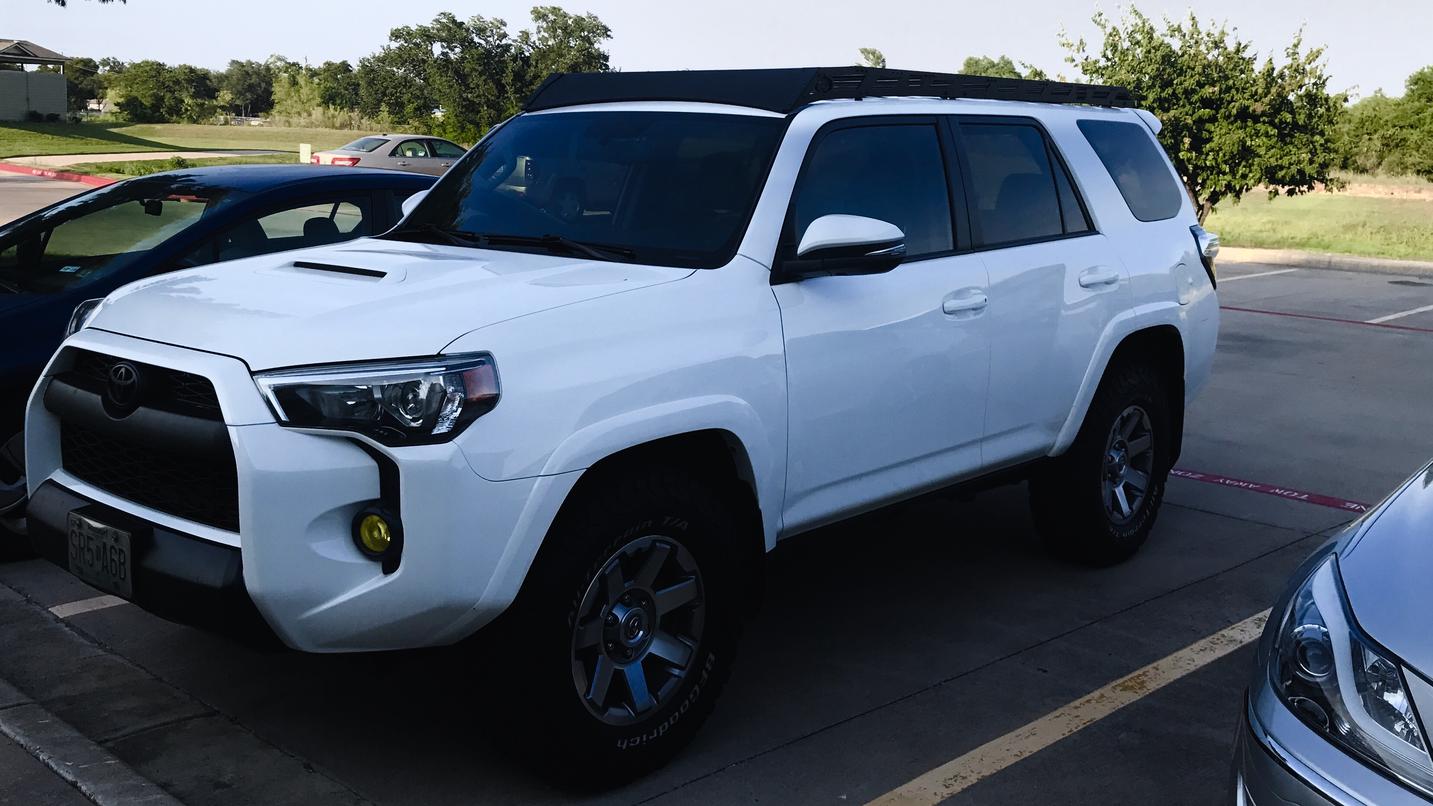

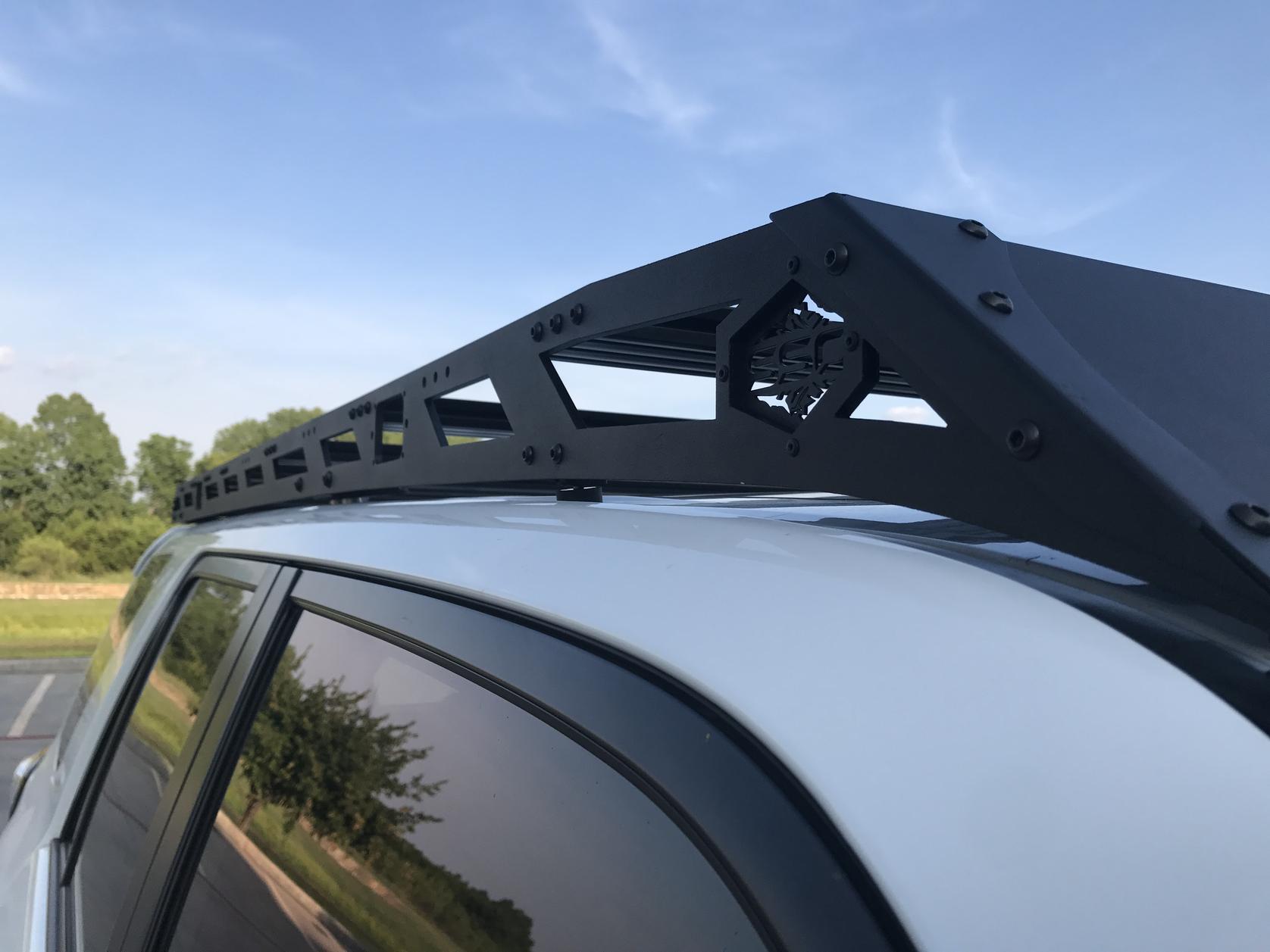

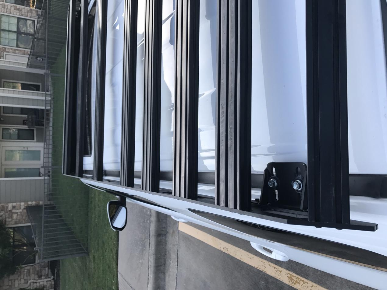

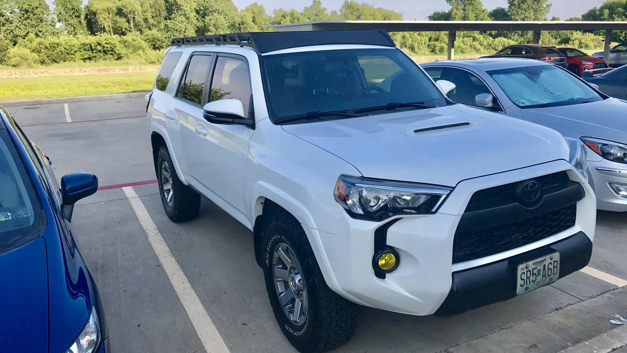

Finally got my rack on! Ordered may 29 and got it July 19th. Only two days after I got the tracking number. Unfortunately they sent me two driver side side rails but they quickly sent me a passenger side rail and said not to worry about the extra one. Ps if anyone wants or needs a driver side side rail and is near Austin tx pm me and you can have it.
For the shark fin. The only way I could get the rails to fit was to put the 2" in the rearmost angled spot and use a 3" in the spot infront of the antenn, but I had to offset the 3" one bolt hole forward to clear. So that 3" bar only has two bolts holding it in. I emailed them and waiting a reply. I thought they fixed this issue but I guess not.

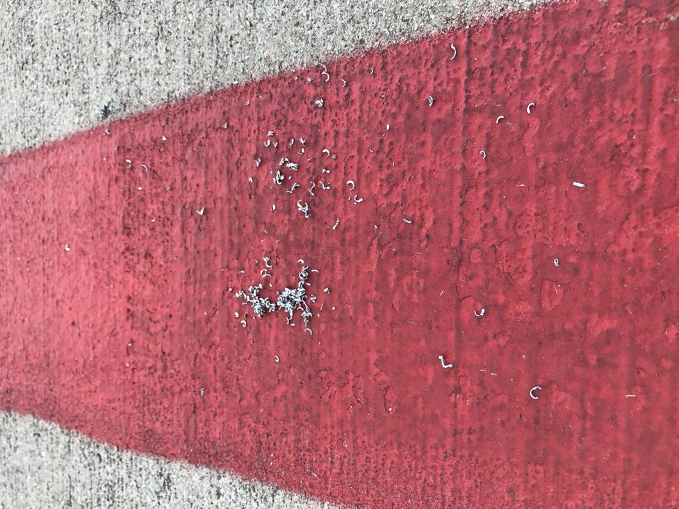

Make sure you check the threads on the cross bars!! I noticed a bolt wasn't wanting to thread in on the first cross bar I was installing. Took a look and that was all kinds of swarf in the hole! Grabbed a pic and cleaned it out and checked the rest of the cross bars and had multiple FULL of swarf. (Swarf is metal left over from machining, in this case cutting the threads). I wish sso would have checked these before shipping out. The crossbars also appeared to have been stored for a while, they were very dusty and the finish wasn't great from rubbing on each other. Not a huge deal as they are hardly visible and will get plenty of wear on their own, just a detail that would have been nice to not have been glossed over by sso.
The picture of the swarf on the red stripe is from ONE crossbar! Kinda a lot.
Fit was quite good. The 4runners roof amhas a taper so it's further apart from the roof gutters in the back than in the front but that's by design I presume and the roof rack is square. Wouldn't make much sense to have a taper for most people.
Looks are great. Really happy overall. Probably left something out but there's my review.

Re swarf: I had some, not as much - took an air gun and clean every thread
