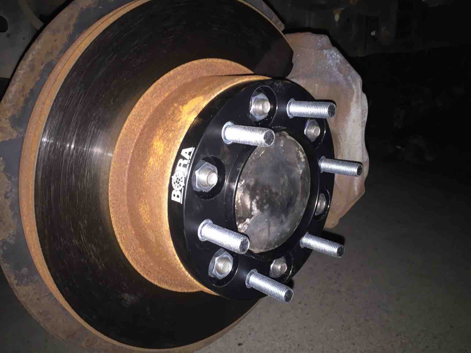

I've gone through the same process not long ago.. ended up buying BORA 3/4" wheel spacers. 50$ per spacer, 200 total. Been on the truck for a few months now and no issues. I have noticed that the studs on the spacers gave me about 5ish more threads than the stock studs. [emoji106]

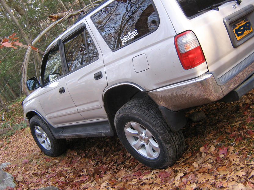

I had to run those beautiful wheels with spacers. I cant believe more 3rd gen don't run them.
265/70/17 with 99 Talls. No rubbing.
