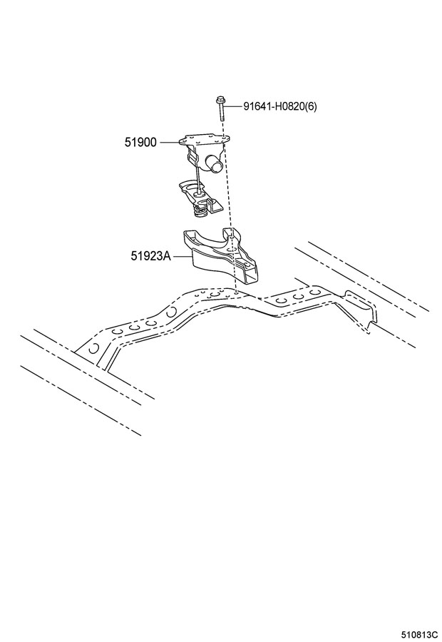

Your understanding is correct, how ever a few items to consider. As stated in earlier posts, the base flange on the cable/chain lift assy., has six threaded holes built into it, which the mounting bolts, which pass through the supporting cross member from above and then thread into those holes in the lift flange. So, even it you try grinding the exposed bolt ends flat, the bolts will still be engaged by the threads in the flange. Also, there are six bolts, 4 of which are located more toward the center of the flange, and are not easy to access from below. This is why, I chose to cut them with an air chisel, working in between the flange and the cross member. I wasn't concerned about any damage to the old flange, since it was being discarded anyway. And, I chose to use a slightly smaller diameter set of bolts and nuts to replace the oem bolts, so if I ever have to remove the lift assy., again, it would be much easier to remove. This was my choice. If you do decide to go with the oem size bolts, just remember there isn't a lot of room above the cross member to get a ratchet wrench and socket in there to tighten them up. Especially if you are working on the ground, on jack stands as I have to. If you are lucky enough to have a full height shop lift at your disposal, the job gets a lot easier.

Check the attached diagram, you'll see the 6 holes at the top of the carrier assembly. You can't see them from the bottom

If you had taken the time to read the threads on this issue, you would have all your answers. 4 of the 6 bolts are hidden from sight under the plastic cover. If you remove the cover, you will see the ends of them. All 6 bolts can only be accessed from the top of the cross member that the winch is attached to. The clearance between the top of the cross member and the body is barely enough to get a wrench in to try to turn the bolt. From the looks of yours, it is rusted enough that I doubt the bolts will just thread out without breaking or rounding the heads off. If you don't have the tools to cut those bolts, I suggest you take it to a shop that does.

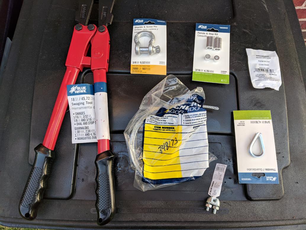

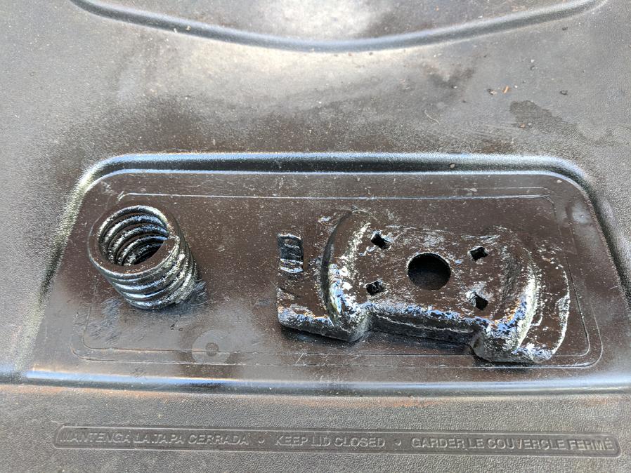

Cable is 3/16. Get 3 feet. Get some wire cable end ferrules and cable wire clamps. Get a cable swager. Watch youtube and learn how to use it. Geta large shackle and a thimble. These are all common cable wire materials. Lowes has all of this stuff.

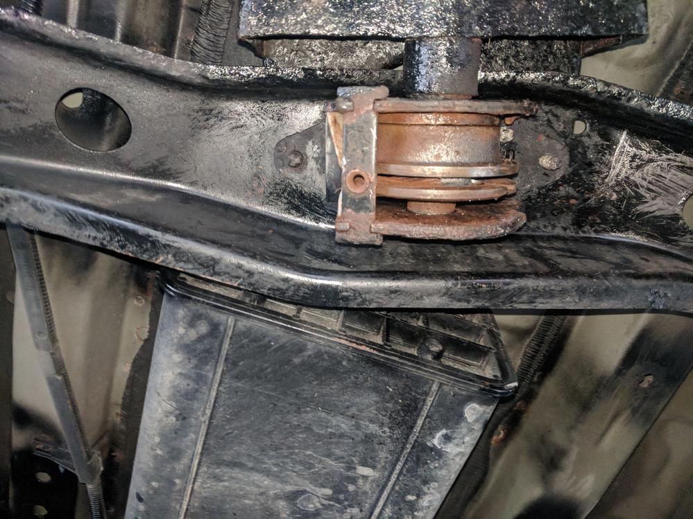

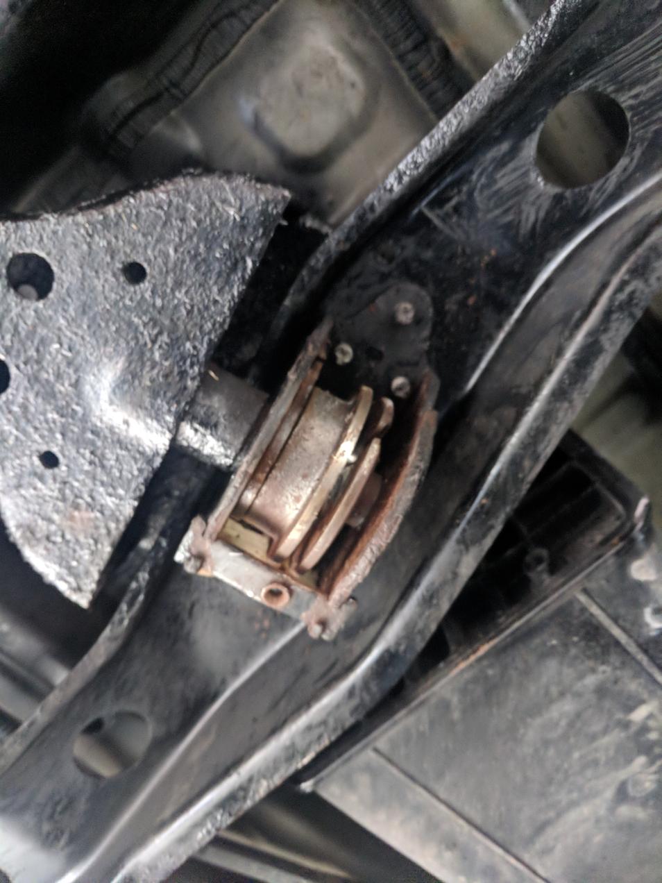

Here some pics you havent seen of the winch without wire to guide your way. See the notch in the wheel? Thats where you ferrule goes. Dont think it will hold? Watch this. Even 1/8 line can hold over 800lbs.
Loctite rust remover and repaint the two old parts you see there. System rated to hold over 1000lbs. Tire weighs 70.
Total cost $40, and no ripping the old one down. If you already have a swager, or rent one. $10. And you learned something new.
Benny123, I'll be acquiring the parts & tool you listed this week in order to attempt to rebuild my hoist. I had to cut the cable in order to get to my spare tire. Naturally, after much whiz wheelin' and air chizzlin' to get the remainder of the hoist off,,,it started to work. My local Toytoa dealership lists the hoist for $195, but would give me a deal at $150... (Charlie's Toyota in Augusta, Me.) I'm fab savvy, so I'll give this a try first!

My winch takes the tire down about 10” above the ground and then gets bound up. Any way to unbind the winch so it goes all the way? I don’t want to destroy it if it can be repaired.

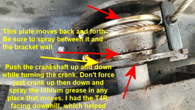

A week ago I took the spare down to get the TPMS replaced. When I tried to crank it up again it wouldn't go very far before binding. I think the 2 plates you see after removing the plastic cover are some kind of reduction gear, not a direct drive. They weren't rusted but looked dry.
The plastic cover is easy to remove but is brittle. Once that was down and I could see those plates I started squirting spray lithium grease in every crack and crevice, working the crank up and down between sprays. I had to lift the crank shaft up and down, rotating back and forth to free it when it would bind up. It took about 15-20 minutes of fiddling with it before it freed itself.
