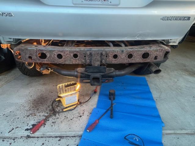

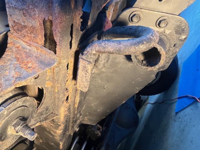

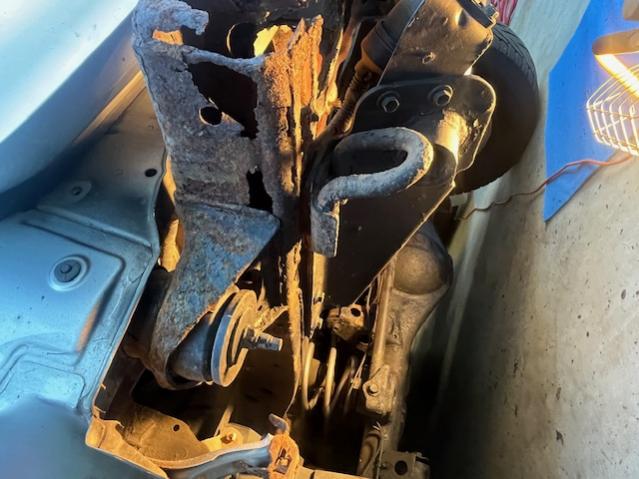

Yea, lol. When that tire dropped, it dropped quick.

Mine seized up several years ago and I was able to shoot lube into the cranking mechanism and after an hour it was working again. Since then it's an annual maintenance item to lower the tire, grease the cable and shoot more lube into that take up reel.
Before I got lucky I looked at some YouTube videos and didn't find much for my 2004 4Runner. I did find one for either a GX460 or Land Cruiser of the same year. On the Lexus models the cross members were bolted to the frame on each side, whereas the 4Runners were welded. I thought if I couldn't free it I would somehow cut my cross member on one side (if that would work) and access the bolts that were on top, make the repair, then weld the cross member back to the frame.
With as much rust as you have (mine is really clean and almost no rust) you might consider cutting the cross member. I couldn't see any other way to get to those bolts. You might find a better one at a junk yard and just replace it by welding it back.
Of course, the $500 option for a body shop might be the easiest and least painful. :)
Ooof, that's more rusty than my truck is but I try to patch mine with welded on metal every year. I'm at the point of passing the truck on to the next guy though. In your case, the only thing I recommend for the frame is welding on Safe-t-caps. You really have very little structural integrity left back there and I bet you have more holes in other areas. On mine, I am currently repairing the driver's side front frame where the bumper bracket attaches. At least the brackets are cheap.
As for the spare tire, like ArthurKotb, I was able to get my tire winch to free up by working it back and forth gently with tons of penetrant and lubing it at least once a year. It took quite awhile to free up.
I am also a bit jealous of 4runherpow's rust free truck. Dang.
One more thing to add, looking at the pictures, if I had to replace the winch I would contemplate cutting through the floor above but I have the gear to weld it back together.

Yea, I wish "4runherpow's" truck was rust free. That's me lol.
You think the structural integrity is shot? I wasn't crazy concerned about the holes in the back but the gashes leading up to the rear driver's side body mount is what bothered me. I figured it looks still ok enough where if I get all the rust out and respray (which I did) and pack the cracks with a bunch of JB weld and high strength crack sealant it might preserve what I have which would maybe be enough?
I don't know how to weld, but I replaced the exhaust manifolds and did the job right in point - no broken bolts, runs perfect. Give you an idea I'm decent with a wrench but is welding a big step up skill, money wise?
The truck otherwise has a lot of good qualities. Very routine maintenance, new suspension - most every where now and very well taken care of.
How much could I even get for her with all the rust?
Also, dumb question but the more I think about it - a body mount isn't exactly "structural" right? What would happen if one of those rotten out? Because my front passenger side has a big hole inside the frame where the mount is attached, kind of hidden by the mount. I bet if a lot of owners pushed inside that space they'd notice the same thing - metal crumbling away.
Like the rear looks really bad but as long as I'm not towing, is it a massive issue?
