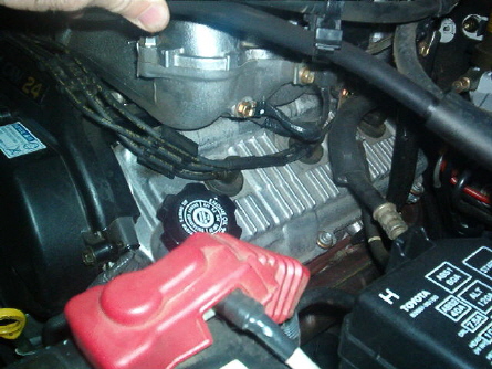

I took some close ups of my 2001. Maybe it is a bit different than a 1997, but my pictures show:
On the drivers side, spark plugs are fairly easy to get to.

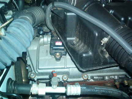

On the passenger side, it is a different story. At least on my year, a BIG black box is in the way.
getting closer!
Ok what are the little black boxes that are bolted to the valve covers? They are in the picture that peter78 posted just below the air intake duct there are three I assume they are covering the spark plug boot, I know I need a picture but the wife is driving it at the moment I'm guessing that they can be removed with a 10mm socket and those are the spark plug boot? I just haven't seen anything like that before on a valve cover, thanks for your patience and willingness and knowledge.

Ok, not the largest picture, it is my first, but I hope you get the picture, no pun intended!If you can't see it is the same one that peter78 posted I just edited it to show the mystery box.
Gunner

I thought you listing the time it took to do wasn't exactly a "how to" and if you would have said remove the coils since that is what those mystery boxes are and behold you will find the spark plug boots then you might of had something.... I had done all the looking what I needed was an illustration or some pics which I've had problems posting, perhaps you have a how to on that. I'm still not sure what terminology spark plug covers are... but you are correct in saying that self educating is best and I plan on doing a how to with pics to show that the coils have to be removed per plug. Could you send a mechanic to atleast set the torque wrench for me and maybe wipe my brow, maybe one of those Snap-on calendar girls? :D
