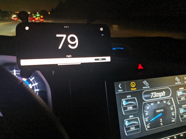

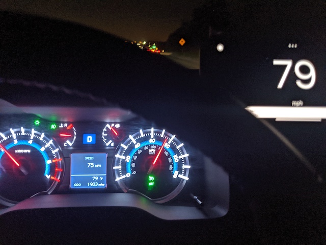

Any aftermarket options to fix speedometer after going to larger tires? Running 285/75/17 KM2's and noticed that it's 5-6 MPH off based on cell phone GPS (tried 2 different apps) when in the 75-80 MPH range. And I'm usually trying to drive 79 MPH on the freeway... which means I will be getting tickets unless I fix this issue...
P.S. I have an Alpine 309 Halo9 ILX-F309 but don't see an option to adjust it there as well... it seems to be reading from factory dash so it's useless as well...
Have you confirmed actual speed vs the speedometer with one of those radar speed limit signs? I doubt your phone gps is correct.
My 2019 speedometer is accurate with a 33" tire. Lots of people on here report the same finding with their trucks on 33"s. With the oem 265/70R17 tires, the speedometer was off and showed me going faster than I actually was. When it showed 70 mph I was actually doing about 67.
265/70R17 = 31.7" diameter; 656 revs/mile
255/80R17 = 33.1" diameter; 628 revs/mile
285/75R17 = 33.9" diameter; 614 revs/mile
I'm thinking your speedometer should read a little over 2% slow with those tires, so figure you're going 79 mph when it reads 77.

Ok then, another way to check your speedometer is to choose a route with a known distance, say 20-30 miles or so, then set your cruise control and time how long it takes to drive it. The longer the route, the less chance for error. Then come back and report your findings.
