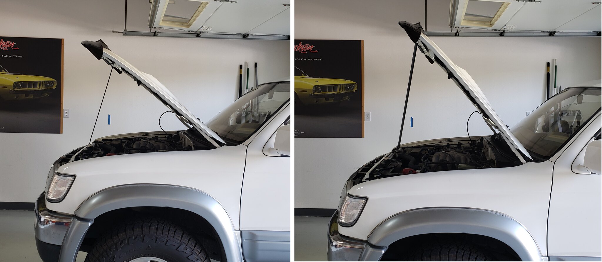

Here is what I have in mind, the current opening position, and what I am working on, about 6" higher when open:
(the picture on the right is just a broom handle holding up the hood in the proposed position, the struts would be mounted in a more conventional arrangement) :D.

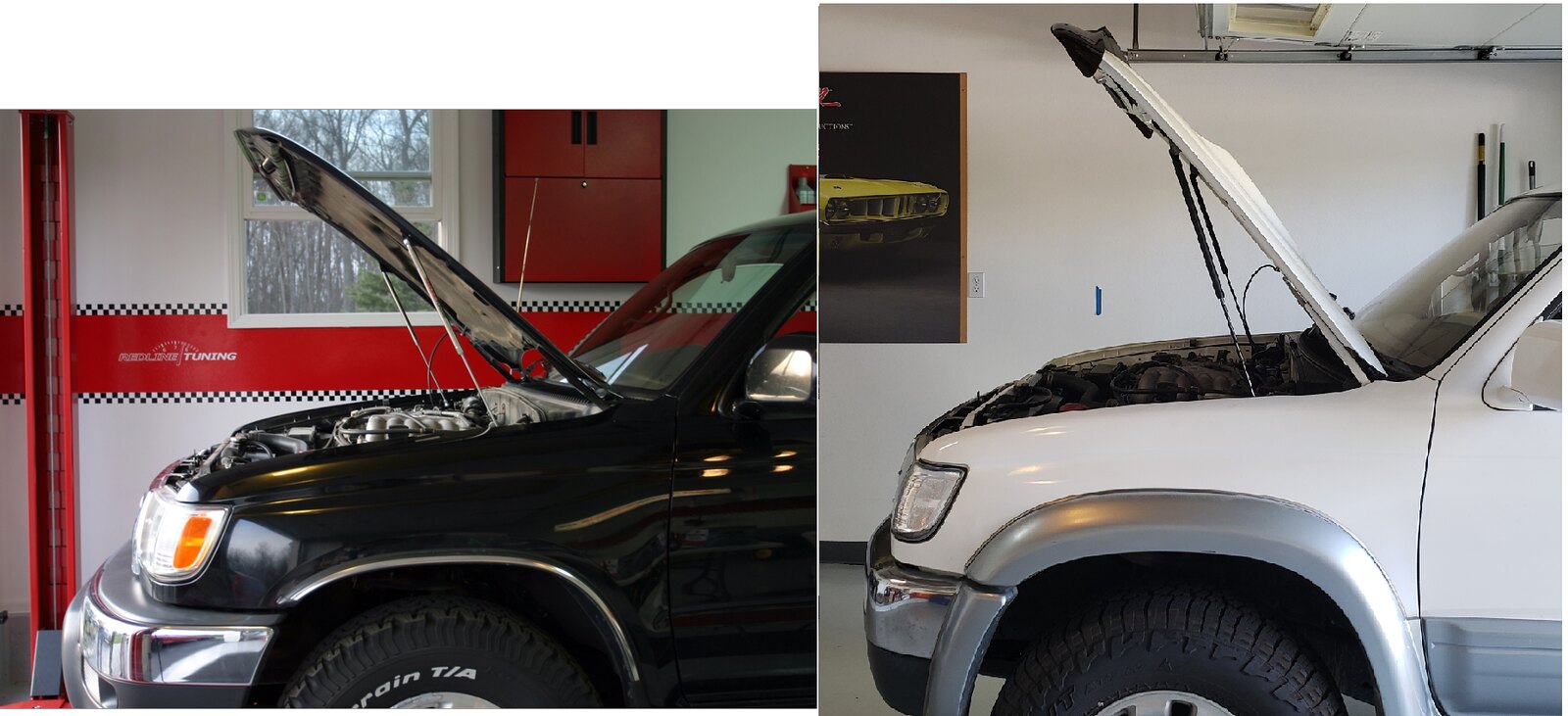

So I have a working prototype, here is how it compares to the Redline Tuning kit:
It opens taller than RL Tuning, and requires fewer drilled holes. It works beautifully on my '97 - the struts take over the opening after the hood is lifted about 12-18", and it comes to a nice firm stop at the top. When closing, it needs some force to get it to start closing (not too wimpy, and not a big heave-ho), and then closes and latches on its own, or maybe with a slight encouragement :).
