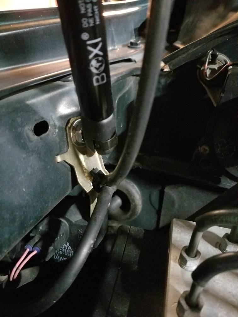

Just out of curiosity, was the door lock buzzer a factory installation in that location? I haven't come across those before, so I'm curious how common they are.
Thanks, AFAIK it looks factory installed. I was surprised to see it there and took a pic right before removal. Found an older thread where it's discussed:
That thing that beeps
Very interesting! From the way it appears to be mounted (attached to a flat bracket), could you have removed the mounting bolt and put the ball stud in its place? Not that it matters, sounds like you found a working solution regardless!
Lock buzzer is factory location on later models my 01 has it there. My 96 with controller under driver seat had cheap buzzer near battery RS system.

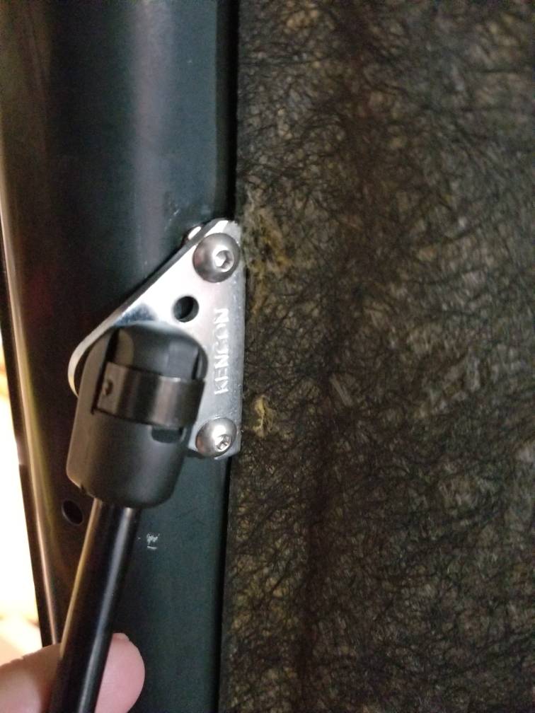

I set mine about an inch before I got resistance, used my hood prop tool to hold it open,,,the upper hoses hose clamp made for a great center point to the hood latch so both sides open at the same time,,I used stainless rivnuts and allen head bolts in 5mm instead of the pop rivets for the hood mounts,,,sits flush and tight.,,the relay on the passenger side I kept in place with the pivot supplied and drilled a hole in it's bracket to hold the washer hose...looks perfect...I also drilled a small hole next to the prop rod spot in the hood and hooked a lanyard to it so I have something to grab when I close the hood.,,it's just a standard key ring. Really like this kit and appreciate leon for putting this together,,,,works great.,,thanks for all your help getting my account setup....oh and I didn't realize there was directions in the box...forgot to look.,,didn't need them as it's an easy install.
I set mine about an inch before I got resistance, used my hood prop tool to hold it open,,,the upper hoses hose clamp made for a great center point to the hood latch so both sides open at the same time,,I used stainless rivnuts and allen head bolts in 5mm instead of the pop rivets for the hood mounts,,,sits flush and tight.,,the relay on the passenger side I kept in place with the pivot supplied and drilled a hole in it's bracket to hold the washer hose...looks perfect...I also drilled a small hole next to the prop rod spot in the hood and hooked a lanyard to it so I have something to grab when I close the hood.,,it's just a standard key ring type....I'd post pics of it but I don't know how yet!! Really like this kit and appreciate leon for putting this together,,,,works great.,,thanks for all your help getting my account setup....oh and I didn't realize there was directions in the box...forgot to look.,,didn't need them as it's an easy install.
Rich, thanks for the feedback, and glad that we got your access resolved, I look forward to your contributions to the forum!
Your customizing sounds very clever, please do share pictures if you figure out how to do it (or email to me, I can upload them). I debated using rivnuts vs rivets, but went with rivets in the end because they have way more than enough strength for this application, and because more people have access to a rivet gun than a rivnut tool. But I did use rivnuts when installing my prototype, because the bracket had large mounting holes in it.
Too bad you didn't see the instructions, I think I'll zip-tie them to the struts in the future, so they don't accidentally stay stuck inside the box. Glad you figured it out though, and that it all worked out.

Emailed instructions are fine, I set the height to fully open position and it never stretched the hose, maybe mine was a bit longer? :bounce: I was also able to reuse the same hole the hose clamp was attached to without the strut putting pressure on the hose and finally, I did re-attach the buzzer to it's original hole using the new strut bolt as you suggested and it worked like a charm. Great product! My only complaint is I now have to get on my tippy toes to be able to grab and close the hood (kidding). The difference is night and day! Now my other half wants one for her 2011 RAV4 LTD, I told her I'd pass that on and see what you have to say about it. I know Redlinetuning makes one for 06-12 RAV4 but I'd rather get it from you if you have a set.
Great feedback, thanks! I think I'll update the instructions to suggest using the passenger side bracket as an attachment place for the washer hose, for those that have it. I'm also pondering adding a bracket to the kit to hold the washer hose, for those of us with the pre-99 models, without the bracket.
