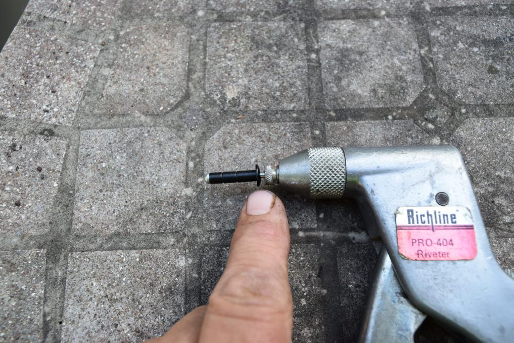

Just wanted to be a bit more clear on the tip about those pop rivets being so hard to install. I am glad you use the best pop rivets available as it shows your commitment to quality and a solid installation. In the picture I show the space needed to have prior to pop the rivet as it allows for a smaller grip on the rivet gun with your hands. It really matters on the second, third and final draw of the hand tool. See pic for 1/8" spacing between the top of rivet and gun is what allows this to help close the tool.
Yes, that's exactly what I was picturing, thanks for the follow-up. And kudos on the vintage Richline riveter, that is a classic example of "they don't make 'em like this anymore"!
