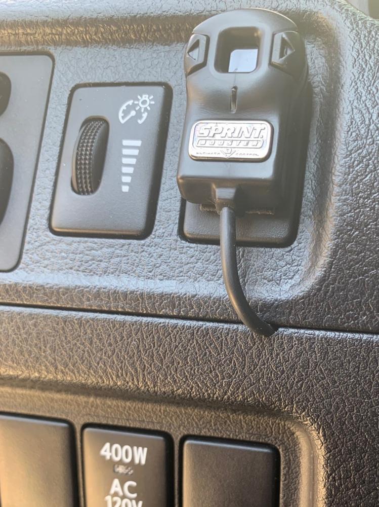

Install on my 18 4Runner was a piece of cake
As you can see from picture I used a blank plate and drilled a hole for Cable to fit, very clean
Not sure why 10 min Waite on 4Runner with door open, but I followed instructions
System works great and noticeable throttle response improvement
Stated with green 5 tried 9 then switched to red 9��
That’s pretty much where it will stay
One install tip, I used a skinny dowl to feed controller wire
I’ll give the system a 5stars
Does what it says it will do
Jim
