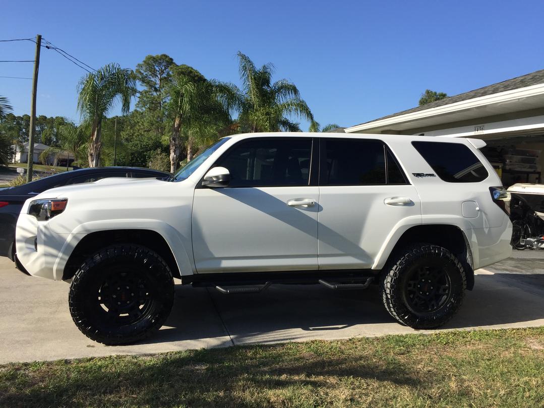

So I hit some trails today with the added confidence of new tires. Truck rides great. When going at about 20 through the rough stuff I noticed some squeaks coming from the front coil over area.
Has anyone else, with the same suspension set up noticed or experienced the same? I haven't had a chance to really investigate myself but thought I'd bounce it off the group first.
