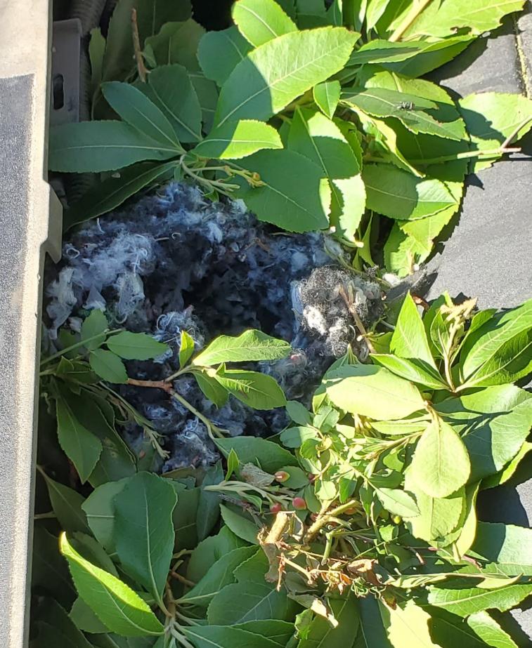

This was in my work Explorer in just 2 days ! Totally fresh locally harvested greens... and a bunch of chewed up sound deadening material that I don't know where they stole from, doesn't seem to be missing any. They didn't chew up and wires but gnawed on the engine cover a bit and crapped all over the battery, the designated pooping spot.
Depending on the year of Explorer the insulation is either from the under engine shield, the hood, or the inner fender liners.
