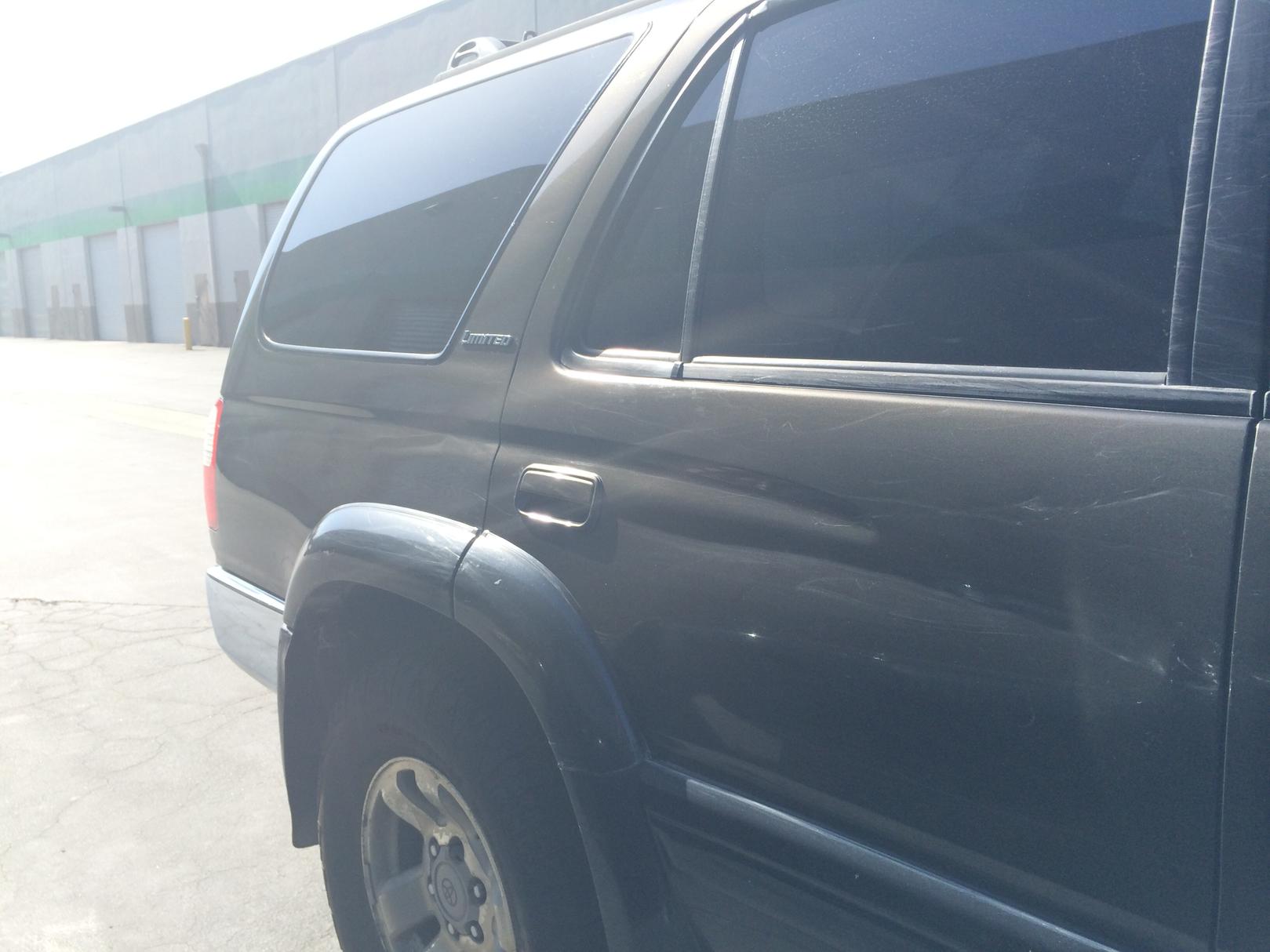

I need to replace my doors since the body work is way too expensive to have them fixed. I found a deal on some SR5 doors but I'm wondering if the only difference are the holes for the door / fender flares?
I have the limited so I have the door flares, the doors I found don't. Will I have any issues trying to remount the flares? Instead of using the clips, should I just 3M tape them? Will that even hold?
Thanks.
They came "clipped" from the factory for a reason..... I would not suggest the tape method.
Yeah but I was trying to think of a way of making square holes and I couldn't think of another way. I could prolly make the holes and adjust the clips to fit?
Yes, you can use 3M double sided tape. Don't buy too thick tape as that may lift the flare and may hit the front door when opening.
Use 3M VHB tapes. You can also see how strong this VHB tape on youtube.
