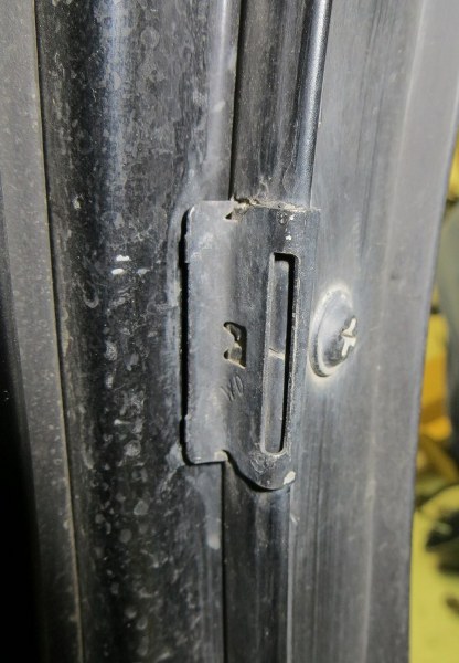

I just pulled my driver side rear SR-5 oversized flare with integrated mud flap and one of the clips that holds it into the chrome bumper corner broke off. I’m hunting for either a part number or some other clip that might work.. I’ll post here if I find something.
I wonder if these would be interchangeable:

Photos for reference:
I got lucky and found a few extras at the junkyard, but I'm pretty sure Napa has something extremely similar in their little catalog.
