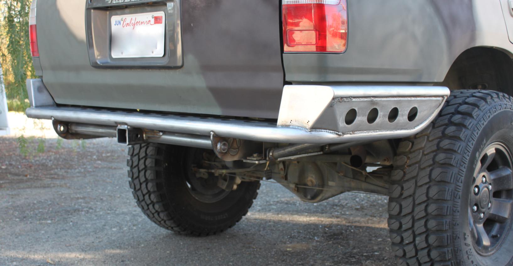

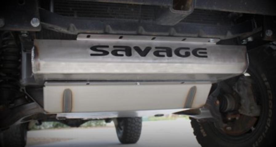

Proud to announce our partnership with...
Savage Off-Road
We'll be utilizing their skid plates and rear bumper! Very excited to work with Roy on this and show off their kick ass products.
