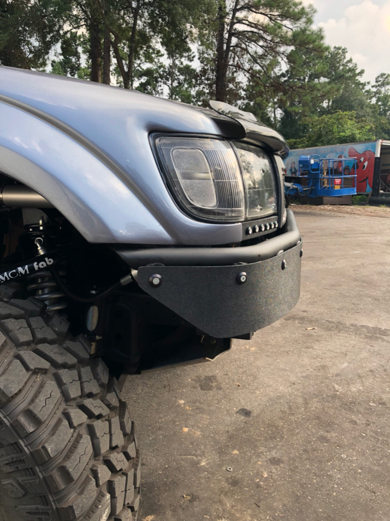

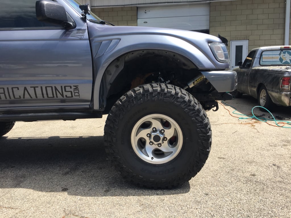

Trimming has begun
Well this happened...

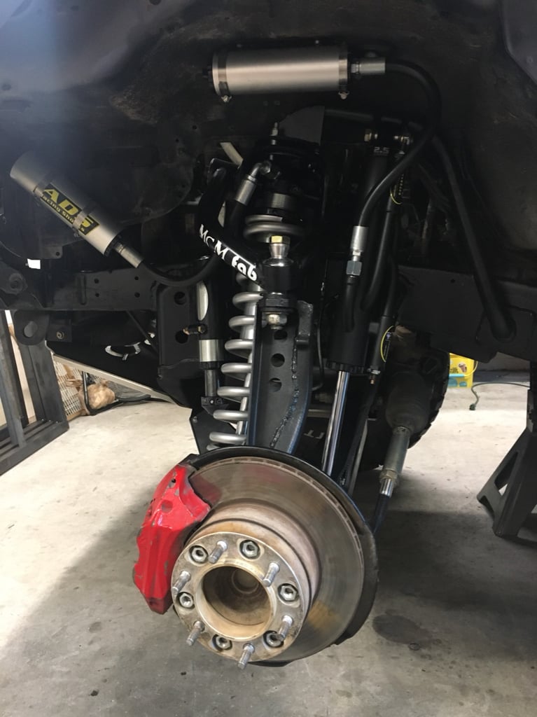

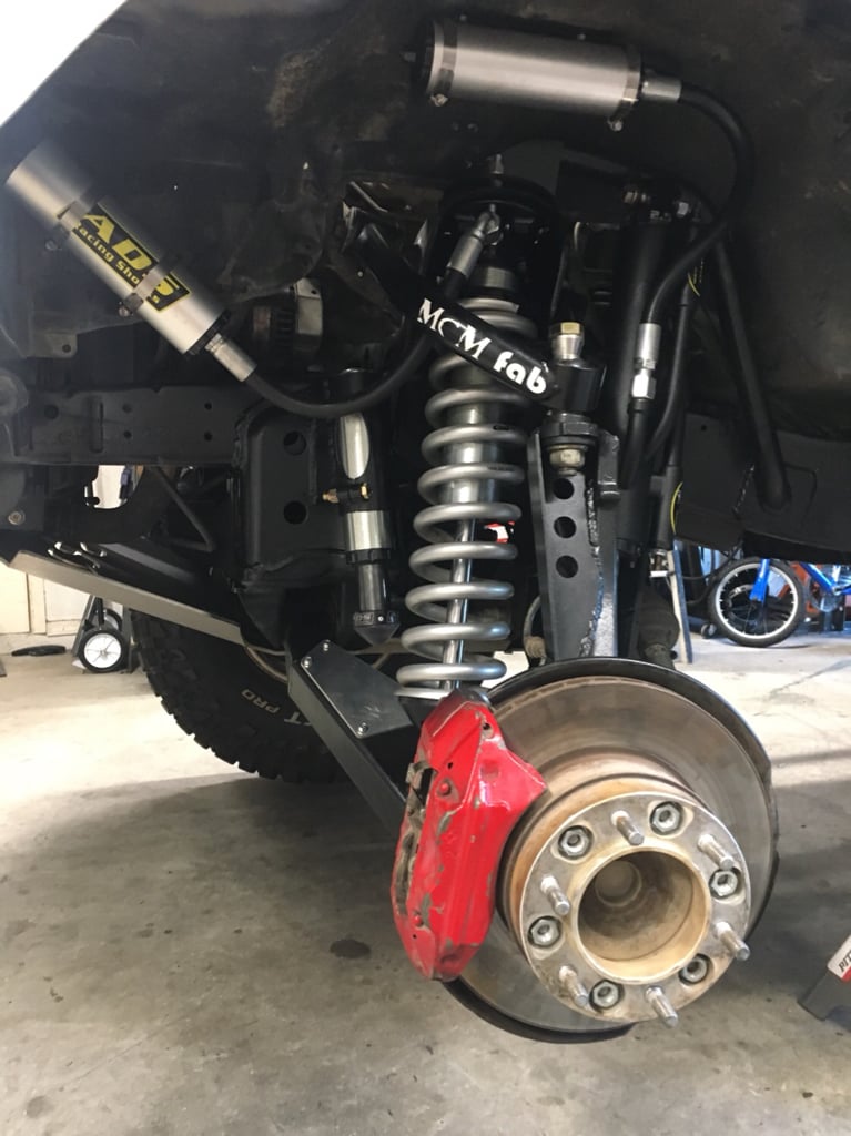

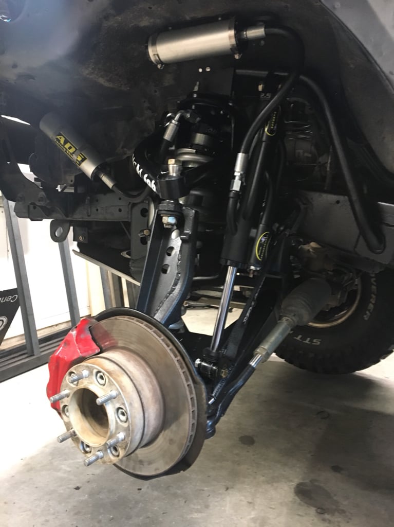

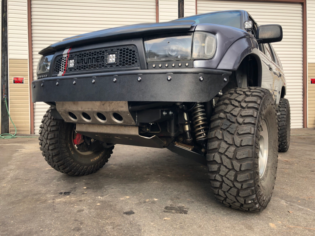

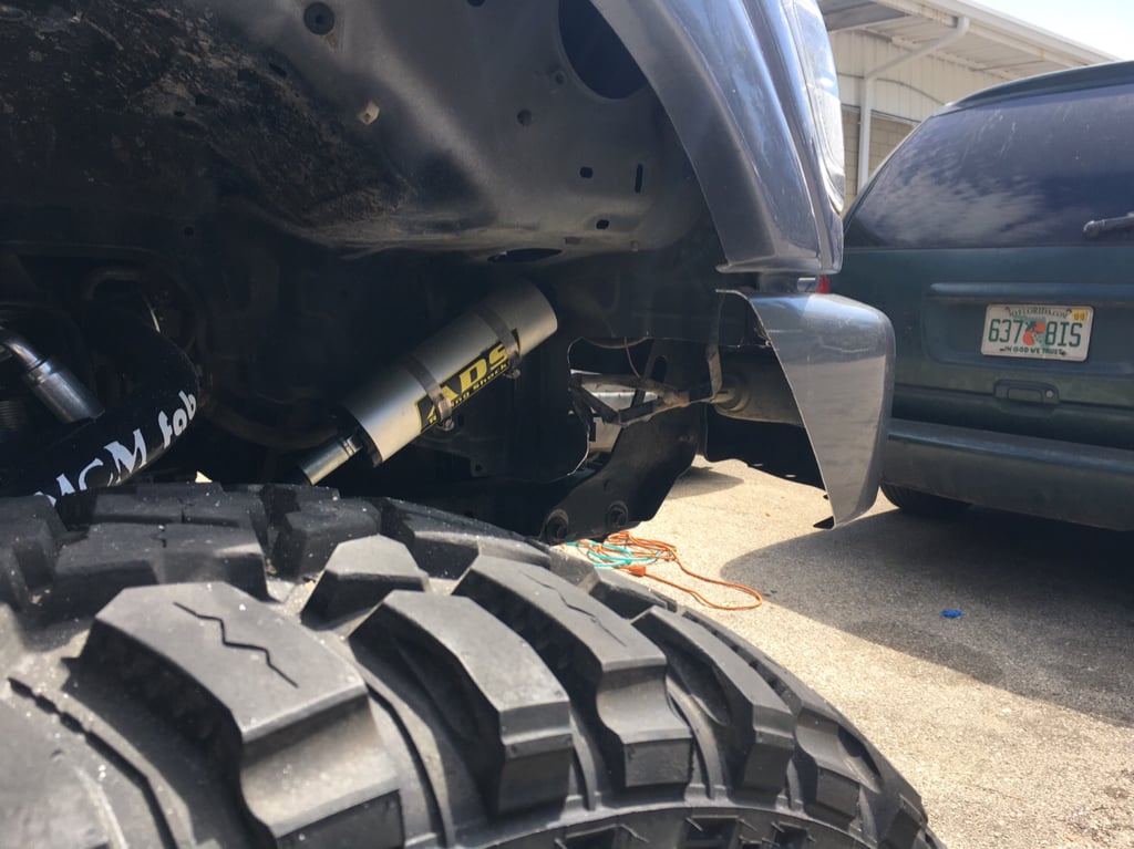

ADS 8” 3 tube bypasses
ADS 2” Bump-stops
MCM shock hoop mounts
MCM bump-stops plates
Kar Tek Limit Straps
Total Chaos Spindle Gussets
OEM LBJs

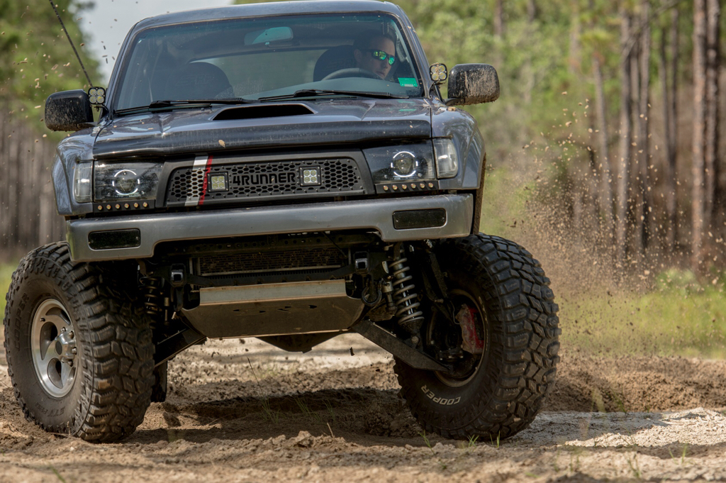

Curious, what tire sizes have you ran? The new kicks look like 315's? Old ones 285s?
I've had Cooper STT 31x10.50x15 and Cooper STT Pros in 33x12.5x15. Current Coopers are 35x12.5x15
