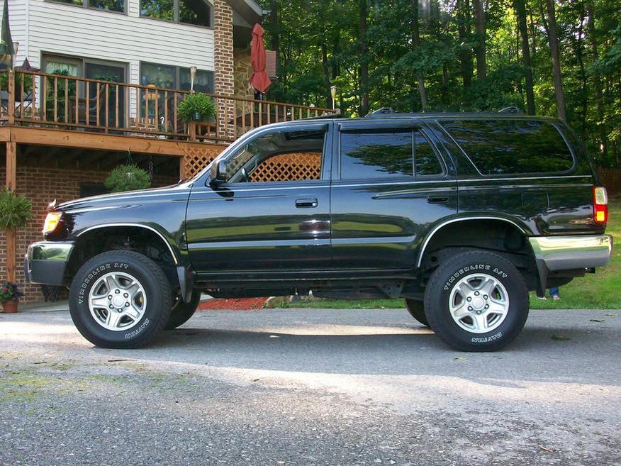

If you run an aggressive all terrain tire they look fine. I ran that setup for awhile and it looked fine. My buddy runs 2" body lift on top of the 3" lift on those tires and it still looks fine.
Here are some non aggressive tires and still looks fine.

I drove mine for about 2 years with the SS1.2 and 265/75/R16 tires. I also had a 1.5" body lift. I thought it looked fine.
The 285s look better to my eye, but 265s look and work just fine. The upside of 265s is you don't have to re-gear and your power and gas mileage will be better than with 285s.
