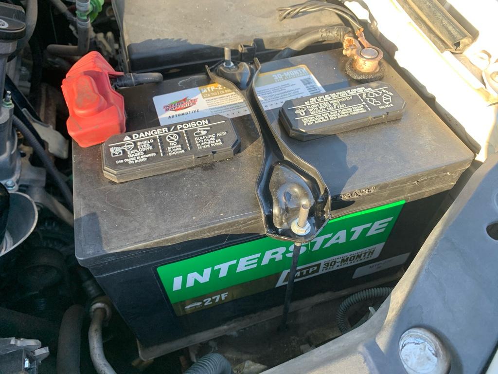

Everything looks clean, and, the battery was tested by my local mechanic three weeks ago.
Do you know how the battery was tested? Was it actually load tested to see what it's capacity is under a load, or just putting a volt meter to it to see it's got volts. I ask, because a battery can show good voltage but have dead cells which affect storage capacity and load performance, and batteries tend to be weaker when they are cold. You can also pop the cell caps open and see if the water is low. Did the installer mark the date code stripe on top? Can't tell from the picture.
