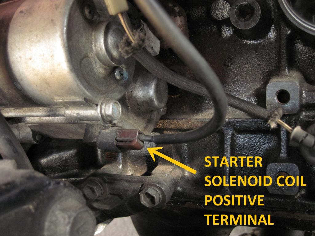

So I've been having intermittent trouble with the ground to my starter at the starter wiggling loose at the connector. I went to Toyota to see if they still make the cabe or the connector and they told me that I'd have to find one at a junkyard. Wondering if I could bypass the plastic connector and solder the ground directly to the starter. 22RE 4 cylinder, any thoughts? :keyboard:
The what now? There's no ground strap on the starter, it grounds to the engine block. You'll have two wires going to the starter, a smaller gauge with a spade connector that comes out of the harness under the intake plenum and a larger gauge with a ring terminal that comes from the battery. Is it the smaller wire you're having trouble with?

Short of going to a junk yard, where can I get this solenoid connector?
... the guy building my wiring harness wants the plastic shell part.
Clip it off a harness, like KidV says ^^... at a junk yard or online stores (toyotapartsdeal... rock auto...) but I highly doubt if those places would go through the trouble of low-value, non-critical items.
