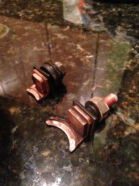

After much struggle and 1 hour's worth of tedious work, I got the eff-ing starter out. It took a bit of coaxing, but I got it out through the wheel well...with the bendix pointing to the engine. All I had to do was remove the the upper tranny dipstick tube and remove both brake line support bolts. I didn't disconnect the brakes lines. Once out I took the cover off and the contacts look nasty and deeply grooved. I am headed to the dealer tomorrow to get the correct ones. I felt like I won the lottery! I will let you know how it turns out and post some pictures as well.

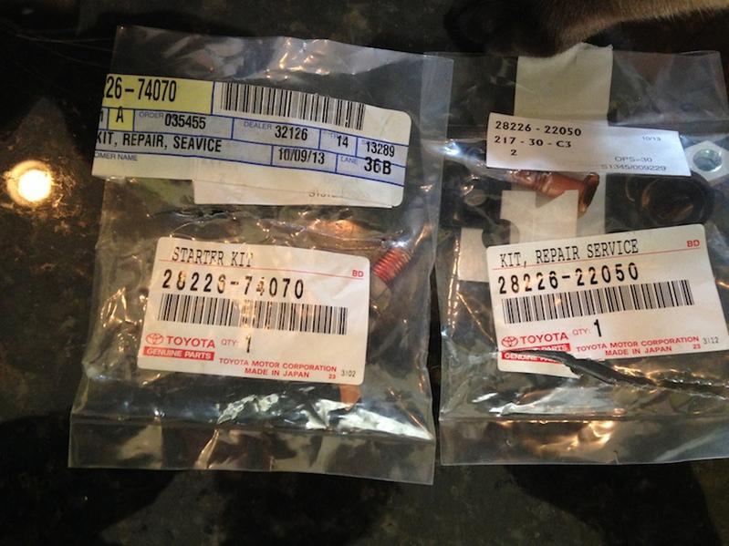

The first image is the old contacts. Note the groove on the larger one. The second image is the part number for the rebuild kits. I paid $19 each. The kits come with all of the hardware.
