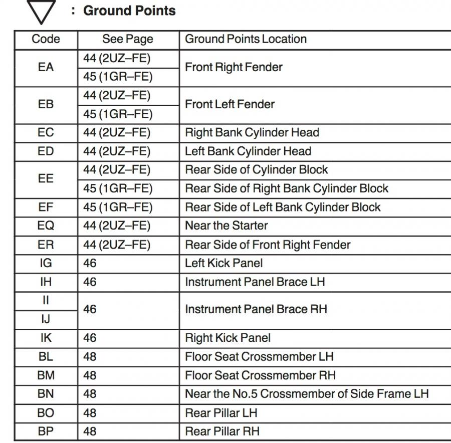

I'd start by inspecting each of the relevant grounds listed in the graphic attached. By inspecting, it's examining the wire for signs of damage, then removing, cleaning, and reinstalling each ground attachment.
And after that, I'd swap the Starter Relay (underhood electrical panel) with another identical one from a circuit you can live without.
Inspect the relay terminals for corrosion, clean it up if found.
If it still persists, the ACC CUT relay appears to be in the power circuit so do the same for it.
Thanks waypoint. May take me a couple days to find all these grounding points. I take it you think it’s an electrical issue… was hoping that wasn’t the answer. A starter solenoid or something would have been a lot easier!
Did that table come out of the service manual? I assume those page numbers listed will help me find these grounding points?
What year and engine is your 4R?
The ground chart is from the service manual, and the detail sections usually have diagrams showing locations. Best $10 on eBay I ever spent.
