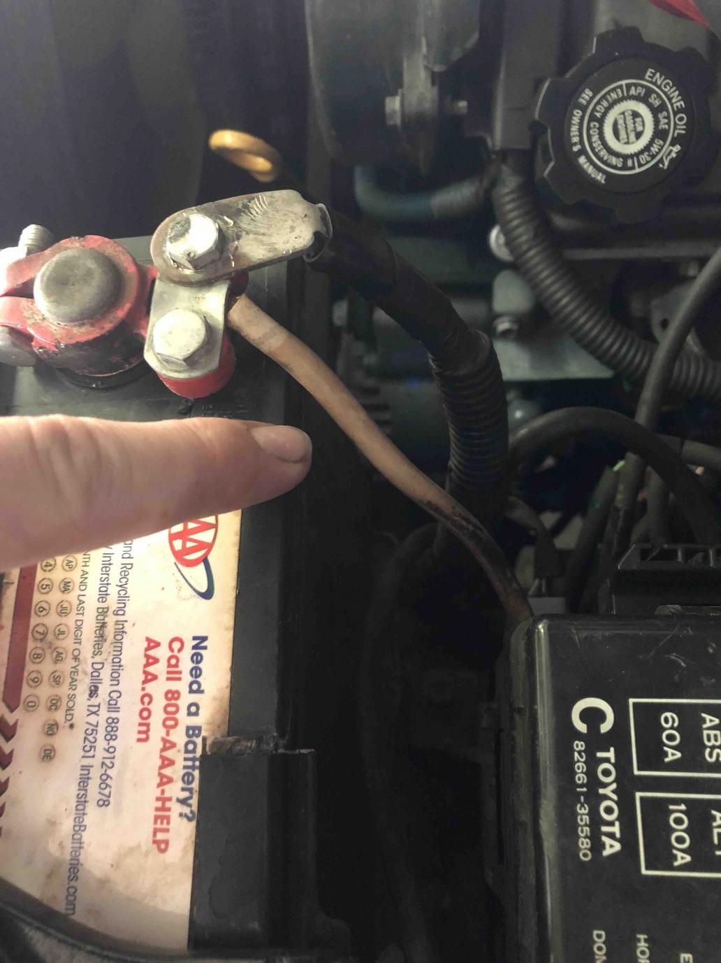

I had this same issue in my 97. I replaced the starter too, but after looking closer the wire coming off the battery was loose. Idk if you have checked yours. But after tightening it down, I havent had the issue again.

Start with the basics. Make sure the battery terminals are clean and tight and the cables are not crap. What is the resting voltage of the battery before you try to crank it?
Just because the starter has been replaced does not mean it is good, especially if it is not an OEM starter.
