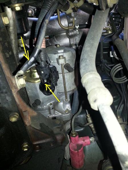

Finally got back around to working on it. After checking the voltage on the starter I noticed that if I used something on the body as the ground it read 12.8v and if I used the starter as the ground I got some odd number. Ran a new ground from the battery to the alternator and all is fine now.
Thanks for everyone's help!
