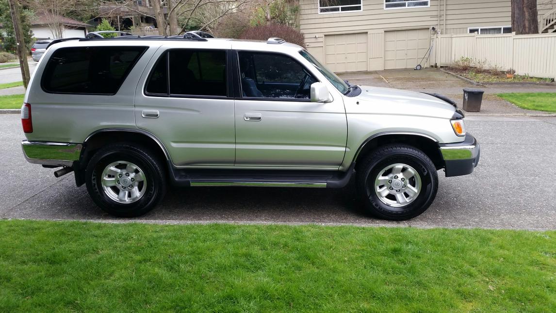

And just so this thread isn't worthless, here's a pic.

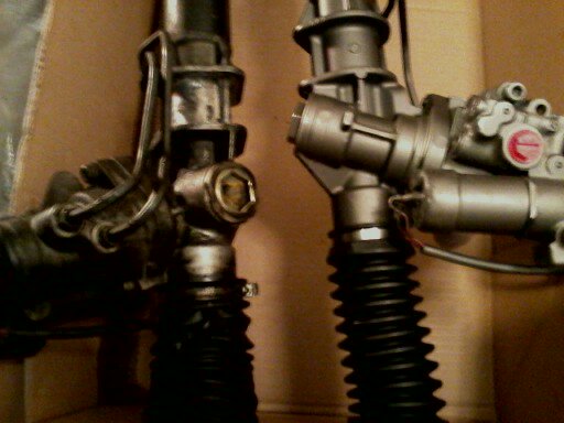

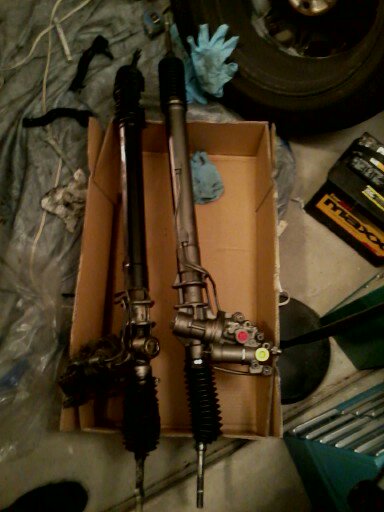

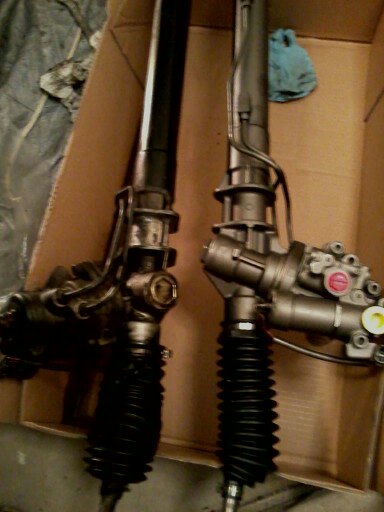

I bought a remanufactured steering rack for my LS400 almost 4 years ago from discount steering and it has been great. I went with them based on recommendations from other Lexus owners who had good experiences and I have been impressed. They even supply the return label and you just use the box the replacement comes in and offer a $100 core reimbursement. They also offer new units but I believe the reman'd units are OEM or at least equivalent, it looked identical to the one I pulled off my car. I even still have pics I'm attaching. They also offer 36 month warranty on all units, and their prices are great. I sound like a damn salesman, I have no affiliation with them but there is no need to get ripped off and I just wanna pass along a good deal. The LS400 also tends to have a very picky steering system, I couldn't get two reman'd pumps to work (not from them) before breaking down for a $600 OEM new one, but the rack has been awesome the entire time with over 30k miles on it. Direct link to your year 2000*Toyota*4 Runner*Power Steering Rack from DiscountSteering $175 after core for a remand'd? Not a bad gamble IMO

Nice rig, but the picture we need is the written quote you got stating what was wrong! LOL
