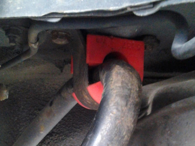

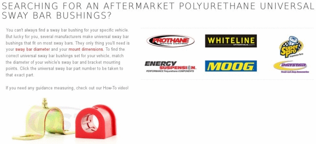

Are you aware that you can buy custom swaybar body brackets with 90-degree zerk fittings:
Aftermarket Universal Sway Bar Bushings | Polyurethane and Rubber | by Size

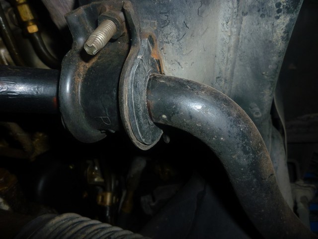

What would be useful for everyone is for you to snap a picture of the fitment of the body swaybar bushing.
Here's what the OEM fitment looks like for the driver's side:

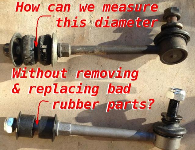

And, we still need a way to MEASURE accurately, without tearing apart the sway bar and endlinks just to measure, and then to resort to putting the old rotten parts temporarily back on afterward.
Do you have an idea for how best to measure the swaybar and endlink diameters AT the bushing? The method I selected was the midpoint, but that may not be the best way.
How would YOU suggest we measure this critical parameter?

99Runnr, for example, can help everyone by posting a picture of his fitment, since he used the Autozone kit which the OP and I would probably deprecate.
Anyone else can help by opining on how a 4runner owner can determine their sway bar diameter and endlink diameter AT THE BUSHING without having to tear it down temporarily, just to put it back together with the old rotten bushings.
Does my midpoint measurement technique hold up, for example?

One way you can help is to MEASURE the midpoint diameter of both your swaybar and your endlinks, and REPORT back here what you found (as I did).
If a few of us did that, as I have done, then we could get a better idea if this misfit problem is a general 3rd-generation issue or just an issue for specific setups.

II have supplied a photo as well as part number in the other thread. There is about 10 now, so let me specify it's the one where he found a "greasy rubber thing on the ground".
Thanks for the humor. I'm gonna sue Samsung for this lackluster autocorrect now.
Thanks for that picture and the satirical comedy in your response on that thread.
I reproduce the photo below so folks reading this thread can get the picture.

What measurements did you get at the swaybar midpoint and endlink midpoint for your 4runner?
