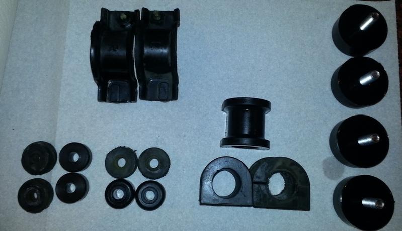

Mtbtim, I supplied that pic and the number from the manufacturer in the other thread. It's a 25 mm / 1" bushing and as you can see fits like a glove.
I paid $11 for them at autozone. Found my receipt.
i couldn't find the right bushings so i used a skateboard truck bushings and installed that! works great! so much flex now!
What color and durometer?
Thanks. I was promised another set of end links bushings from Prothane but I think they forgot about me. I've also been talking with Greg at Energy Suspension. Greg told me he'd hook me up with a set too but he wants to first find out if Dominick at Protane is going to come through.
I was annoyed with Prothane that they sell that 18-1115 kit knowing people will have problems with the end link bushing fit. Many on this forum just bought another kit that has the correct size end link bushings. While it's not a huge amount of money we're talking about, it's a matter of principal that they should fix the problem. But, very soon I'm going to get tired of calling them and I'll either buy the set you suggested from Auto Zone or one of the other Energy Suspension kits I was suggested from other members. I was hoping to affect some change at Prothane so future 3rd Gen owners would get the correct size bushings and maybe they will do something about it.

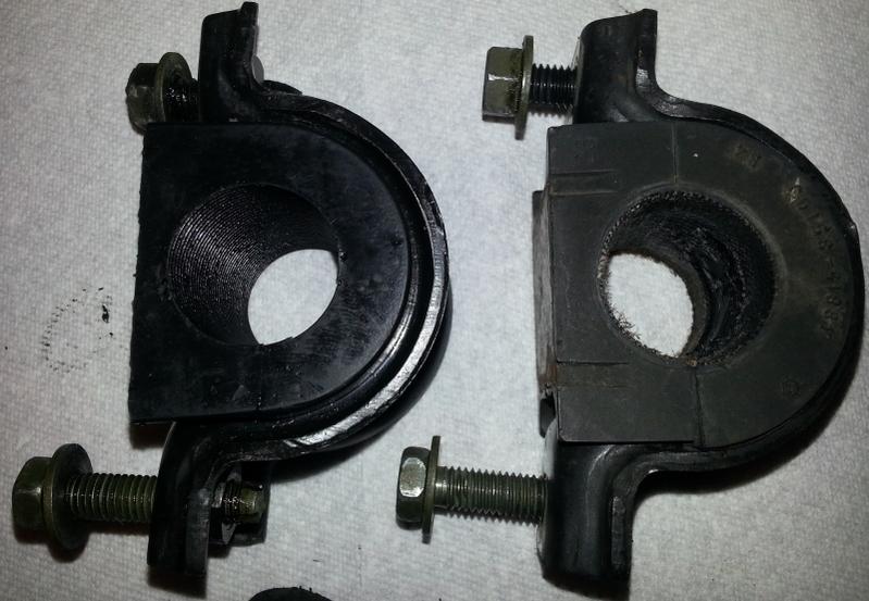

I decided to change my sway bar bushings because the one on the drivers side was mushing out on one end. I can't really say if the polyurethane bushings did anything though. I guess if I regularly took corners fast causing a lot of body roll before replacing the bushings, I would then be able to go out and drive hard to see if I detected a difference. I drive my rig like a truck and not a sports car, so I reckon I'll never know. I heard on this forum that they were a nice upgrade, and since it's not an expensive upgrade, I just went for it. I can say for sure the polyurethane bushings in the steering rack were an improvement in steering response. That was easily noticeable. Rubber obviously gives more than polyurethane so it makes sense. And, since the OEM sway bar bushings are rubber also, I'd imagine you would get less movement out of the sway bar using polyurethane bushings and thus it would help the sway bar do it's job better. Seems logical, I think. For a $20-30 investment, it's worth trying out.

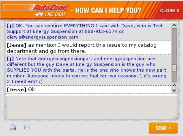

I spent an hour on the phone with their corporate headquarters, and they're not even AWARE that they have a problem (because nobody has told them that except me, according to them).
If you can get the right-sized kit from Autozone by ordering one for the Tundra or some other vehicle, that's great. Please let us know what part number and what the fitment was, so that we all learn from your efforts.
Or if you can get a kit that also comes with the larger swaybar body bracket, that's great also (but note the few millimeters of overlap of the bushing at the bottom, as compared to OEM please).
But otherwise, I had given up on Autozone after those phone and online-chat conversations (it was much like trying to explain to a bunch of kids how gravity is not really a force but just the curvature of spacetime; they just couldn't fathom that their kit didn't fit because it wasn't how they comprehended "their" experience).

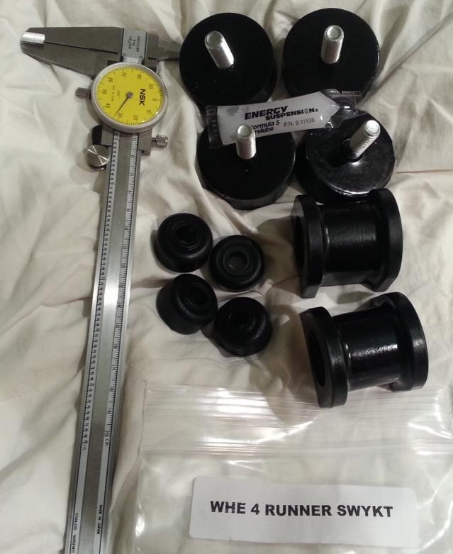

Here's a picture of what came with the Daystar kit.
(The calipers are what I used to make the ID & OD & Height & Length measurements that I posted just now in the measurement thread.)

I did the job early this morning, and the Daystar bushings fit perfectly (see picture below). I made measurements and will post old and new measurements to the bushing-only thread; but the summary is that they're almost exactly the same as OEM (within a few thousandths).

If you've seen the other thread, I posted only a SUMMARY of the number of phone calls that I've made on this endeavor. I think that we've made good progress though, as Prothane has to realize they're shipping the wrong stuff and Energy Suspension didn't communicate that they fixed the problem to all their personnel.
Of course, the lookup engines are all still wrong ... so there's more to do, but we can't conquer the world in our first thread! :)

I took measurements of the swaybar eyelet and of the endlinks at the bushing location, and of the metal washers and of the bushings. I now have no doubt that the Prothane bushings are a TERRIBLE fit in comparison to the Daystar and OEM bushings.
I know you won't get into an argument with me over whether those extra 5mm matter, but suffice to say that there is no reason for a terrible fit when a good fit can be had, especially when there's not much other than the washer and bushing keeping the endlink centered.

I don't own calipers but I did a measurement of the inner diameter of the old OEM bushings with a ruler and I came up with 3/8". Maybe I'll buy a set of calipers on Amazon.
I have a half dozen micrometers (all different sizes) and calipers. Since ID was needed, I used the calipers and since we're measuring a flexible material, I used the calipers for all the measurements.
I measured all the critical dimensions of the old and new bushings, and I even measured the endlinks at multiple points, and the swaybar at multiple points, and the washers and swaybar eyelet
I will put all those measurements in the bushing thread, but, suffice to say that, other than exceptions for wear, they matched nearly perfectly.

Here's a picture of the old and new body bushings in the OEM brackets.
