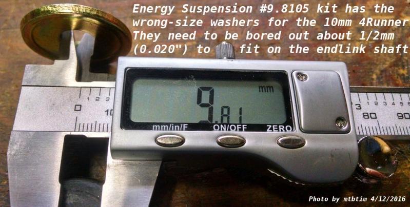

To keep the information together, so that others have the information we have, mtbtim and DK327 are testing out the Energy Suspension 9.8105 kit and they are finding that the steel washers that come with the kit have the wrong inner diameter for the 3rd-Gen 4runner.
Those Energy Suspension washers fit over the machined threads of the endlink bushings , but not over the unmachined section of the 10mm endlink bushings.
End result is that we can't recommend this kit either, unless you bore out the endlink bushings about twenty thousandths (1/2 mm).
Well, now I know why you had a problem with those washers from the Energy Suspension Kit 9.8105. The diameter of the hole is only 9.8mm and the end link posts are 10mm wide. So, I gave you some bad information. I was told this kit fit well for our rigs, but maybe the person just meant the bushings and not the washers. The bushings are a good fit.
The reason why I was wondering why you had problems with the washers from the Energy Suspension Kit #9.8105 was because the washers that came with the kit I bought, Energy Suspension #8-5118, came from the same company and silly me to think they would have fit.
So, now I can't recommend anyone buy the 9.8105 kit unless they just want the bushings and not the washers.

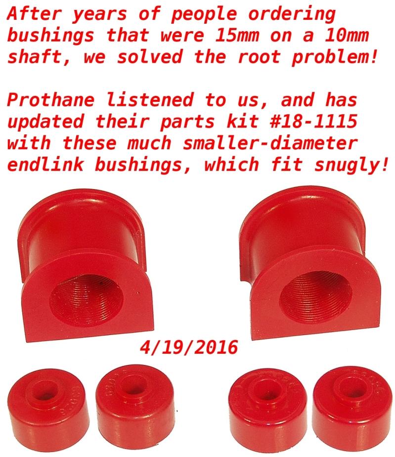

I came here to post some good news, which I put in the bushing-size thread:
- http://www.toyota-4runner.org/3rd-g...er-part-under-my-4runner-makes-noise-now.html
But I also repost it here so everyone will find it in the future when they search:
Just received an email from Dominick Luppino who is our technical support specialist at Prothane, who always cared about our problem, but who didn't hear from any users except me and mtbtim for over 5 years, so they simply assumed the parts were the right size.
Good news!
Despite the apologists here who repeatedly argued that 5 mm of ID slop on a 10mm shaft is perfectly normal (for them), the Prothane engineers listened to mtbtim's and my request, read the threads we forwarded to them, and then they did some research on their own, concluding the same thing mtbtim did, which is that all the stock 3rd-generation 4Runners have 26mm say bars and 10mm endlinks.
We're one step further ahead in our goal now!
Finally (after all these years of people repeatedly buying the wrong parts without solving the root problem), Prothane updated their parts kit today!
This is good news, as the main goal was so that nobody else had to go through the amount of effort we did just to get the right sway bar body and endlink bushings for the 3rd-gen 4Runner.
Users might want to wait a while for the current inventory to be used up before ordering the Prothane bushings (letting someone else get the bad ones).
To continually add value so that others find the updated information easier than we did, here's the latest recommended parts kits:

[b]Prothane polyurethane:[/b] prothane.com +1-888-776-8426 (Dominick)  dominick at prothane dot com
- Prothane kit #18-1115 (Be careful to buy only NEW STOCK as the old endlink bushings designed prior to April 19, 2016 are a loose fit at a measured 15.04mm ID on a 10.0 mm shaft)

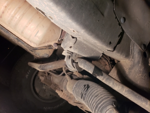

My sway bar end links look to be original and are toast. I was looking at all the various options and weighing aftermarket vs. trying to put together an OEM parts list. The early portion of this thread had me thinking that the sizes we're off, but now it sounds like that has been corrected.
Anyone have input on what they went with, how they like them, and if they'd go the same route again.
Thanks @foo and [MENTION=120071]mtbtim[/MENTION] for putting a lot of your energy into this tread!
