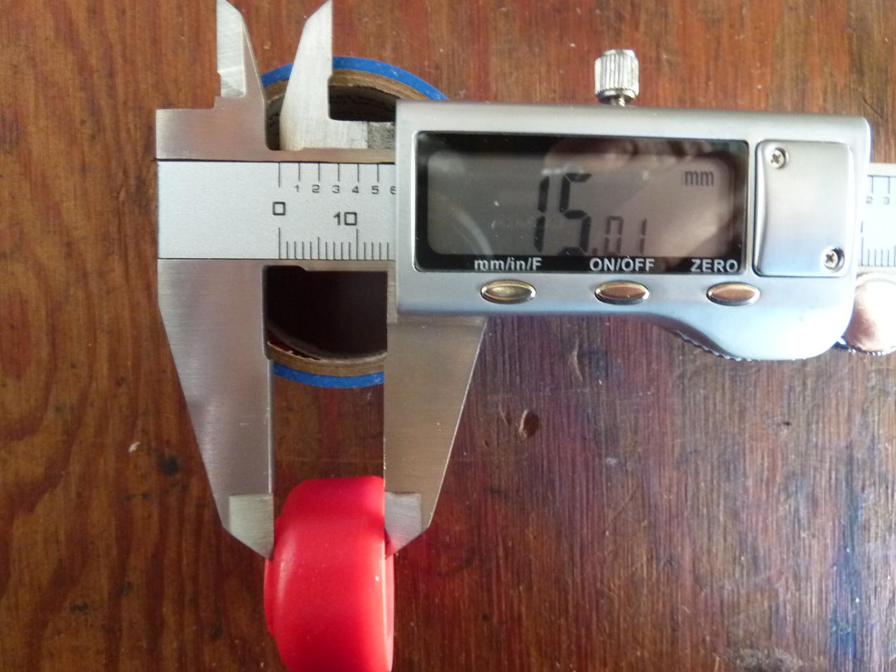

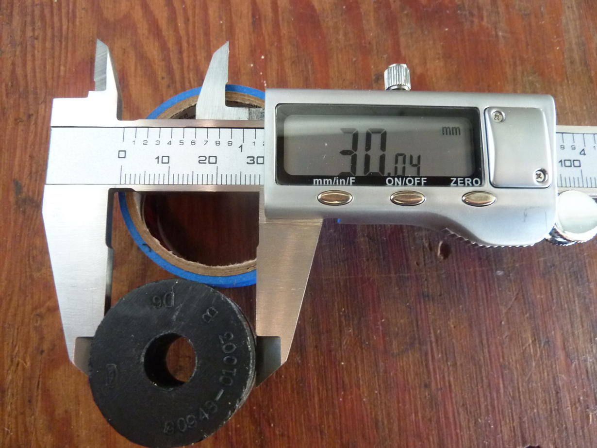

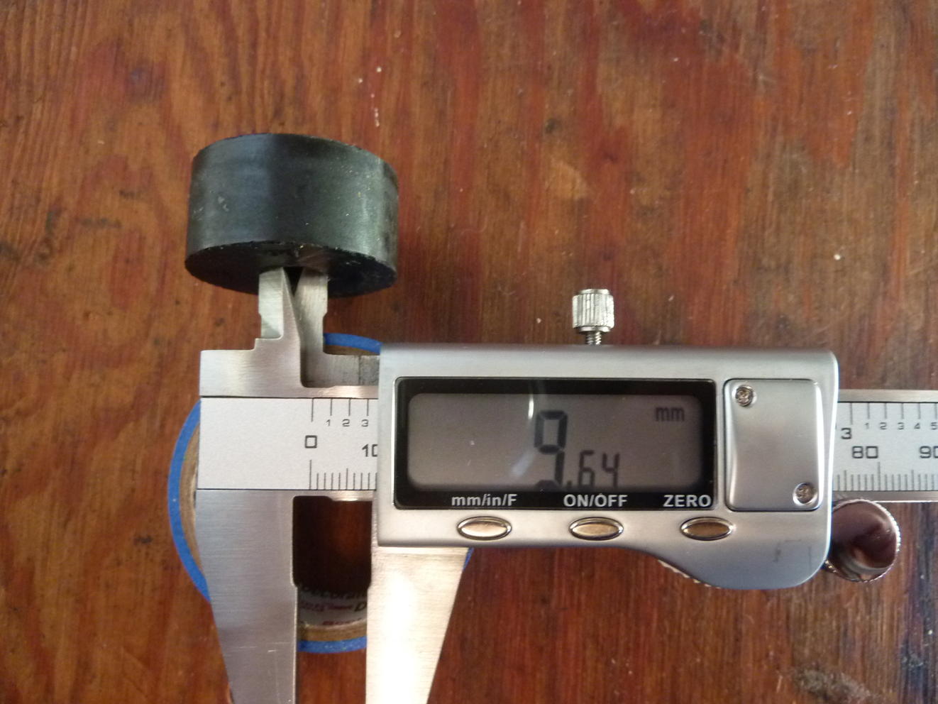

The following three pics show the measurements for the OEM end link bushings.

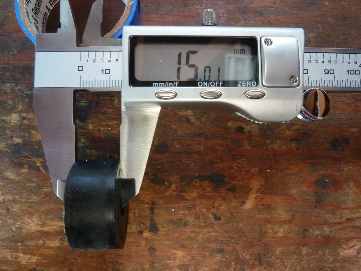

The next three pics show the measurements of the bushings from the Energy Suspension kit #8.5118

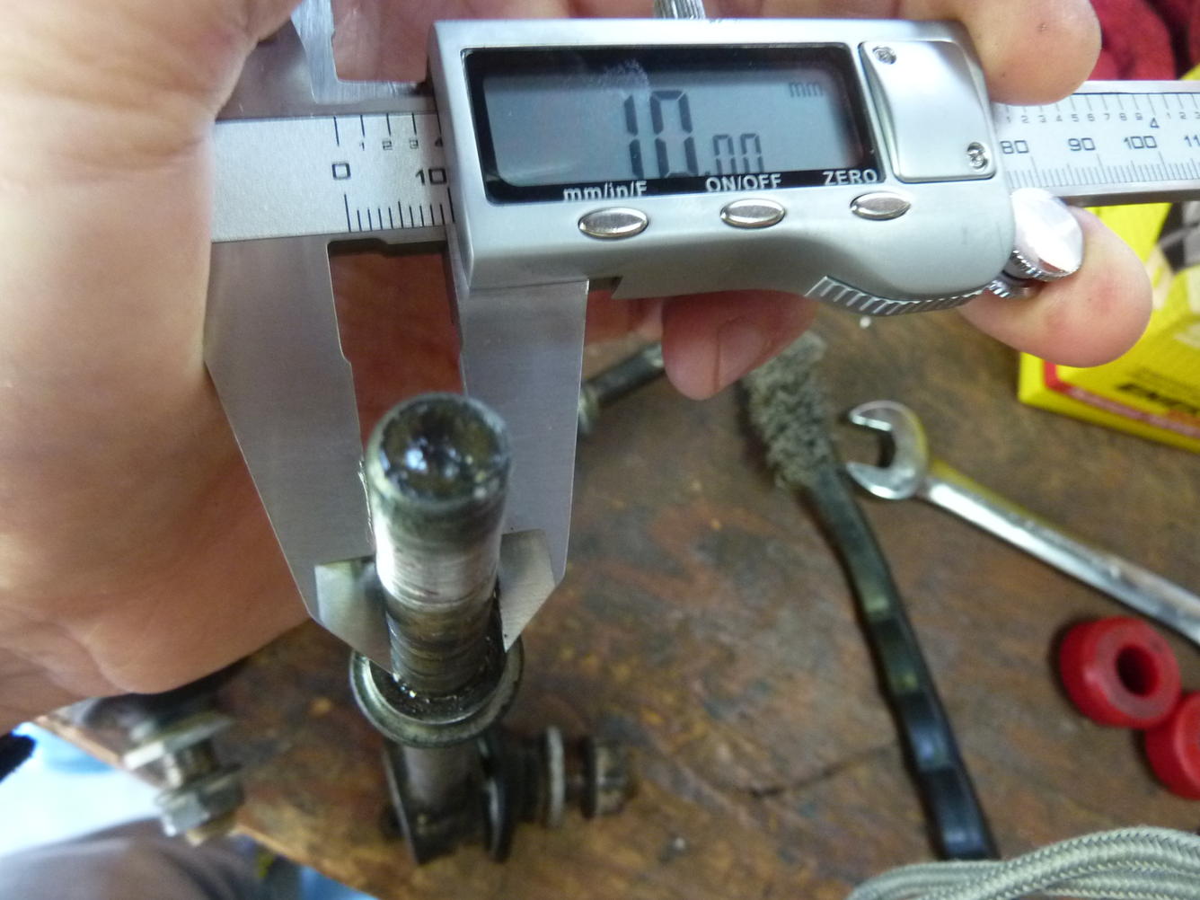

And here's a picture showing the diameter of the end link post.

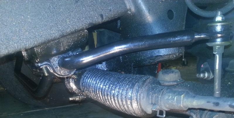

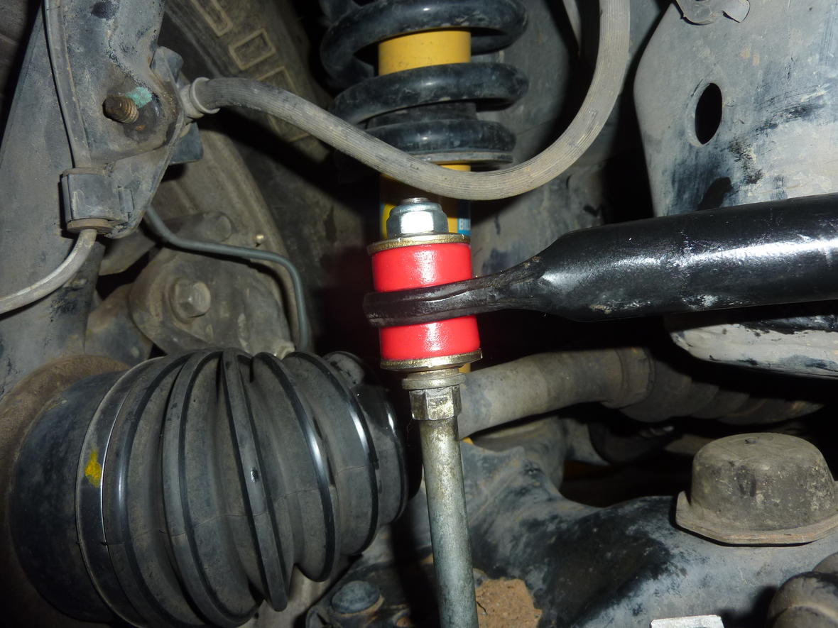

This is what the new bushings look like installed on the truck.

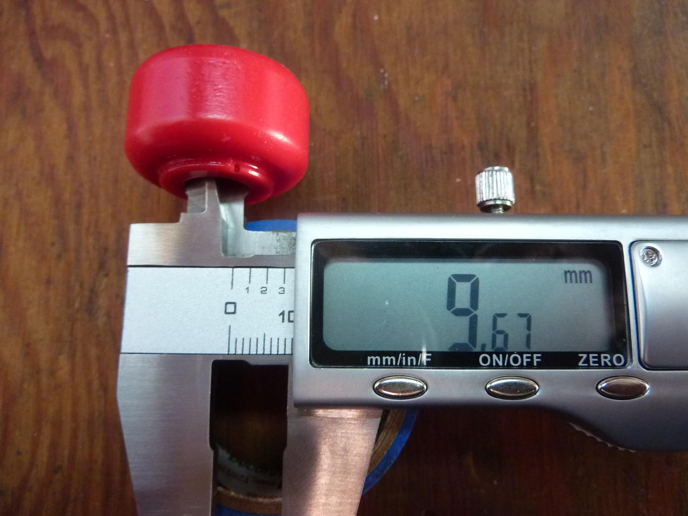

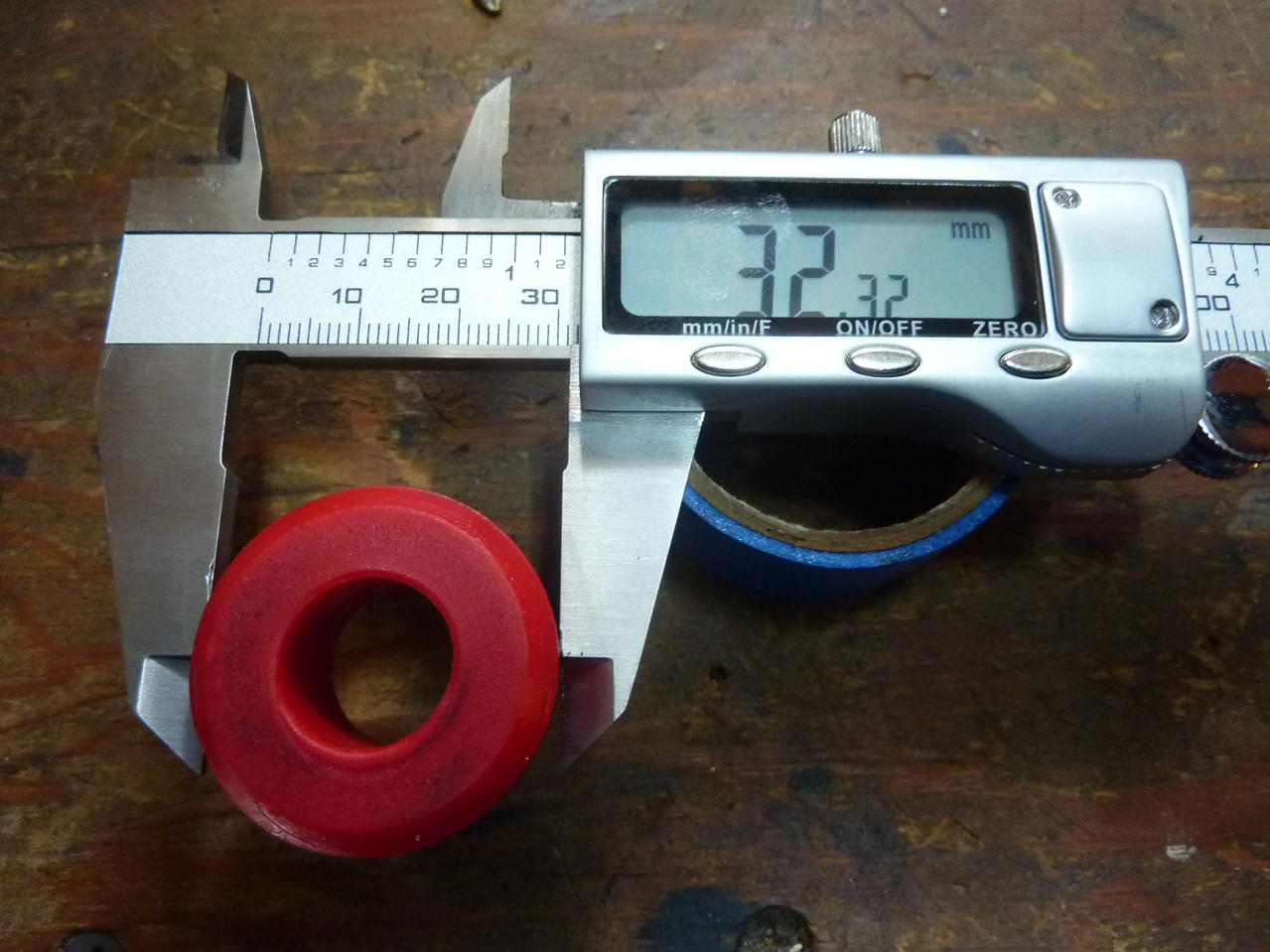

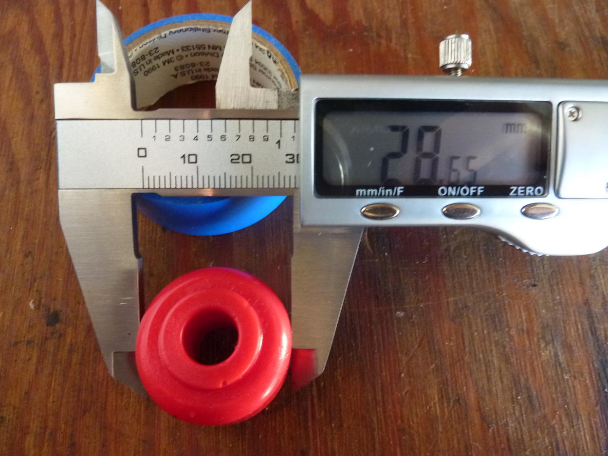

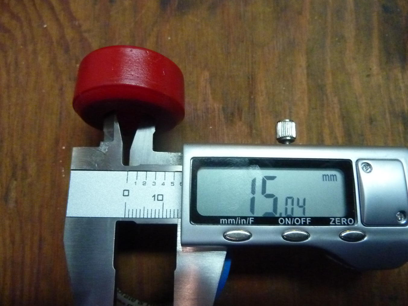

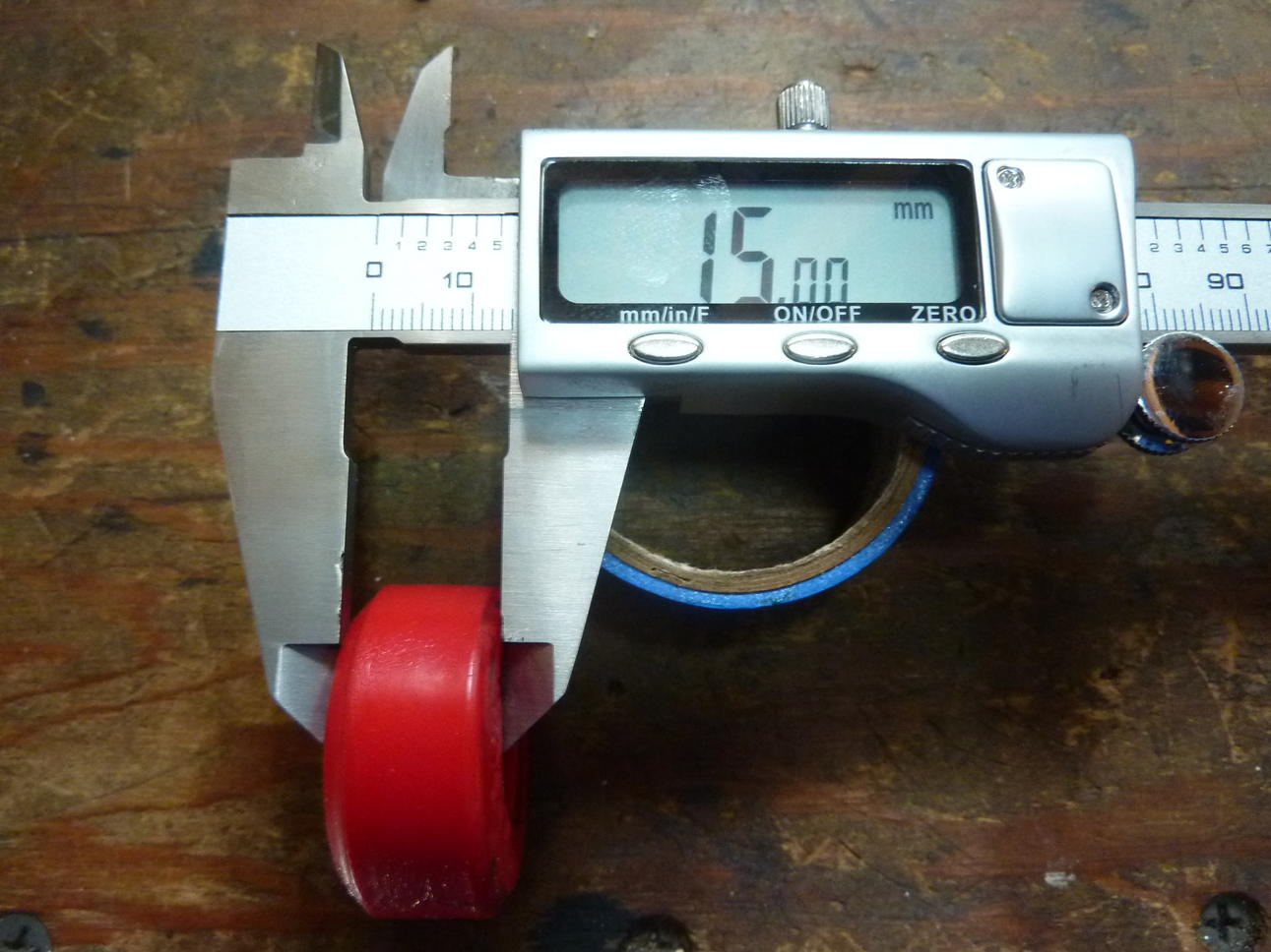

As promised, here is the pics of the end link bushings from the Prothane kit #18-1115. If you compare the inner diameter measurement from these with the OEM and Energy Suspension kit #8.5118, you can see how poor of a fit these are. Basically a 5mm difference with results in a VERY sloppy fit on the end link post.
Here's the pics of the measurements.
I will be submitting all this information to Prothane and Energy Suspension in hopes that they will put together correct bushing kits for our rigs so future 3rd Gen owners get the right bushings the first time.

Using calipers, I measured the midpoint diameters to be:
1. Sway bar midpoint diameter was 1.042 inches (roughly 26.5mm)
2. Endlink bar midpoint diameter was 0.395 inches (roughly 10.0mm)
Note: My swaybar diameter corresponds roughly midway between 26 & 27 mm, where 27mm = 1.063 inches & where 26mm = 1.024 inches.
If we assume the bushing is 20 thousandths smaller, then:
a. The Prothane 26mm bushing should be something like 1.024 inches - 0.020 = 1.004 inches
b. The Energy Suspension 27mm bushing should be something like 1.063 inches - 0.020 = 1.043 inches
It may be useful to note that I measured the swaybar to be about 20 thousandths of an inch smaller (0.5mm) at the actual bushing contact point, which I presume is due to the heating and stretching that occurred during the manufacturing process, since the cleaned up swaybar was in pristine shape with respect to the original paint (zero rust, for example).
The unpainted endlink metal under the bushing contact area was much rougher than was the smoother swaybar metal, and therefore the endlink diameter measurement at the bushing contact area was less accurate, but it was about 20 thousandths larger, which I attributed to the crud which I didn't bother to clean up.

-I reused my endlink washers on the front.
-The endlink bushings were a tight fit on the front. I forced them on with light taps from a hammer using another bushing as a buffer to avoid hitting the end link.
I'll post more if I remember anything else. Cheers! :thumb:
This video is great despite what this thread devolved into. I used it to swap my steering rack bushings. I also did front and rear sway bar and endlink bushings. Dollar for dollar, swapping these bushings was probably the best upgrade I have done.
I used all energy suspension parts off of amazon. Here is my part list if anyone wants to do it this:
Energy Suspension 8.10103G Rack and Pinion Bushing Set for 4WD
Energy Suspension 9.5156G 3/4" Greasable Sway Bar Set
Energy Suspension 9.5161G 1" Greasable Sway Bar Set
Energy Suspension 9.8105G End Link Grommet
I also used some spare nuts, bolts, and washers for the front sway bar brackets.
For grease, I used "green grease" from Autozone (make sure to use synthetic grease).
Notes:
-One problem I ran into was that the slots on the rear sway bar bushing brackets weren't close together enough that the bolts fit easily. So if you get this set, either have a dremel/file ready or be prepared to struggle threading the bolt on the rear bracket.
-The washers that come with the sway bar bushings are not very wide, I would recommend using different ones for the front. For the rear, a bigger washer interferes with the ability to thread the bolt.
-You don't need the Honda adapter set in the video. I only used the ball joint press and the medium sized 4wd adapter.
-Autozone rents out a tie rod end puller that is less likely to damage your tie rod end boot: part# 27276

You're right about the Honda adapter set and we should have mentioned that in our video at the end that we didn't need it after all. At the time, it seemed better to have more tools than less so we didn't have to make another trip if we didn't have the right size adapter.
I thought the washers on my Energy Suspension kit where a little narrow too and I was thinking of reusing my OEM end link washers because of it. But, if you don't tighten the bushings down too much causing them to bulge a lot, I think the washers they provide work ok. I did keep my OEM washers though if I ever decided to go back. It was a fairly tight fit with the bushings but there was enough post coming through to get the nuts started. When I had my bushings tightened down to where there was a slight bulge in the bushing, their was 2-3 threads showing above the nut.
When I finally got some end link bushings that fit properly, I found my driver side end link had some rough threads so I bought a metric tap and die set at Harbor freight for $16 to clean up the threads. Then I went to ace hardware and bought some new lock nuts. By the way, the end link posts are 10mm with a 1.25 thread pitch.
Glad you found the video helpful.
With the suspension unloaded, and the new bushings on, catching the first few threads with the 10x1.25 nut took a bit of force. Your suggestion in the video to let the truck down to complete the tightening task was a good one.
It is important to note that the metal washers are what centers the endlinks, so, they take a beating. I would recommend new washers at all times, especially if the old washer holes were oblong (as mine were).
I didn't have washers so, I put the old ones back, but had I known what I know now, I would have ordered new washers.
If we can get the Daystar or Energy Suspensions kit to just come with washers, that would be best.
I think Prothane's kit can't be recommended at all, at least not until they get their act together on the endlink bushing dimensions.
PS: I haven't heard from Domenick in the past couple of days.
Have you?
Have you?
I emailed them with the link to the thread on Friday so they could have the measurement information I provided and discoveries from talking to the parts guys at my local Toyota Dealership. So, I don't think I'll hear anything back from either Dominick at Prothane or Greg at Energy Suspension until some time this week.
The kit I bought, Energy Suspension 8.5118 did come with 4 washers. I agree it would be nice if these kits all came with new washers since there's a good chance people will need them especially in the rust belt of the country.
I would never recommend anyone buy the Prothane 18-1115 kit unless they change it and put correct fitting end link bushings in it.
I have a good feeling that these companies will do something about it and get an accurate kit put together soon. At least I hope they do after all the time we put into it.

While you and I have solved "our" problem (by getting the right-sized parts) and you figured out that all the stock 3rd-gen front swaybars are 26mm and all the endlinks are 10mm, it would be too bad if people are still getting improperly fitting parts today since this is easy math for the three most common folks who make the bushings:
How does this look for a summary recommendation for to make it easier for others than it was for us?
Code:
[b]Toyota OEM buna:[/b] (same size for all 3rd-gen 4Runners, 2WD & 4WD)
- Toyota 10mm ID Endlink bushings (Part #90948-01003)
- Toyota 26mm ID swaybar body bushings (#48815-35100)
Code:
[b]Daystar polyurethane:[/b] daystarweb.com +1-800-595-7659 tech at daystarweb dot com
- Daystar DAY MO3464 Body Bushing ID = 1.045 inches (26.5mm)
- Daystar DAY MO2233 End Link Bushing ID = 0.395 inches (10.0mm)
Code:
[b]Energy Suspensions polyurethane:[/b] energysuspension.com +1-888-913-6374 (Dave)  dlewis @ energysuspension dot com
- Energy Suspensions kit 8.5141{R,G}, endlink bushing ID = 9.64mm, swaybar body bushing ID ~= 26mm <=== do we have an accurate measurement yet?
- [s]Energy Suspensions kit 8.5118{R,G}[/s] (Do not buy this kit as the swaybar body bushings are a bad fit at over 27 mm)
Code:
[b]Prothane polyurethane:[/b] prothane.com +1-888-776-8426 (Dominick)  dominick at prothane dot com
- [s]Prothane kit #18-1115[/s] (Do not buy this kit as the endlink bushings are a bad fit at 15.04mm ID)
