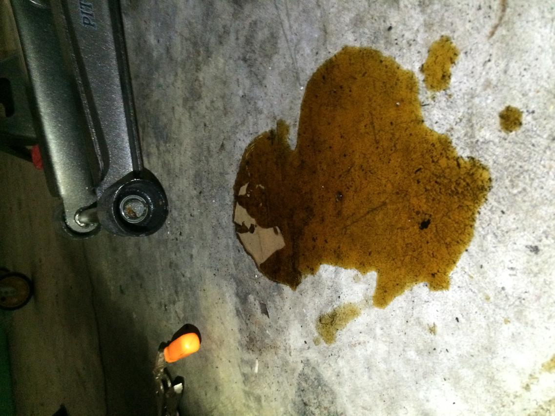

It was dark brown and maybe a slight bit reddish. It smelled like oil but was pretty watery. There is a pic below that came from the passenger side. The drivers side had less but seemed to be thicker.
I didn't see any holes or tears but there was a lot of old grease on the rack and on the boots closest to the rack. The inners were completely shot and I'm assuming they were original. I replaced the boots anyway but am concerned that if the leak is coming from the rack, it will mess up my expensive new inners.
