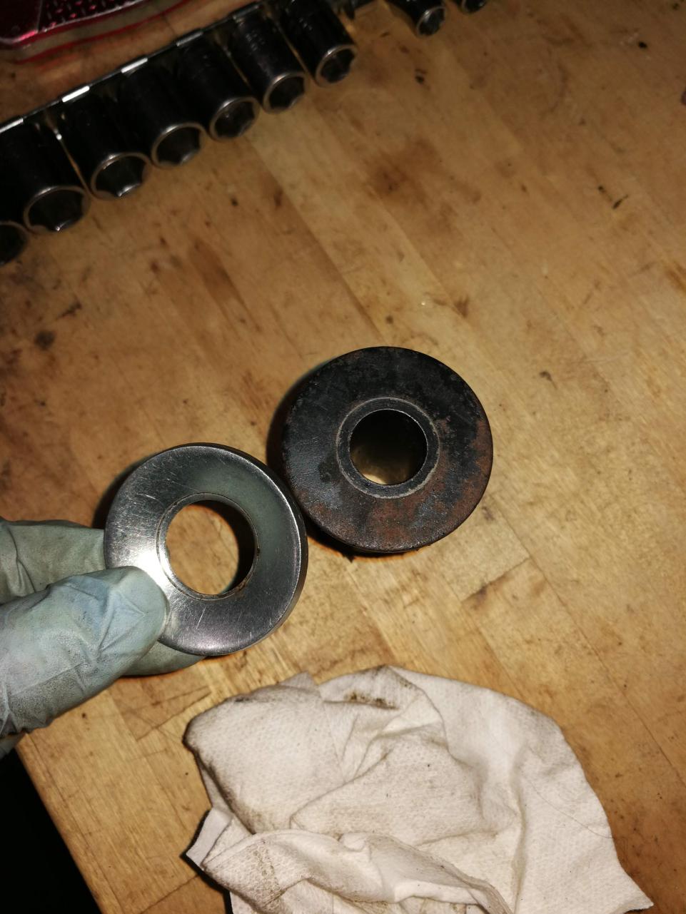

I decided to go with the bushing kit from Whiteline (PN W12978), and could not get the fastener that's furthest outboard on the driver's side of the rack to the FSM specified 141 ft/lb of torque. I kept going and going, but decided to stop, rip everything out, and diagnose the issue. Once I had the rack back off the frame I was able to pull out the bushing for that fastener and discovered that the inner sleeve and washer had completely failed. The washer was collapsing out over the small "nipple" that protrudes from the frame, and the sleeve had begun to collapse and form a ridge similar to a hardline on a fuel or vacuum line. I did contact Whiteline, and they're going to send me replacement parts, but I'm certain the new part will probably be unable to withstand that torque spec as well.

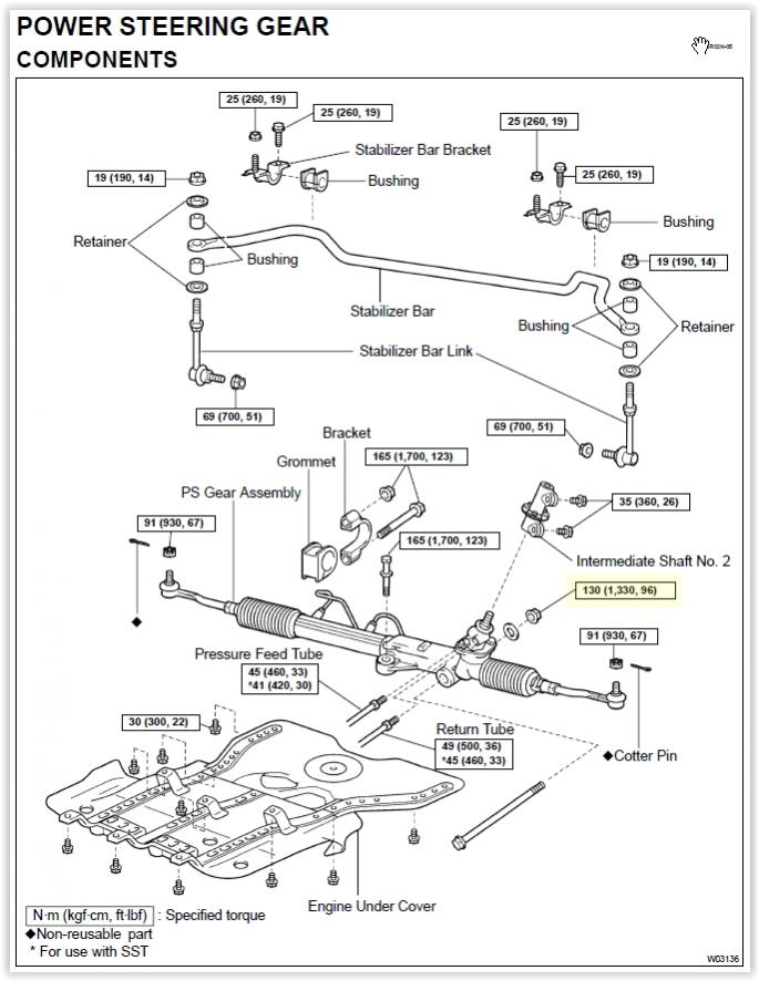

To me the real interesting thing I've found, and wanted to share, is that the FSM has conflicting information on the torque spec for that fastener. It lists 141 ft/lb in a table describing that particular fastener (SS-40 page 169) along with that spec showing in the reassembly procedure for the front lower suspension arm (SA-63 page 1233). This is also the spec I've seen in all videos and write ups, and I've used it myself, without incident, on my previous 01 4runner. However, because I had this issue I decided to look further into the FSM, and sure enough I found a conflict. Specifically if you turn to the section where it has the reassembly instructions for the steering rack, it says the torque spec on that fastener is 96 ft / lb (SR-42 page 1400 and SR-60 page 1418).

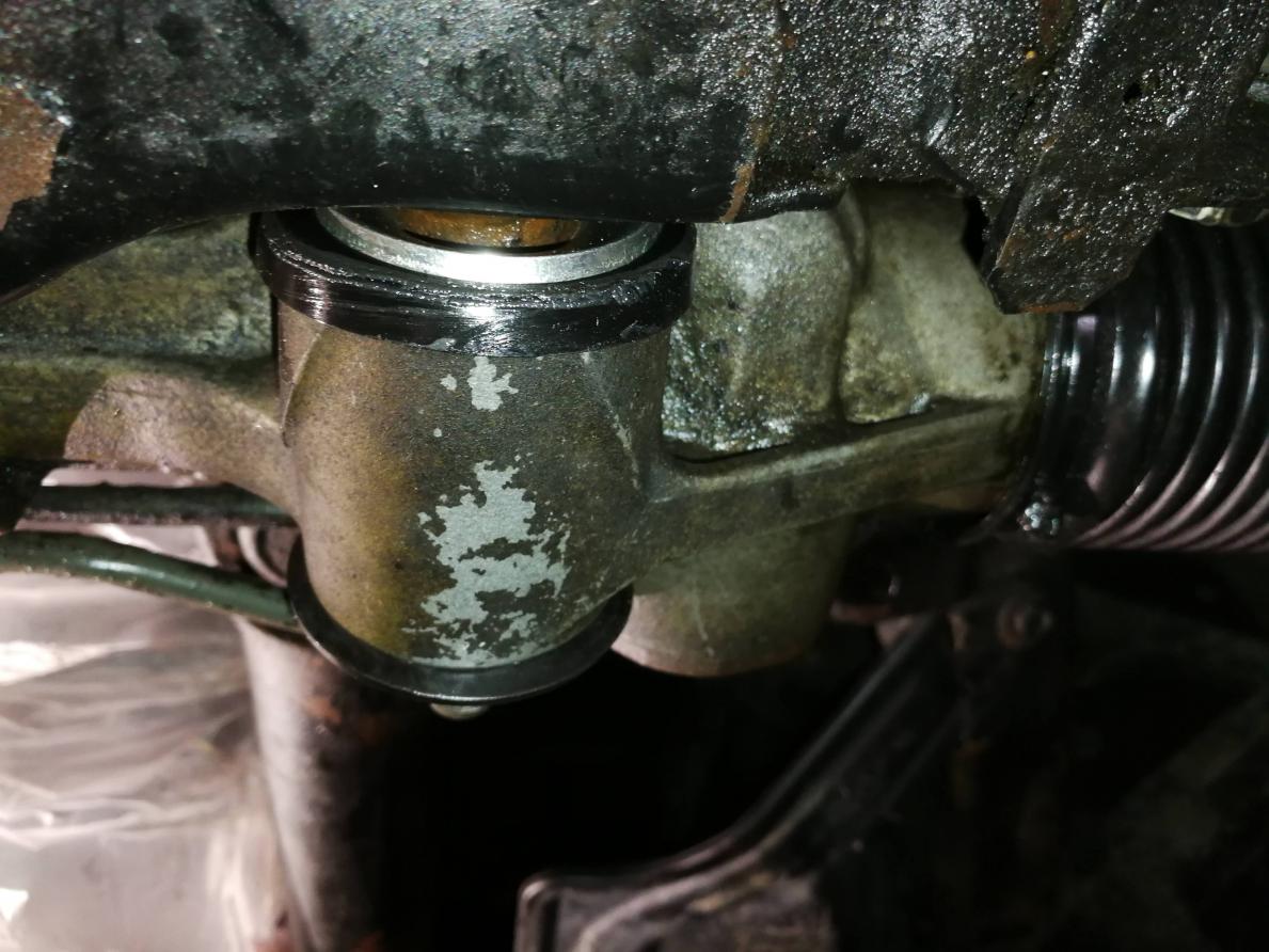

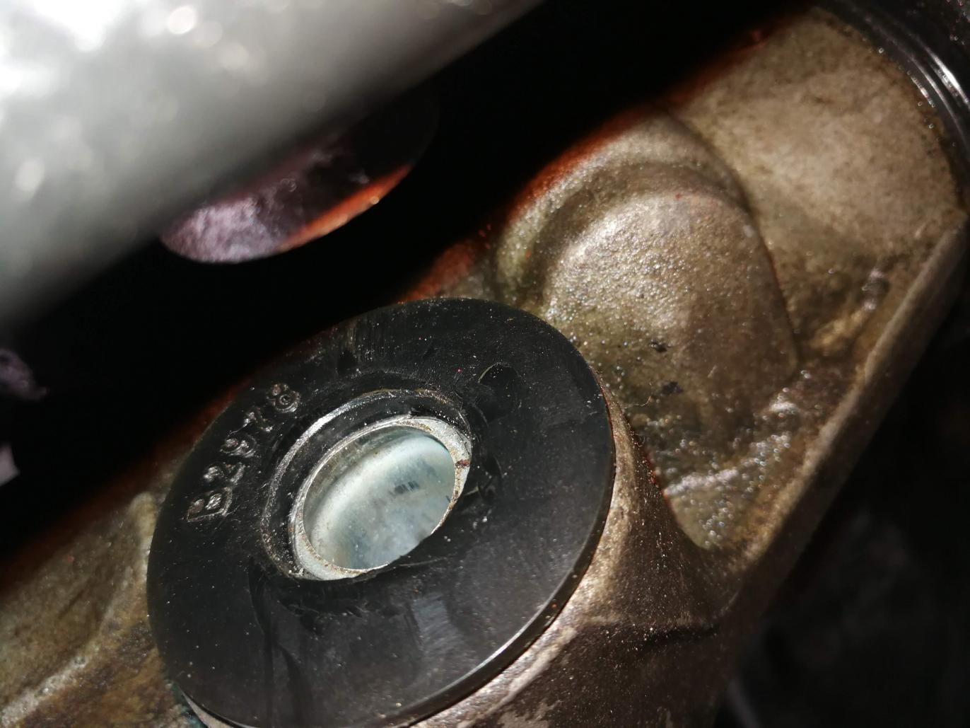

This is what happened when I tried torquing it to 141ft/lbs. Bent the washer and crimped the inner sleeve. I knew something was wrong because it definitely did not require that much force to take it off. I ended up having to buy another bushing kit from Whiteline. I think I ended up torquing it to 120ft/lb. I didn't really feel that much of an improvement, so I don't think it was worth it. The original bushings were still fine at 240,000 miles....I only did the bushings because I was replacing the steering rack hydraulic lines.

Thanks for sharing this. This is not the first time a discrepancy like this have been found in the FSM. In my 2000 FSM, the same part diagram you showed has the torque value as 151 ft-lbs. Then, in the step by step pages of putting the steering rack on the vehicle, it specifies the spec as 141 ft-lbs and that's the spec we share in the video for that nut. With the other bolts at 123 ft-lbs, it's not a stretch to believe that big nut has a spec of 141 ft-lbs. Actually, 96 ft-lbs seems a little light for that size of a fastener.
