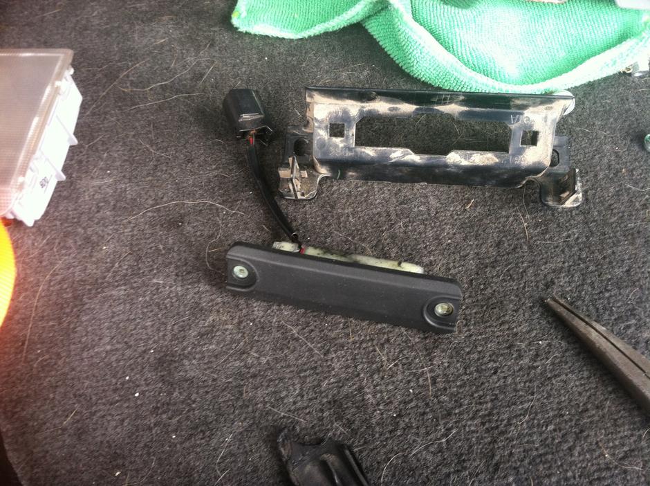

Pulled off my rear valance and changed only the rubber cover, took about an hour with alcohol to clean all the clingons off.
Did you get a new Toyota rubber pad or have you found an alternative part supplier? It'd be nice to know for other members as usually if you catch it early the rubber is all that needs to be replaced. Usually you have to replace the entire switch assembly which is expensive and in most cases the switch portion is still good.

Yeah mine was in terrible shape, I'm still trying to get the black stuff off my hands. I used a aftermarket rubber cover found on amazon
https://www.amazon.com/gp/product/B...rd_wg=xEnJM&psc=1&refRID=5E5EXFC3ESXNDA6WFEH5
Fit perfectly over switch housing after lots of cleaning of old residue.
The switch itself is a plastic housing with a plastic bar to actuate a micro-switch at the bottom. The only time I've really seen them fail is when the switch housing is just so gummed up it bends the switch arm and/or quits traveling properly.
