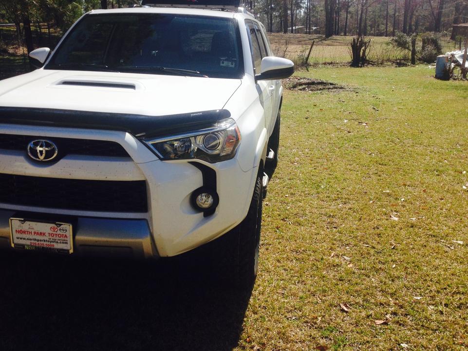

Seems I read somewhere in here that anything over 5" of total backspacing would get into clearance problems with the struts and springs. I mounted 17x8's with 4 1/2" backspace on mine, and with stock size tires I have a rub on the left front in reverse at full lock to the right. But mine will obviously go away with the front fender mod once I do it. And I do like the way it pushed the sidewall out into the flares more.

Thanks, that pic helps a bit. But I would have 1 more inch of rim width that would divided between a little more backspace and a good bit more outside width. Hmmm The thought process continues.

In all honesty when I ordered those Black Rock wheels I thought I was getting 17x9's (oldfartedness kicking in). In hindsight and re-reading your first couple posts I realize I only gained 1/2" in total width on the wheels. But with the 4.5" backspace it was overall moved OUT a total of 7/8" (.875), or 1 3/4" across each axle. So visually it looks a lot wider than it did before. I can tell you on mine there is still about 1 1/4" available before the sidewall is even with the top outer edge of my flares. But I wasn't actually going for that much change. I still wanted most of my tread to be enclosed in the main fender. And just that 7/8" gained did cause me to have a rub on the left front. So after all was said and done I'm happy I only got the 8" wide wheels. Obviously your project may have different requirements. I'm just telling you my actual experience. :becky:
