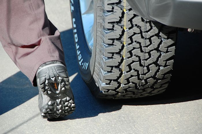

Oh yeah - forgot to mention that if part of your motivation is to have tires that look a bit more aggressive than the stockers - apart from the obvious practical benefits - the BFG A/T KO's are a lot beefier looking than the stock weenie looking Bridgestones - same tire size, but a lot wider and luggier. At first I thought they had mistakenly mounted 285's.
Here's a pic that might give you an idea - new tires and new hiking boots for the wife all on the same day. Pretty exciting stuff:
