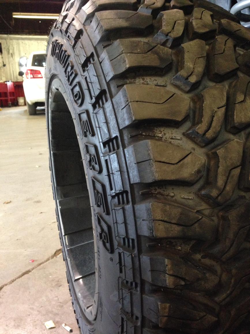

Any one have this combo? I am about to purchase a set but want to avoid this appearance:
Not sure if you guys can really see it in the pic but the rim seems way too wide for this particular tire. The size in pic isn't relevant, only trying to show what I want to avoid. I am not looking at purchasing the pictured rim or tire.
Please post a pic and your comments if you have this titled combo.
Thanks in advance!

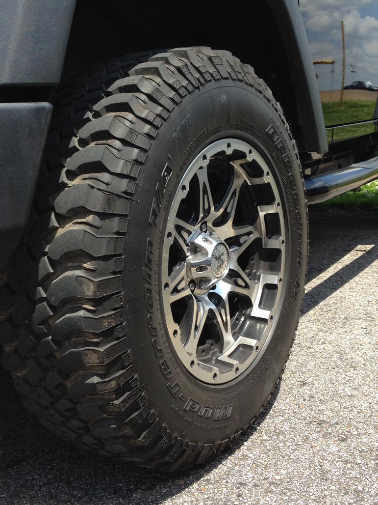

i have 265-70s on my 17x9's and haven't really noticed it looking like that. im not that picky anyway. will have to look in the daylight tomorrow to see if i can really notice it
I had a quick look at ur build page and that definitely has more bulge midway in the sidewall (which is what I want) rather than at the rim. Know the offset of ur rims?
Now that you mention it I now notice it haha never really bothered me before
But the rim specs are an offset of -6 and a backspacing of 4.75
