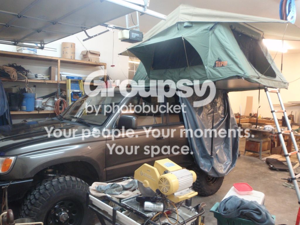

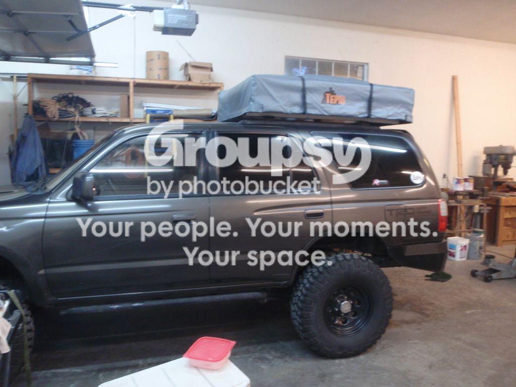

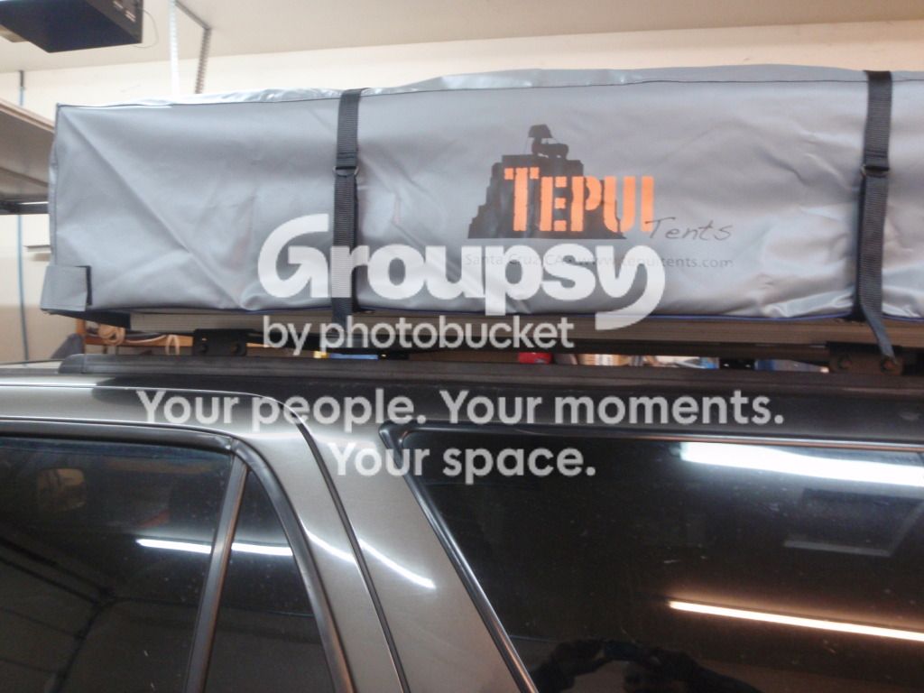

Yesterday I drove to Santa Cruz to pick up my new Tepui Kukenam rooftop tent. I'm pretty stoked on it, now I won't have to worry about where to sleep on my upcoming trip.
It's mounted to Defender rack mounts, which makes it sit really close to the roof as you can see, which is nice.
PA100582.jpg~original
PA100581.jpg~original
PA100585.jpg~original
PA100586.jpg~original

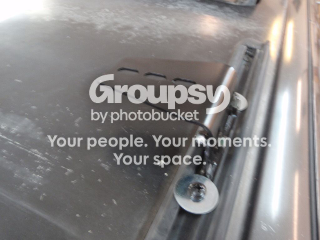

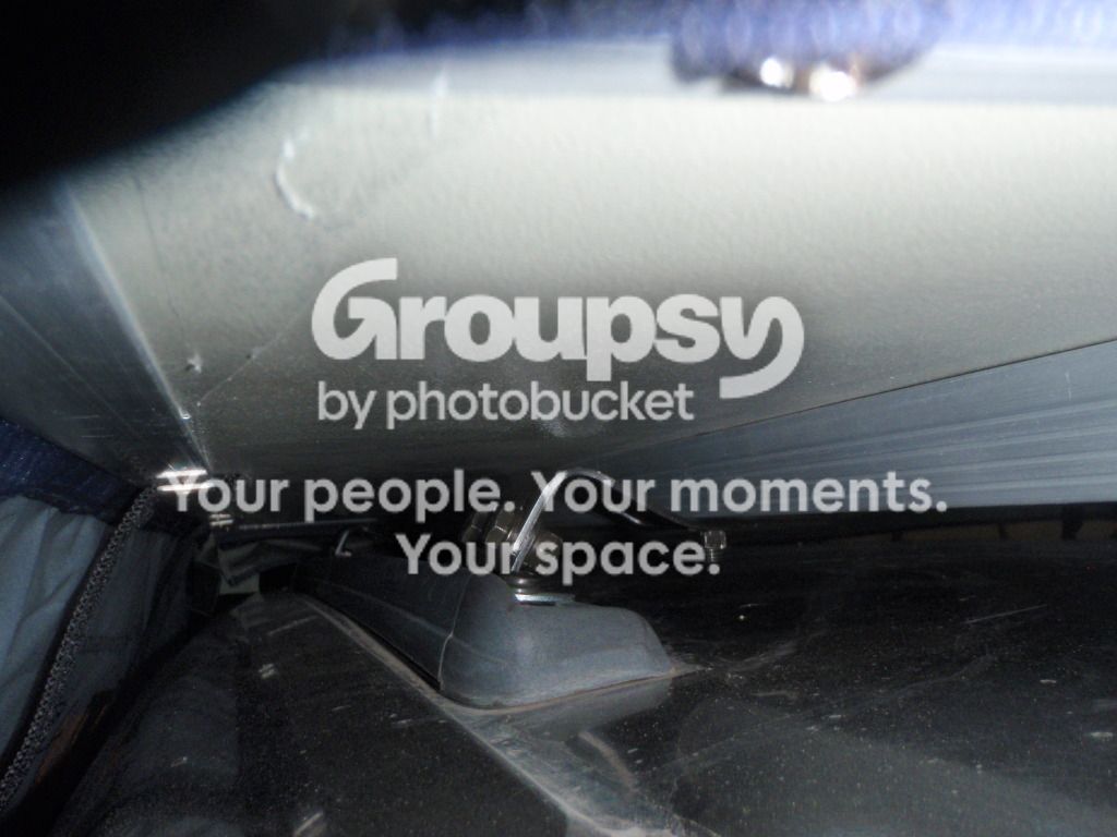

Here are the mounts. Others have said only 4 will do the job, But obviously they must weigh 100 pounds because the mounts don't like my 185 pound self. I'm ordering 6 more, so there will be 3 more on each side before I actually try to stay overnight in it.
PA080576.jpg~original
PA100589.jpg~original
So far I'm really happy with it, I don't even know it's up there on the highway except for my gas mileage going down a bit.
Hello OP,
I was getting ideas on the mounts for RTTs and yours maybe a good option because it will have the lowest profile. I wanted to know where you bought the Defender Rack Mounts. Also, the last picture looked like the brackets are bent, whereas the photo before it looks they where in 90 degree angle.
The mounts are for a Defender roof rack, I ordered mine through 4wheel parts. The part number for 4 mounts are DS2-4. I'm guessing the part number for 8 would be DS2-8. If you call 4wheel parts to order them, just tell them you want to order the Defender rack mounts for a 4runner, and tell them you want 8 and they should do all the ordering work for you.
And you are correct, in one of the pics the mounts are bent badly. This is because originally I only ordered 4 mounts, 2 for each side. This was not enough to support the tent with me in it, and the mounts bent. I then ordered 4 more mounts so I would have 4 on each side. After bending the old mounts back into shape, they hold up beautifully now. I would not go less than 8 mounts.
These mounts definitely do have the lowest profile than any other I have seen for a RTT. The one downside is it is a complete PITA to install, because you only have a few inches to work with between the bottom of the tent and the roof. Trying to install the nuts in that space to bolt down the tent is really irritating. Hope this helps you out!

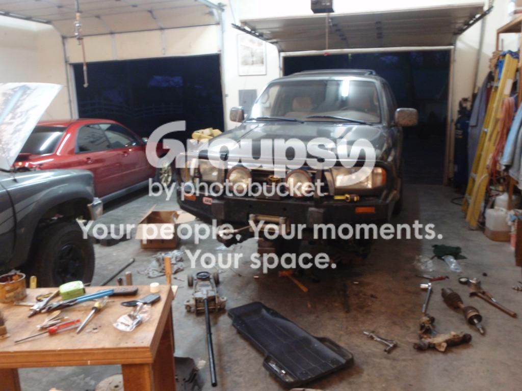

My front LCA bushings were completely shot, so instead of dealing with putting in new poly or factory bushings I got some complete used LCA's for cheap. After removing the old ones and inspecting the bushings, there was no question where my hard pull came from when braking. There was hardly any bushing left in there, the metal sleeve was free to slop around in it's housing. Replaced with the new LCA's and it rides nice and straight. Although my front wheel bearing's are shot and vibrate badly at about 50 mph, so I'll be replacing those with some used spindles with good bearings. My spindles are tweaked anyway from a bad night at pismo, so I'll kill two birds with one stone on that one.
No shots of the bad bushings, but here's one of everything torn down.

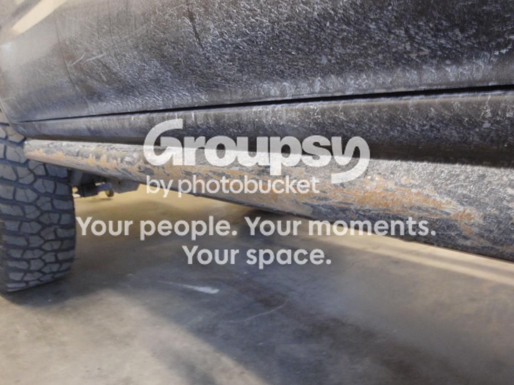

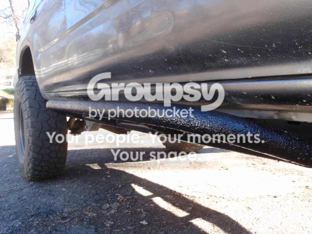

I also put new Herculiner on my sliders. They haven't been touched up in about 2 years, and all the wheeling and scraping on rocks made bare metal show through and rust start.
Before
P1301024_zpse8bcd4fd.jpg~original
After
P1311025_zpsce88f548.jpg~original

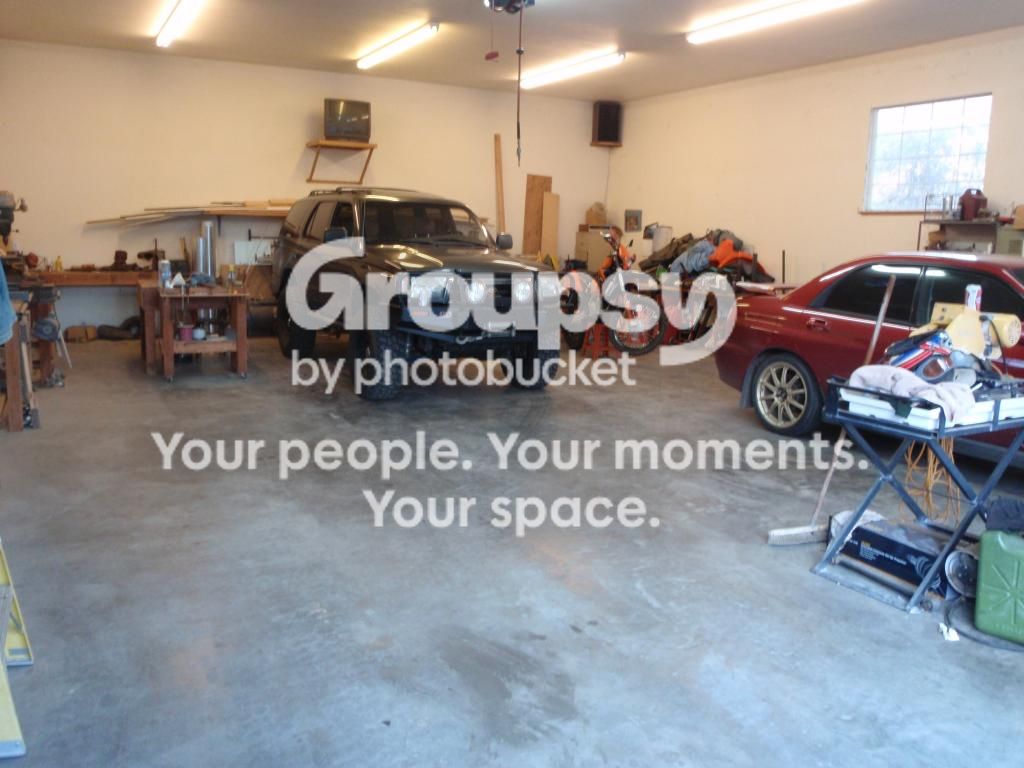

In other news, I rearranged stuff in the shop so there's much more room. Could fit at least 4 vehicles in there now, and is great just for the extra room for working.
P1301022_zps9c40baa3.jpg~original

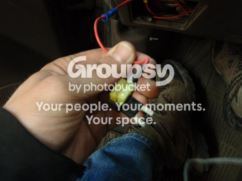

Finally figured out my RR DIFF light situation. I was having so many problems with it for some reason, I didn't know one little bulb could give me such a headache. Sometime's it wouldn't get power at all, sometimes it wouldn't ground out all the way and be really dim, and one time the light would come on when the rig was off, and off again when the rig was on. Super annoying.
Huge props to [MENTION=44220]BigFishAllDay[/MENTION] for helping me out with his electrical knowhow. He even talked to me on the phone at 1am to try to work me through it. Even though it's just a dumb light and I really don't need it, it's pretty cool that he took the time to help someone out that he's never met. Thanks again bud!
My problem was, like I said before, the locker was wired straight to the battery. For some reason it would ground only when the rig was off, and my light would come on. To fix this, I stole BFAD's idea of using an "add a circuit" to wire my switches hot lead to the fuse box under the dash. I just plug this into the 4wd fuse location, since it's only hot when the ignition is on. No more lights on when the rig is off!
I'll be using these in the future, I had no idea they existed.
P2101037_zpse8c937b8.jpg~original
2 lights on now for the locker, instead of just the one on the switch. Now if I hit the switch with my knee again and the locker comes on, I'll actually know about it because it's hard for me to see just the switch light in the middle of the day.
P2101030_zpsa40da10f.jpg~original
I can finally focus on other mods, now that this has finally been resolved.
