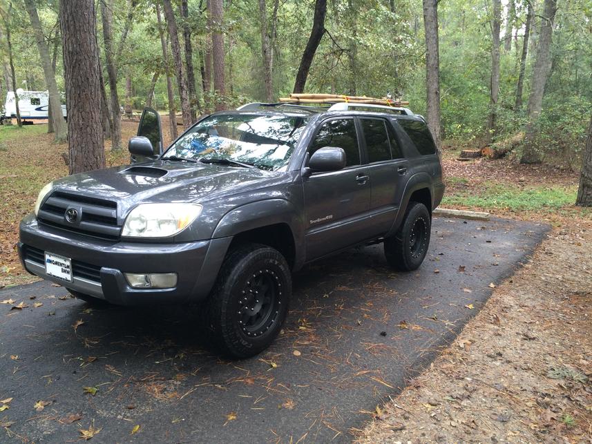

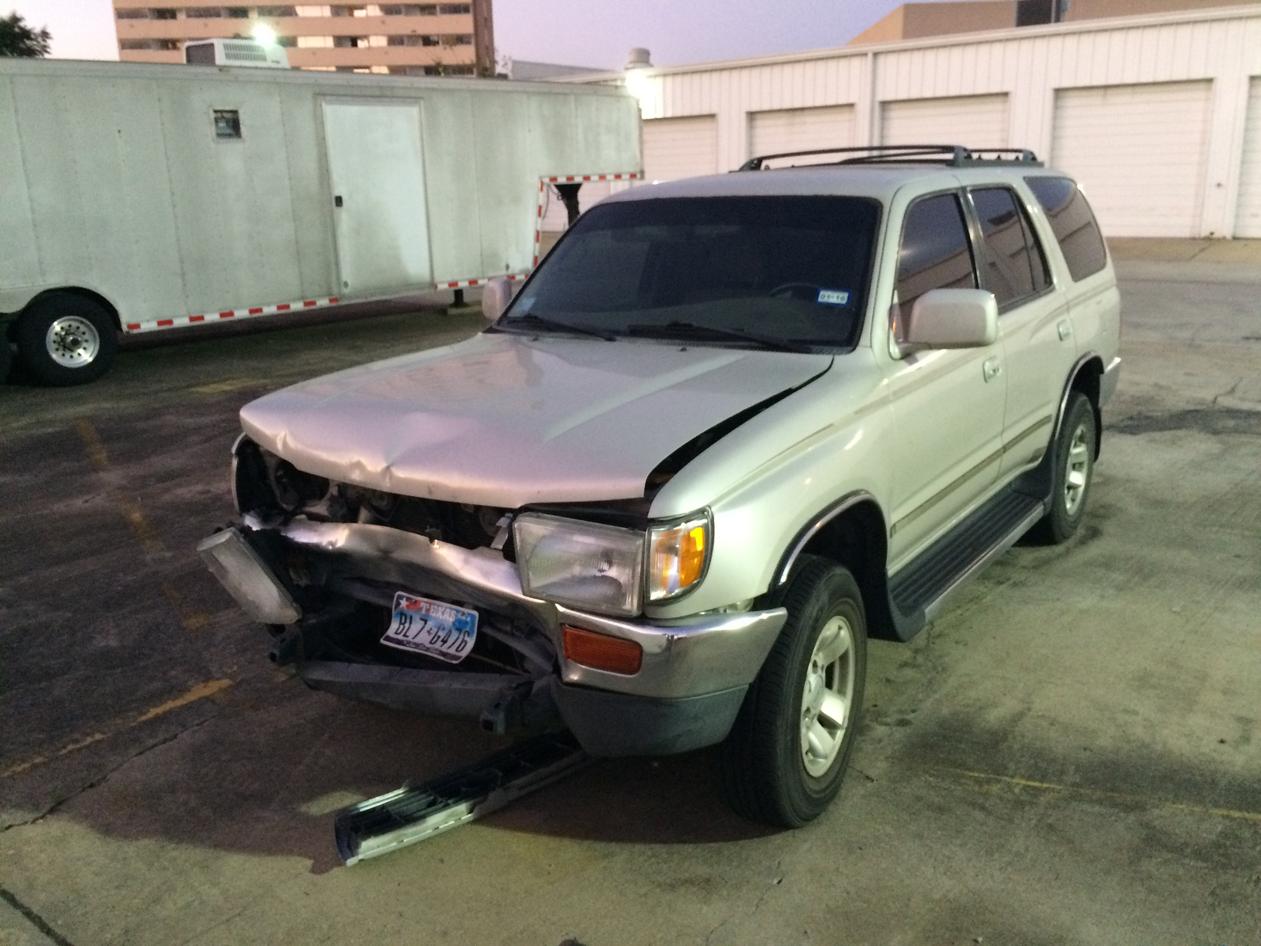

The first pic is my old rig after the accident.

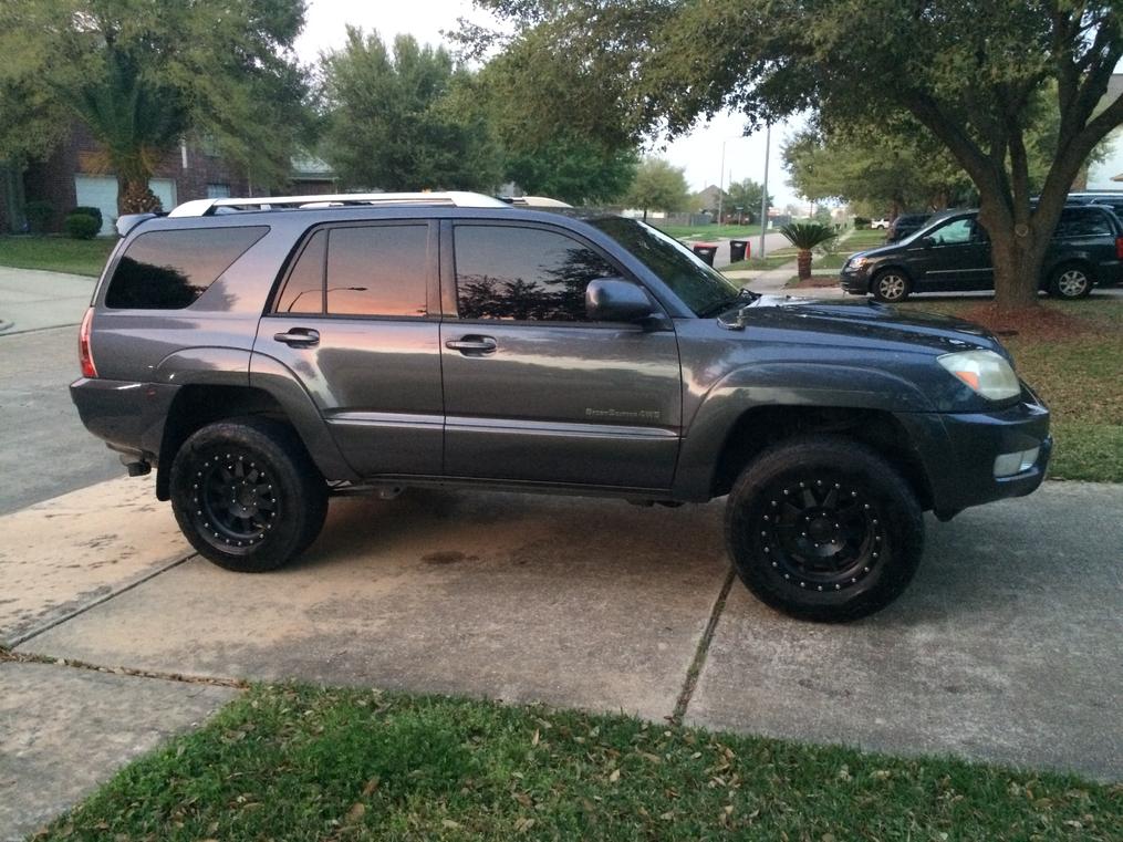

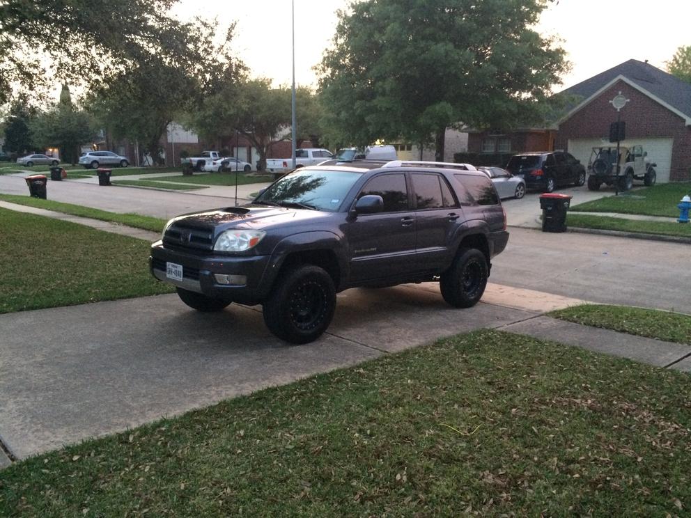

The second pic is my new rig the day after I bought her.

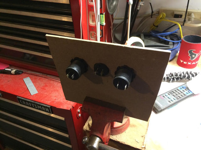

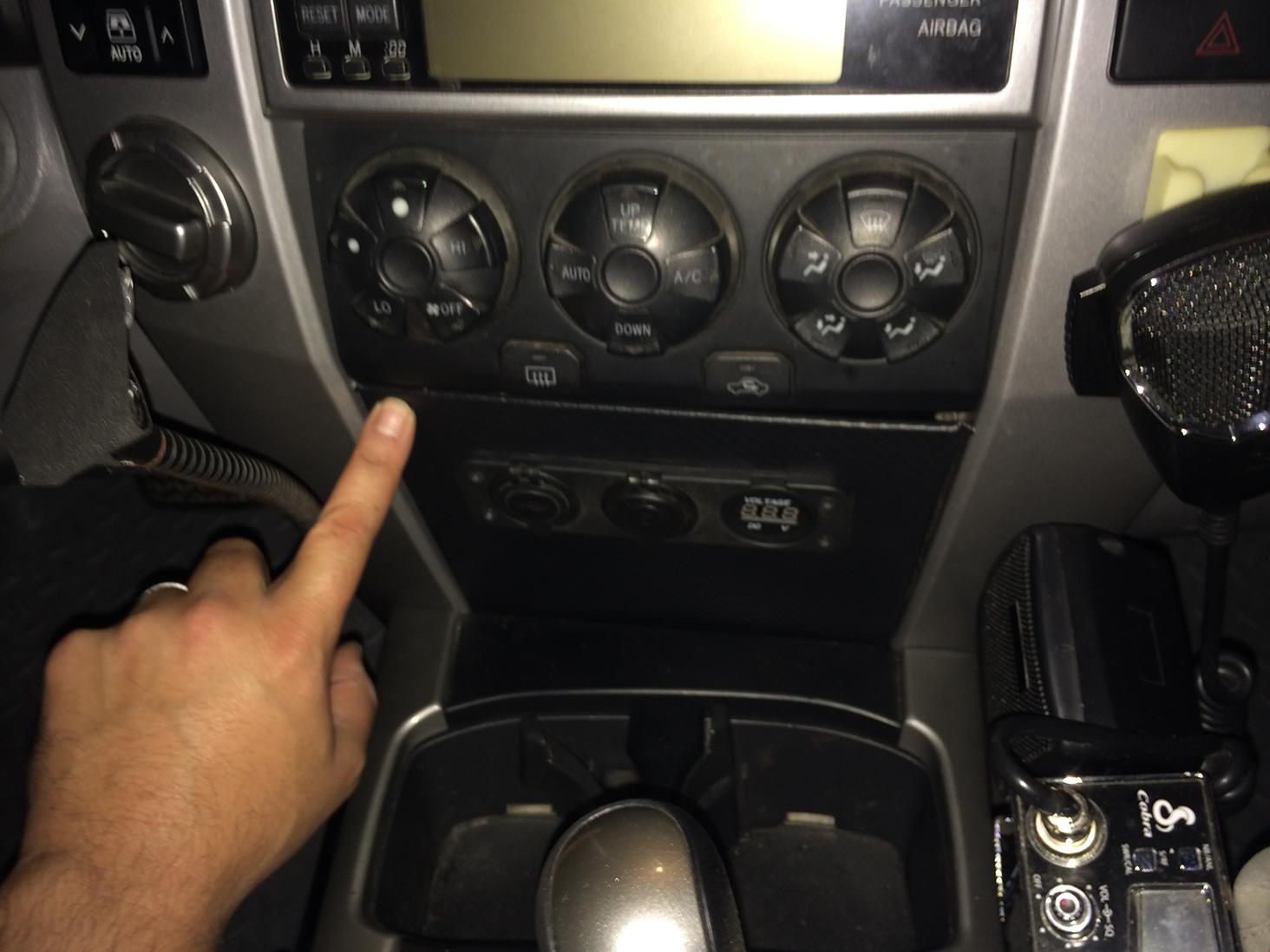

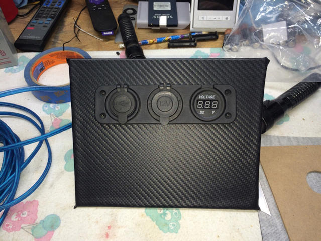

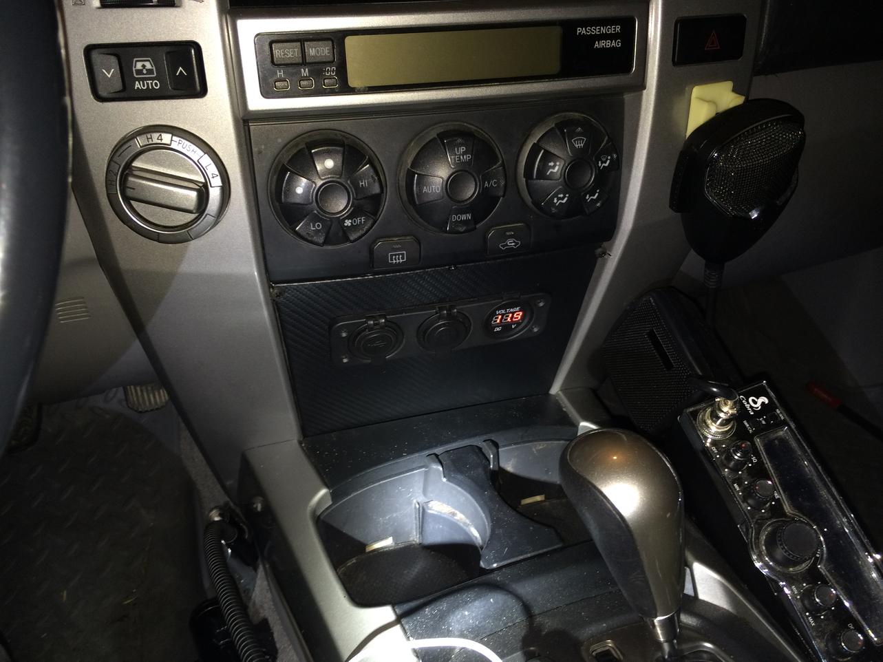

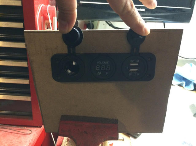

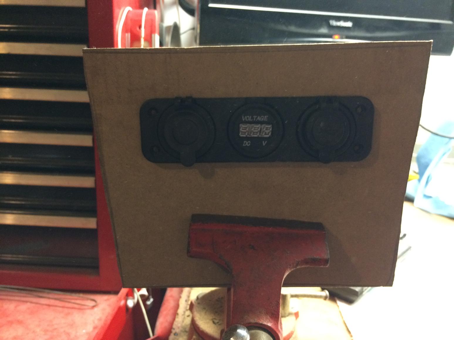

Here is the custom console panel I've been working on. Its made out of 1/8th thick wood I got out of packaging material from a Golden Ear Triton speaker box. I'm lucky enough to work around some top notch custom car audio guys. So I was able to score the carbon fiber vinyl fabric to wrap the wood in. The electrical panel was a score from amazon. This whole thing started out as just needing a volt meter for my two batteries. But it was only a few extra bucks to get this entire assembly that came with the usb and socket. I still want a second voltmeter for the main battery. I'm not sure how that's going to go down yet.

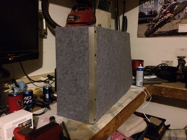

Custom built box for back driver side wheel hump.

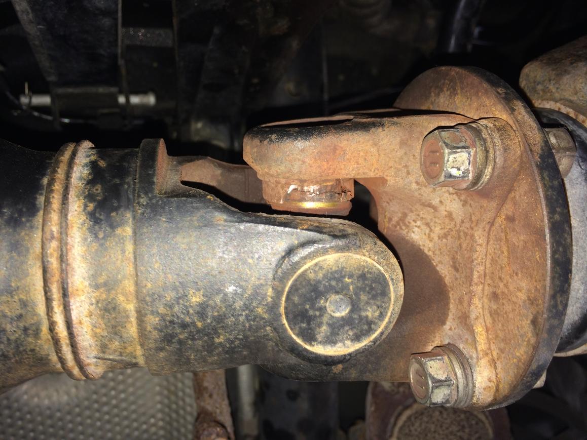

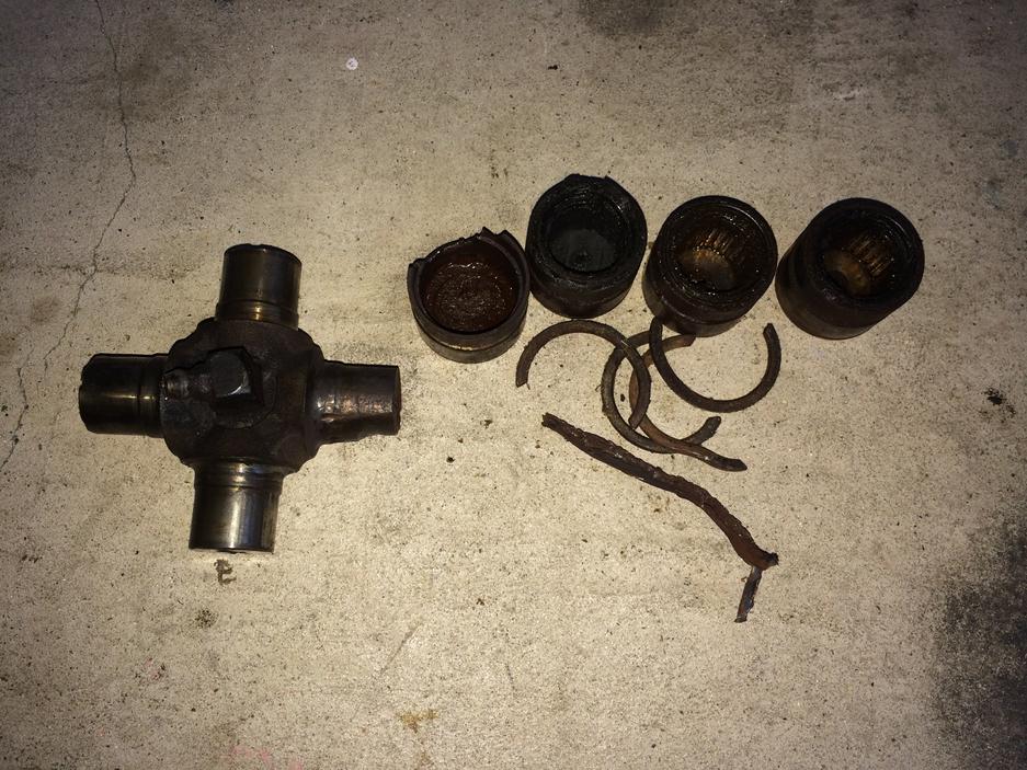

Old u-joint causing shacking at 60mph. It was replaced with a Moog from AutoZone. I also discovered the convenience of an electric 1/2drive impact gun.:bravo:

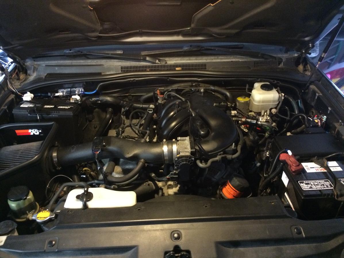

My battery was starting to get a little iffy, so I figured id use the opportunity to do a dual battery setup. I plan on replacing the old battery with a real deep cycle. But for now, it works ok. I have a manual switch to tell it when to charge. I didn't want the old battery to pull down the new battery. So I only flip the switch when the old battery starts to lose a little steam. Its only running my power panel and cb. Neither see a whole lot of action so its a slow drain.
