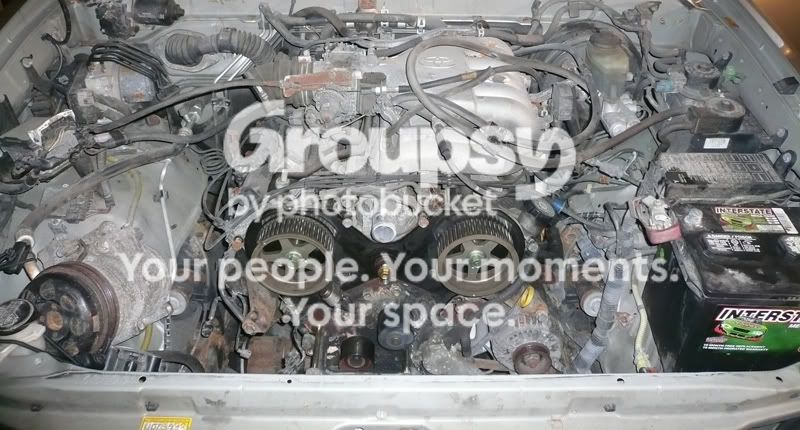

Went to do the "bump-the-starter" method earlier today and the battery died the second I turned the key.. I guess that's what you get when you have a ****ty battery that doesn't get charge because the engine doesn't run lol.
Anyways so until I charge up the battery this is how the engine sits:

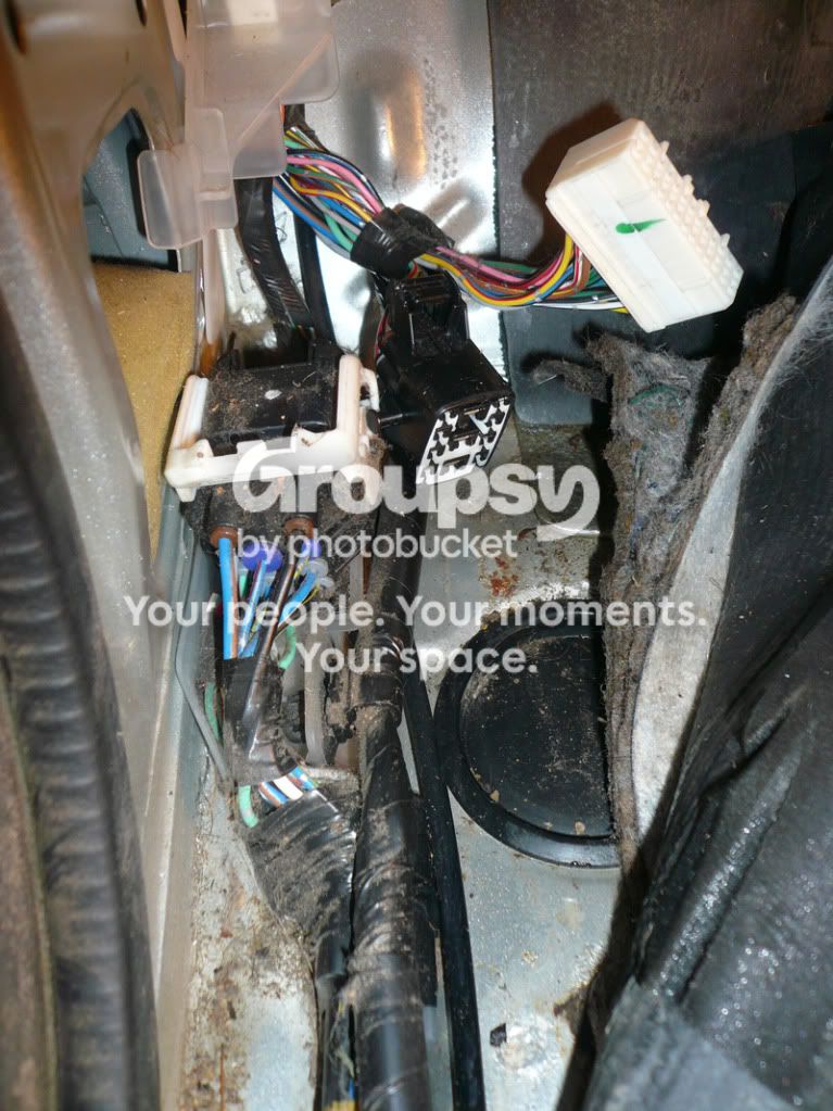

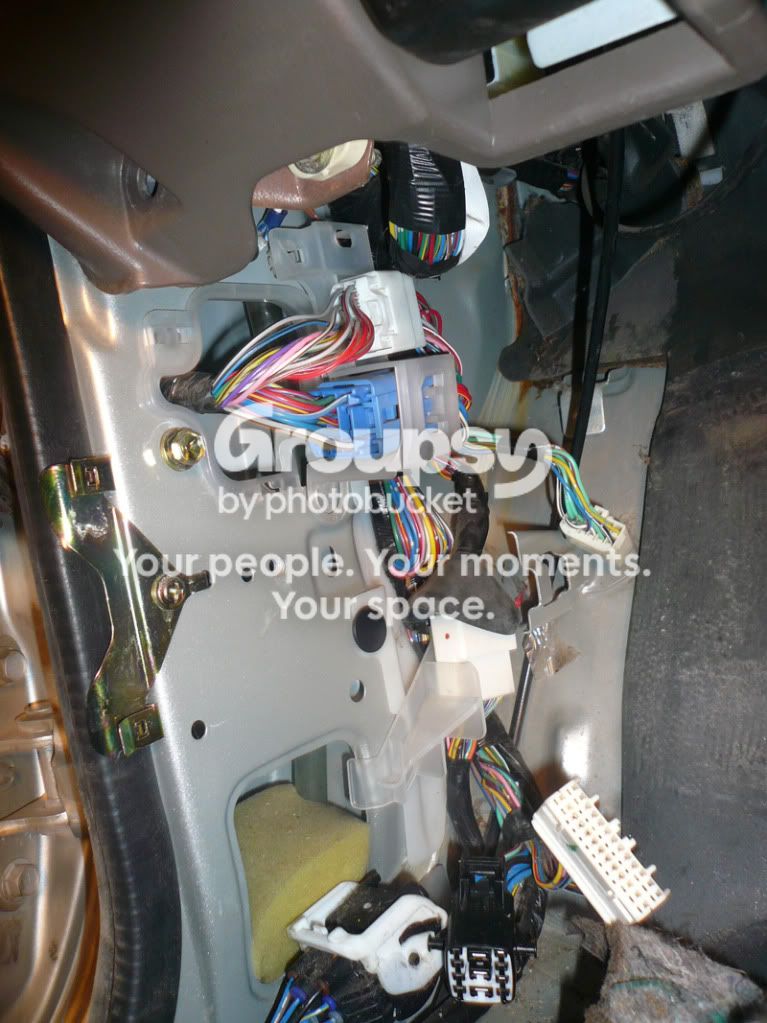

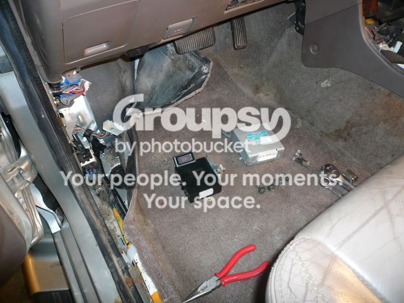

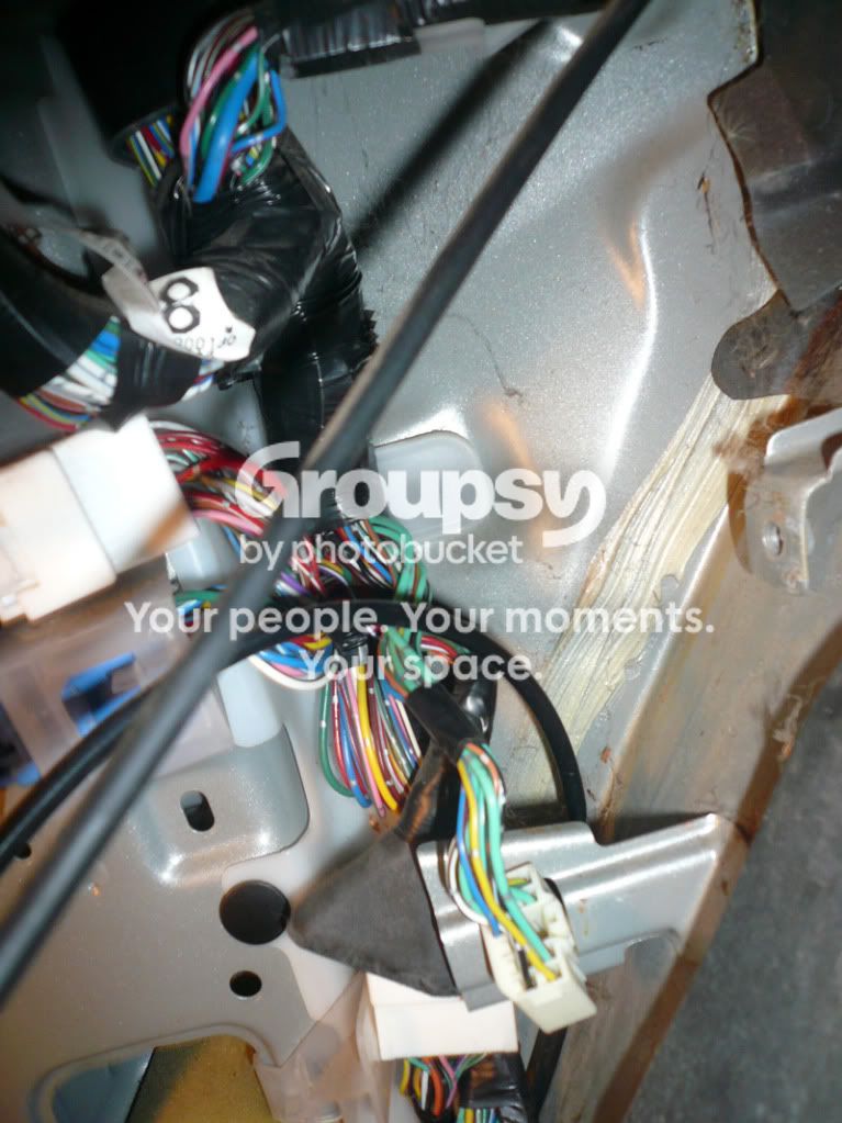

After running into this problem I decided to start pulling panels and getting at the e-locker wiring. From what I can see it looks like it is going to be a bit more difficult than I was expecting because so much of the wiring is intermingled with all the other wiring, especially near the ECU.

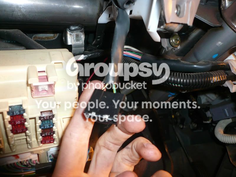

Also, I am having trouble figuring out where the wiring for the button goes because it seems to just go up past the cross bar and I can't follow it.
P1010947.jpg~original

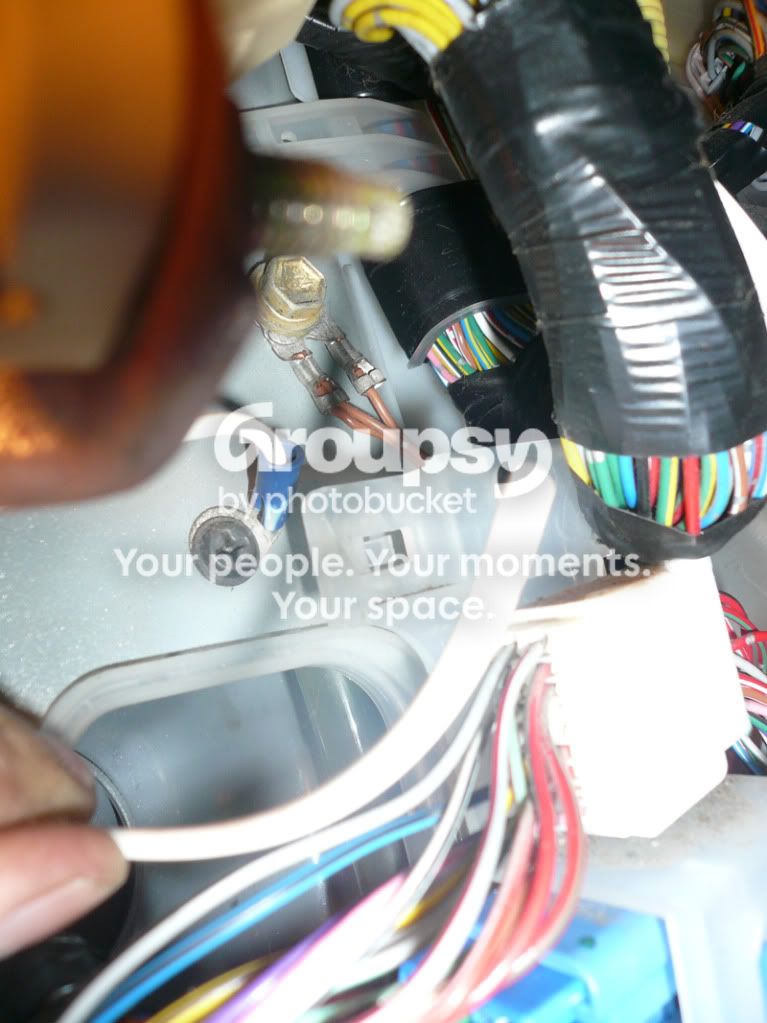

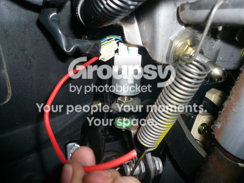

I am also frustrated by the fact that I found two different wires that are attached to nothing.
This one seems to be a ground wire for something:
P1010949.jpg~original
and this one is attached to what looks to be part of the steering column:
P1010948.jpg~original
I'll probably just check out my '98 and see where those should be and figure out exactly what is needed in the wiring harness swap.

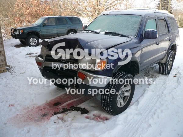

So we got our first decent snow this weekend here in Michigan...

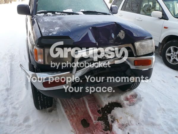

Brother decided to have some fun and relieve some stress by taking his '96 down a short trail with a turnaround...
Went to turn around and do a little donut in this turn around, front wheels didn't grab and he slid into a tree dead center of his front end...
Pushed in all the way to the radiator, cross mounts are all bent...
So for now I'm going to put my projects on hold and work on getting his fixed up and going again. Hopefully nothing worse than replacing some stuff (bumper, hood, grille, etc.) and bending those cross mounts back into place (adding some support as well).

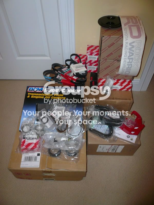

So the new parts have been piling up lately and will probably continue to pile up for a while because I have made a change in plans.
P1010965.jpg~original
I have pretty much decided that I will sell the 2000, possibly with the e-locker, and hopefully get the '90 out of here and then with that money(and some extra) I will find another 3rd gen with low miles. I want an upgrade!
I will have a few specifications to meet when I make the purchase. It must have low miles(less than 150k), an E-locker, have been well maintained, and have tan interior(if it has leather I will be swapping with the clothe seats in my '98, I hate leather). Some other things that would be nice if i can find it all in one package would be if it had a sport hood and was the same color of my '98.
When I get it and swap the things I want to swap from my '98 I will sell the '98:sobbing: So for now I am going to keep most of those parts piled up waiting to be installed on whatever new 3rd gen I get.
I may even look for one out of state (down south or out west) so I can start over with one that has little-no rust. If you guys down in Florida or over In CA find one that meets my requirements let me know :D

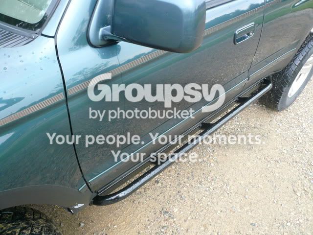

In the past few months I have changed timing belt, water pump, and all other belts. I also swapped my PS pump for one with only 90k miles on it. No more whining from it. My budbuilts skids(front and belly) are bedlined and ready to install.

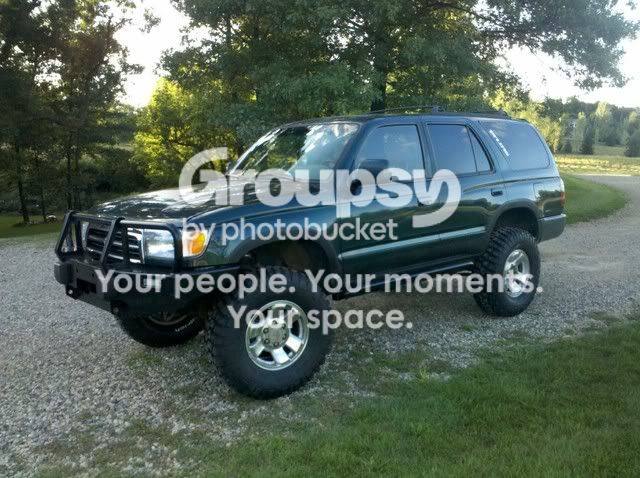

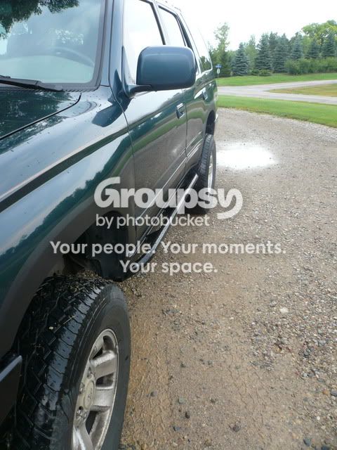

I painted my sliders a few weeks ago but finally had time to get them mounted up.

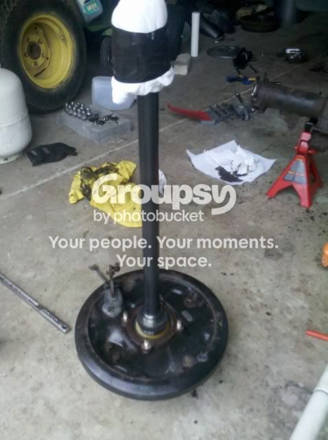

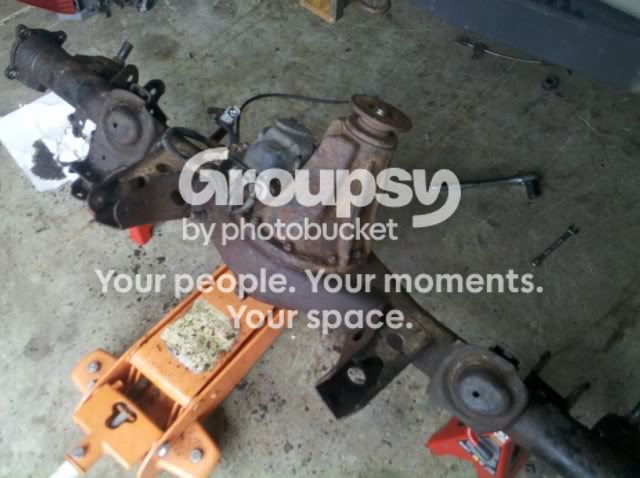

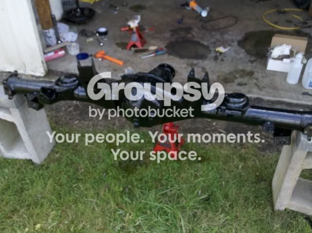

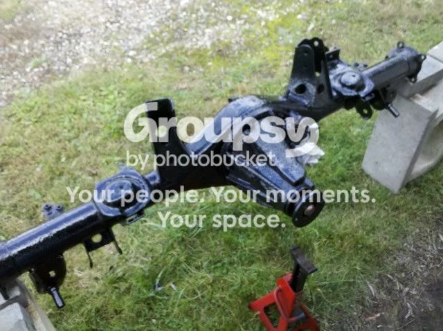

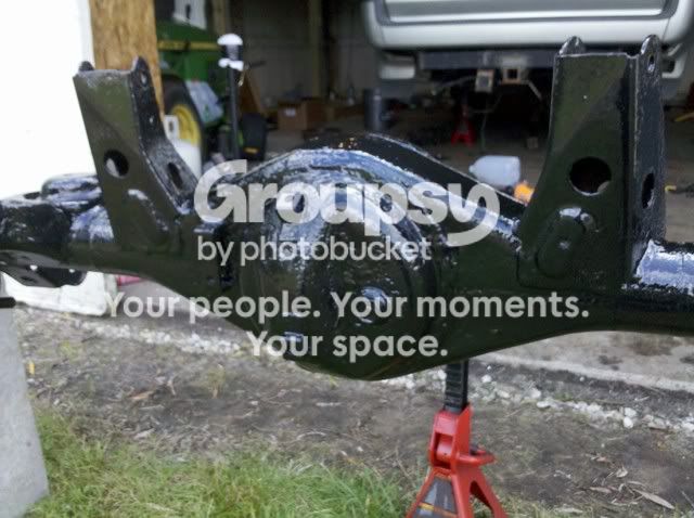

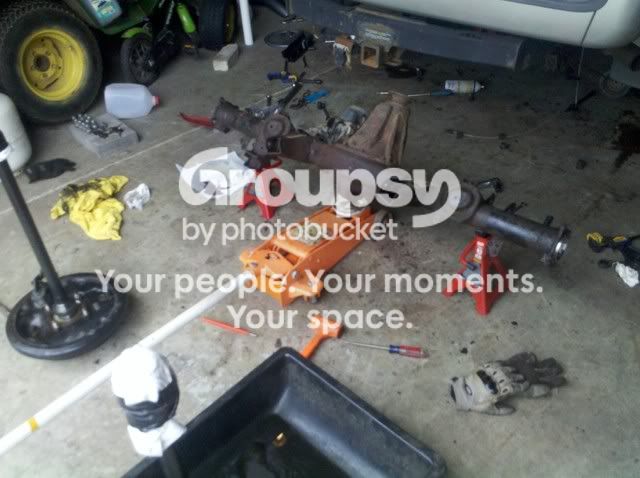

Progress on the axle swap has been made! I'll let the pictures do the talking.
IMG_20110916_124920.jpg~original
IMG_20110916_124944.jpg~original
IMG_20110916_124929.jpg~original
Marine clean/prep and ready/POR-15

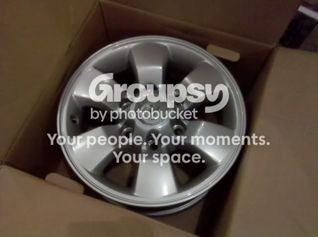

Also got a new set of wheels. Just need to throw some duratracs on them.
Should be taking the shafts in to have all my new hardware put on them pretty soon. Once that's done I'll be pulling the '98s rear out and bolting the e-locker up with new shoes and drums as well. Then all that will be left is swapping front diffs and getting the locker wired up. Since I have the ECU and switch(actually have 3 of them..) I'll just be running wires between them.
IMG_20110922_195817.jpg~original
Should be taking the axle shafts in to have all new barrings and such put on tomorrow. Already have all the new parts just need to take them in. Will be installing new shoes and drums when I get the shafts back. Then hopefully if I can get enough work done this weekend I'll be able to swap it into my '98 as well as the front diff.
