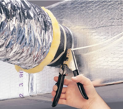

So I've come up with an idea. HVAC zip ties tightened with a tie gun. Has anyone used this for the upper or lower boots? If so how did it hold up?
