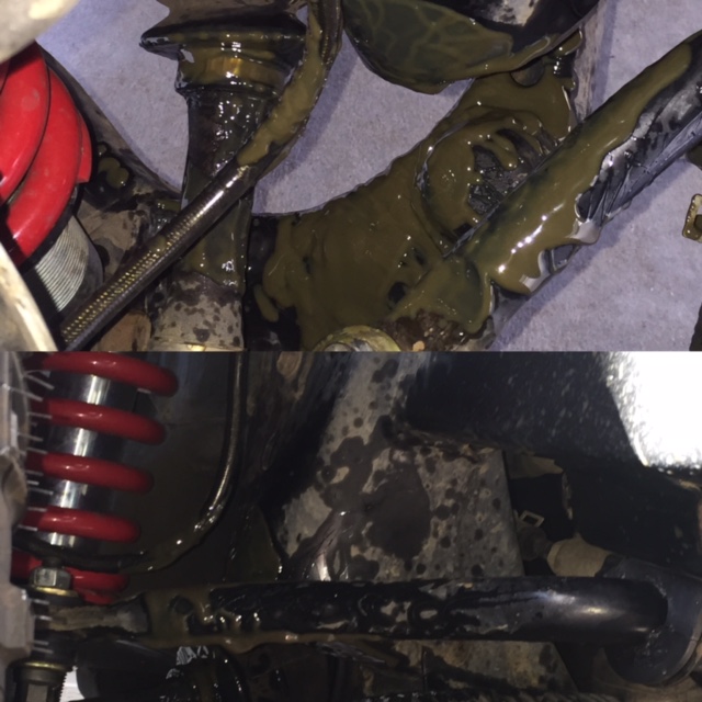

I have about 750 miles on my ToyTec BOSS lift - and noticed grease all over my driver wheel well today.
That's the grease problem. I've read in other threads that there's a way to extend a boot and use a hose clamp to seal it. Other threads have said drive on it till it breaks.
I want reliability / peace of mind / tough parts that wont break.
You have grease everywhere because your boots are torn, so it's too late to try to extend them. You can sure try this with new boots, though they do come with new clamps so you wouldn't need to use worm drive clamps.
