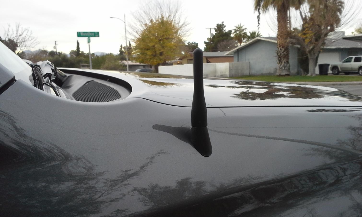

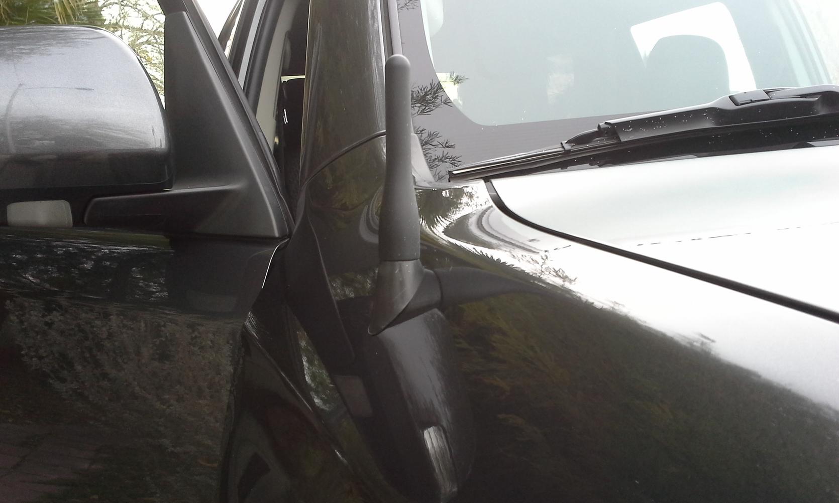

Could not get it out ! Looked at going thru the liner looked even harder so re-threaded it & put the stubby in . Didn't lose any fm/am w/o so it just was weird without antenna there . :first: :gossip: Fcn-moron IDK beats a hole . Gonna look for something different .
